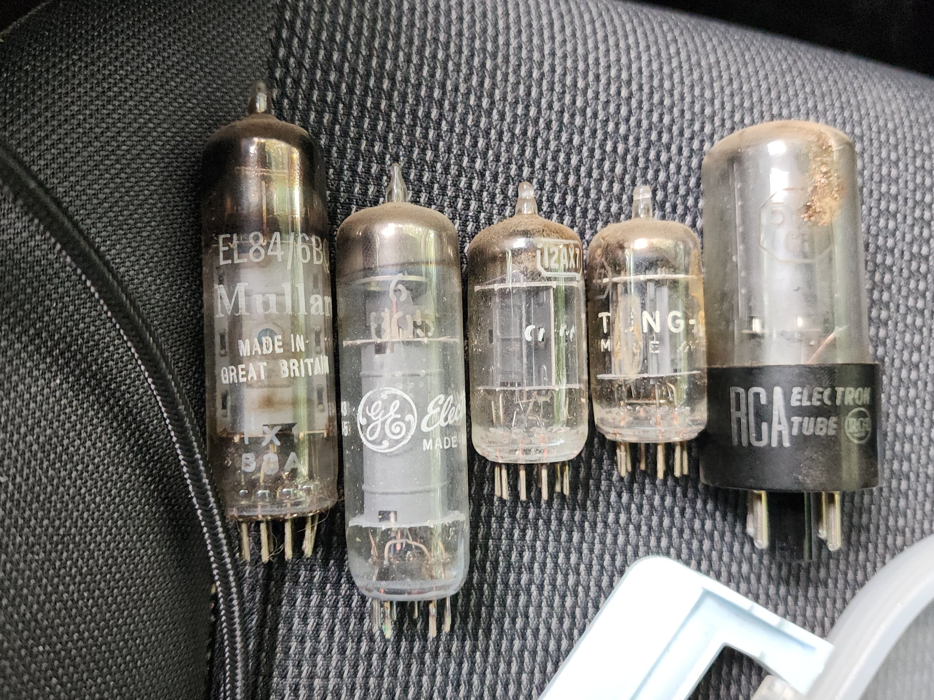

I found these inside of an old sonograph on the side of the road.
What have I found??
What have I found??

Not really concerned about the money aspect, just curious what they are.
Figured I might be able to use some in my existing gear

I'm thinking the mullard and get are el84s
The two smaller ones 12ax7?
And the larger one is a rectifier tube?- Not Tom ::::::: Any system can play Diana Krall. Only the best can play Limp Bizkit. -
Probably a 5y3gt rectifier tube. -

Hard to tell in the pic. I see an EL84 which today is used as a power tube, back then who knows
The GE is a 6BQ5 same as the EL84
12AX7 no writing, hard to tell. Maybe as Ivan said a Tungsol
The other Tungsol looks smaller compared to the signal tube next to it. Need more info, but a signal tube
The RCA is most likely a 6V6 because it's gray glass. Could be a rectifier as Ivan noted, but I think a 6V6 which today is a power tube used in many, many guitar amps from the 50's forward.

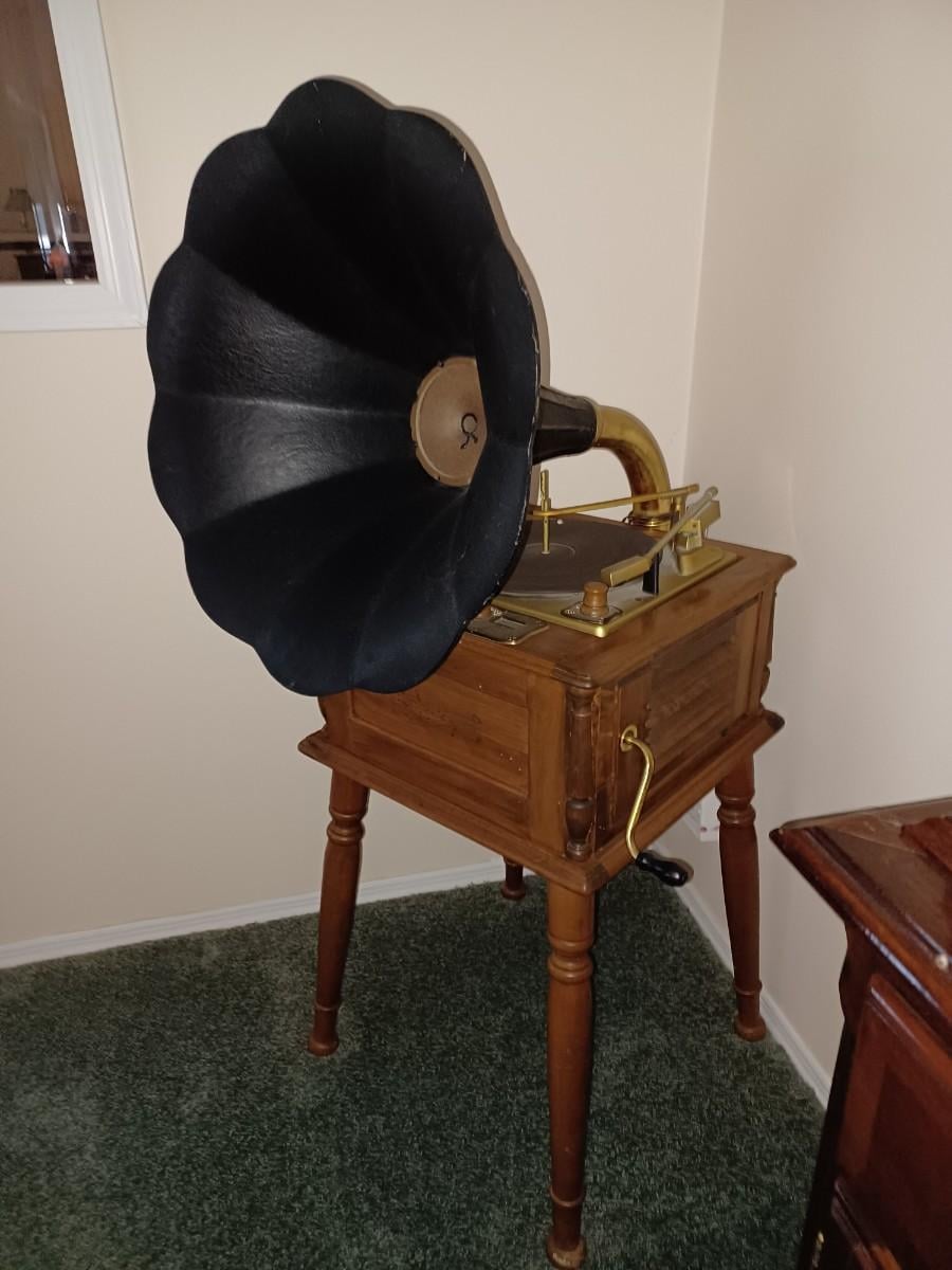

That thing is not in stereo, I won't guess how the tubes were used since today the same tubes might be used differently
But it appears you have (3) power tubes and (2) signal tubes.
Any idea the year of the phonograph? Is it real of a reproduction?
Is that all of the tubes? I don't see a rectifier tube. The EL84/6BQ5 can't be used as a rectifier and if the RCA is a 6V6 tube (pretty sure it is), it can't either.

Need to see the internal structure or the markings on the RCA to know if it's a 6V6 or rectifier like 5Y3. I can see markings obscured by dust. What does it say?
RCA did make 5Y3 rectifiers with gray glass (smoked glass). Since I don't see any other obvious choice it could be a 5Y3 rectifier. Not a 6V6

I can just make out a "5" in the stop sign on the RCA. It is indeed a 5Y3 rectifier.

That phonograph was not powered hence the crank on the side. They were probably bad tubes that someone threw in there for S&G's
I think the crank's a ruse. Note also the speaker driver in the horn.
ahem. Also note the "modern"
multi-speed, automatic record changer. -
It's a Guild Grafanola. Built in the late '50's- early '60's & designed to look like an old Victorola player.
PP mono with a pair of 6BQ5s. One 12AX7 as the AF amp & phase splitter for the output pair.
5Y3 rectifier.
The radio section used a 6BE6 for the first stage converter & a 6BA6 as the IF amp. The other 12AX7 was the pre-amp & AF amp with the tone controls between it's sections.
I've got a schematic if you need it. -
@tonyp063 you are quite right, the rectifier tube is a 5y3, there is no way that can be mistaken for a 6v6 as it has 4 pins, two larger pins and two smaller pins.

I think the RCA on the right is a 5Y4 GT full wave rectifier. If you zoom in, you can see the 5 (Dirt mark) and GT under that...Enjoying the journey while never attaining the destination.
It's a 5Y3GT
