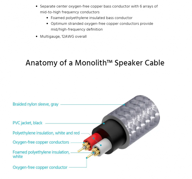

    I was going to recommend the wire I used last time I built a set of cables, but it seems like Monoprice discontinued the wire.
    It was a pretty good deal at $39 for a 25' spool. Now they just sell terminated versions and they are advertising them as 14AWG and not 12AWG like the stuff I bought.
    https://www.amazon.com/Monolith-Multi-Strand-Conductors-Speaker-Wire/dp/B07Q8WDF1K?
    At this point, I think the Canare 4S11 (or 4S11G) is a better recommendation, especially if you want un-terminated. In fact, I may just buy a length and do another set since I have exactly 8 Audioquest silver coated copper spades left from a bulk purchase about 18 years ago.
