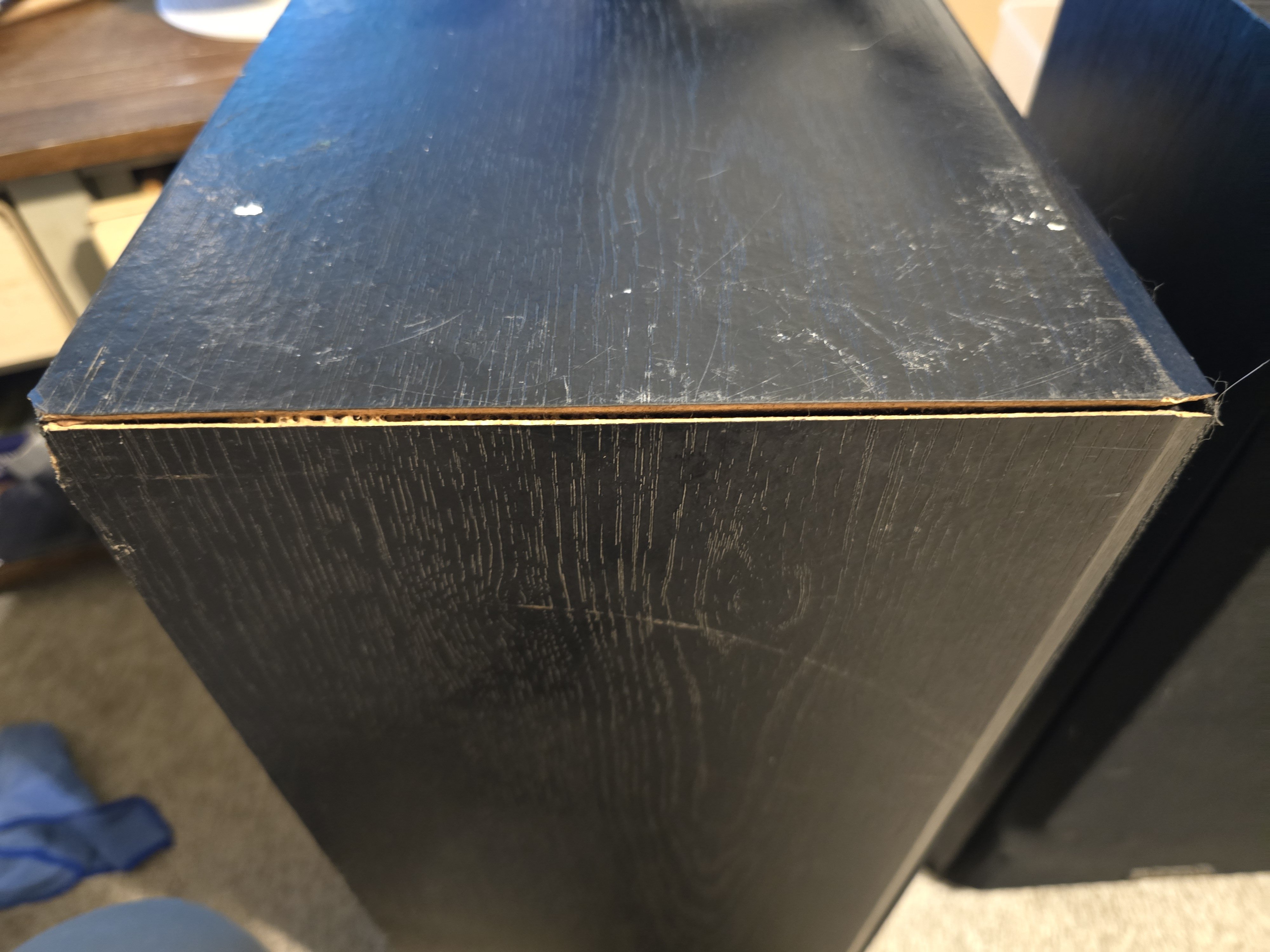

Any ideas on how to fix this? Just picked up a pair of Polk Monitor 7s and didn't catch this until I got home with them.

    I'd use Liquid Nails Pro. Let it set up a few days, then wood putty and sand back the corners. The vinyl wrap is toast.

    Fill in the gap or use clamps to close the gap then putty?
    These definitely will need some love but the price was cheap. They will get redone and TL modded.

    Shoot the goo from inside, ensuring it protrudes all the way through to outside. Then clamp and dry 36 hrs. While you're in there do all the inner corners with a bead.
    I'd highly suggest adding a 1"dowel or two front to back between MW and PR.

    This... before glueing anything, you need to understand why the entire seam opened up. It needs to be thoroughly cleaned up to get the surfaces to mate properly and then it can be glued. If the material has any water damage, it might be easier to make new cabinets to the same internal volume out of MDF.

    That cabinet might be salvageable at a low cost.
    I've seen a lot of those swollen cabinets in my time. Water damage. :s
    BUT, you can make it look better in a sense.

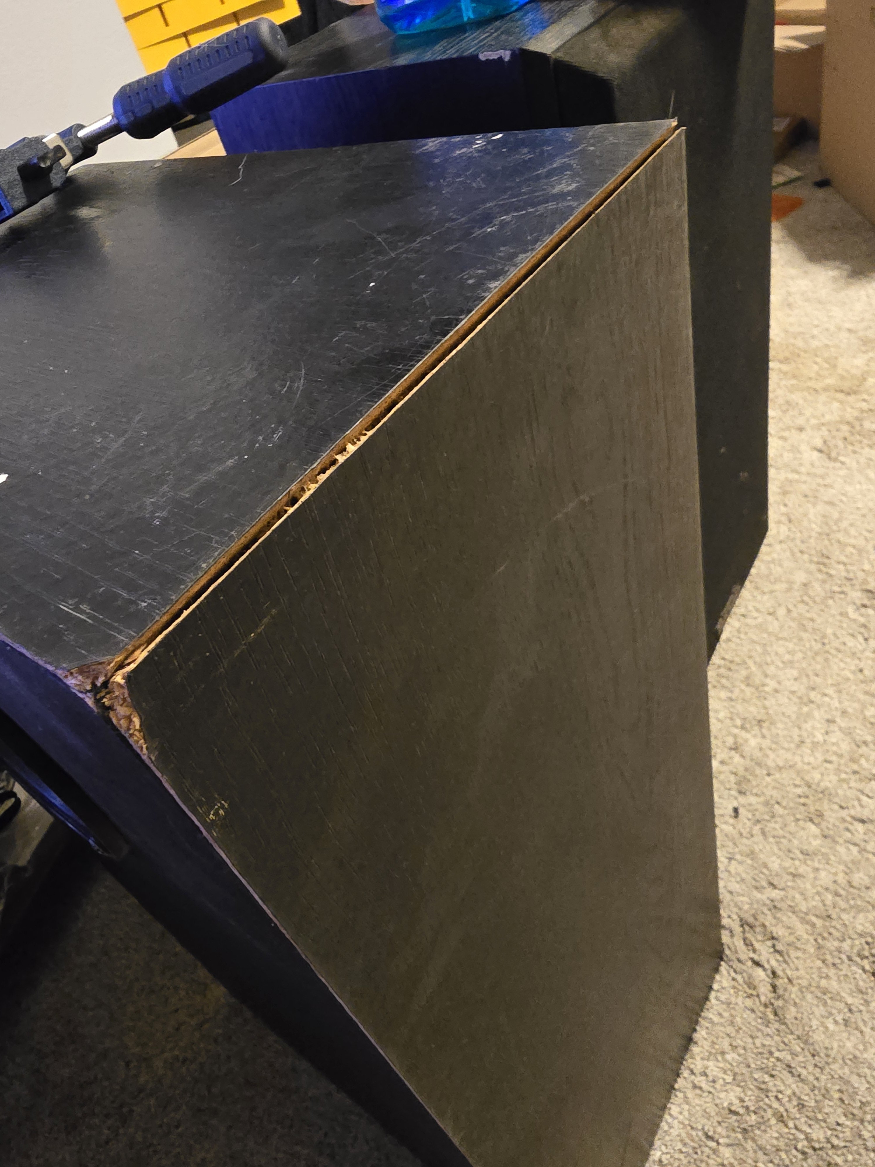

    I've tried clamping and as its already been pointed out the gap did not close. It doesn't look swollen from moisture but its not budging.
    Can I take a heat gun and dismantle the cabinet? Im wondering if I can jusy replace the bottom panel.

    I would empty the cabinet completely, then use a Ryoba (japanese saw w/o spine) or some sort of flush cut saw to cut through the entire length of the joint.
    You should then be able to either clamp it back together w/o gaps, or insert a shim the entire length of the gap to completely seal the cabinet.

    The cabinet is particleboard. When that material breaks it basically turns into jagged/crumbled pieces.
    You can try the suggested saw idea, but don't use a good Japanese saw as the material will likely break some teeth off.
