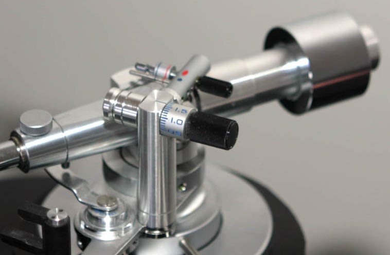

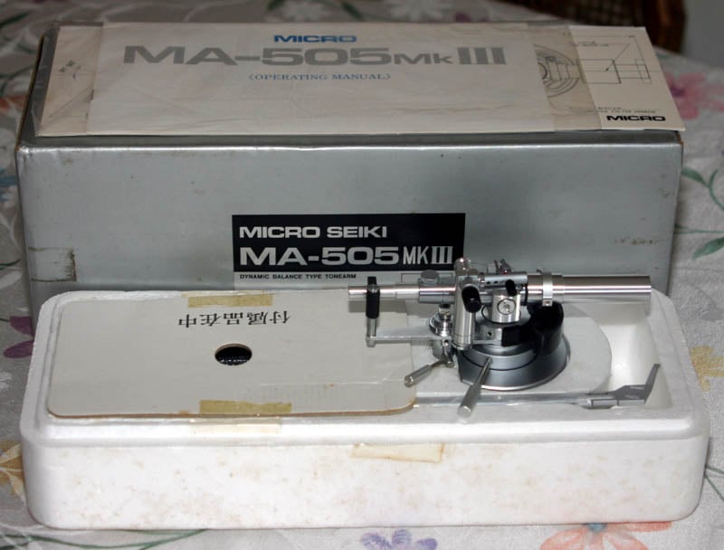

    I've seen folks with a Micro Seiki MA505 MKII on the TD-150. That was a great arm. I had one on a dual arm Nottingham Space Deck. I had both straight and curved arms for it. Another arm that qualified for the wish I never sold that...

    Yes, I’ve made several arm boards, including for the arm currently on the Thorens. Thanks for the advice on the Micro Seiki and also reiterating tonearm weight concerns. Don

    For folks that like to run multiple cartridges, while the MA505 straight arms did not have a removable headshell, the arms were easily swapped via thumb screw. The straight pipes had fixed headshell while the curved arms had removable headshells.

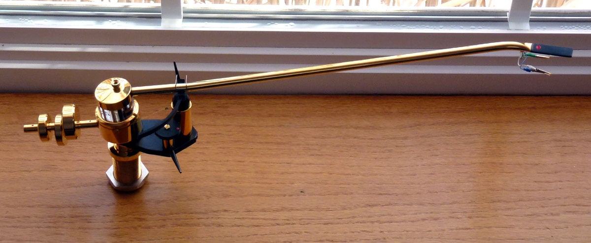

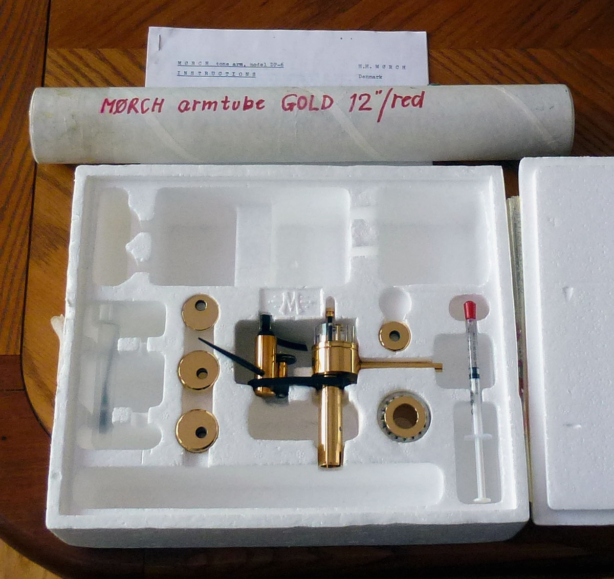

    I had another arm that was held on by thumbscrew, a Moerch DP6 (Dual Pivot). Moerch offered both 9" and 12" arms for it. They also had four choices of effective mass arms identified by a color dot to easily match cartridge compliance. The DP6 isn't a real heavy arm. It's a fantastic performing arm but I think pricing keeps it off a suggested arm list.
    My patented on the fly VTA adjuster for the DP6. :D
    Duh, I had a MKIII.
