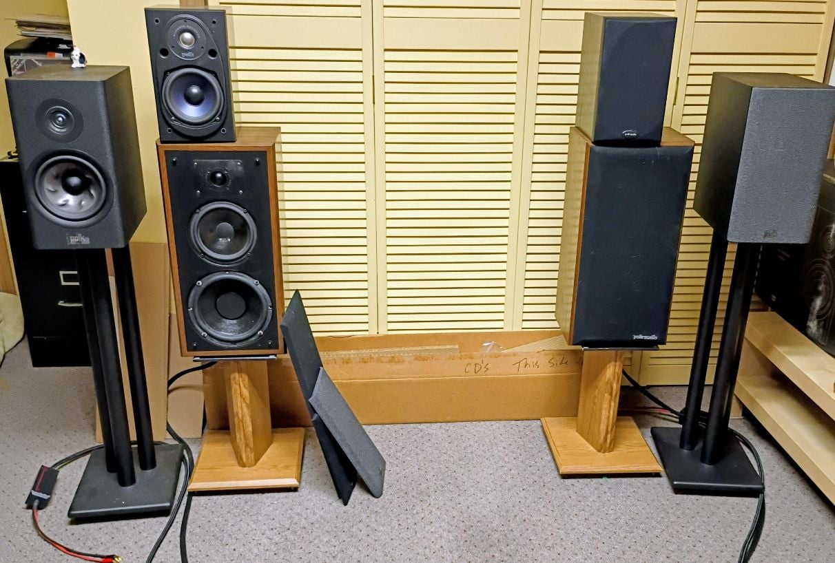

Forgot how good these can sound. Mine have had the full refurb (except the gluing of the magnets and basket dynamat)
An older refurb with Solens on the low end and Clarity caps on the high end, RD0 tweets. Larrys rings and Mortite
Vocals really soar on these. Bass is a bit shy until you get some volume. They seem just a bit more sensitive than the R200's.
Running a 10wpc Pass DIY ACA amp and Pass DIY Korg Nutube B1 pre. Listening to some vintage Christmas music.
It's early, but I think the vocals are a bit better on the 5B's. But they could just be calling more attention because of the lack of lower mid bass and bass at my level of listening.
Why have these been in storage so long? Vocal presence and clarity is superb.

    Now that you hauled them out, you have to do the Dynamat and magnet gluing. When I did the Dynamat I definitely heard more natural conga drums, for example.

    I switched back to the R200's and while the 5B's had great vocal presence. So did the R200's and everything else the R200's was better in spades. The 5B's are kind of shouty compared to the R200's. There is no contest between the Vifa tweet and RD0. The Vifa is worlds smoother, more open and more natural sounding and less strident.
    Everytime I re-listen to the 5B's I come back to one conclusion. They have no bass or rather don't have the bass punch I remember from owning my 1st pair in the 90's. I should take them apart and see if there is an issue.

    You have a few unmitigated issues with those 5B's. If those are 194 RDO's then the plastic bezel is a detriment. Dynamat is a must for the baskets and the foam frame mod rids the "shouty-ness".
    The bass extension is pretty good for their size cabinets and they are great in smaller rooms, but the 7's fixed that issue with their bass extension and output compared to 5Bs.

    I'll take your comments into consideration. But I'm talking about how they used to sound after the upgrades vs. now. They sound off comparing oranges to oranges.

    Maybe check and make sure the polyfill didn't slide down to around the passive radiator instead of up behind the midwoofer and tweeter. Sometimes when the VC starts to rub occasionally it can affect the bass only too.
