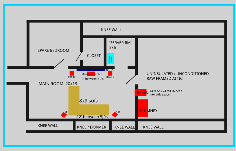

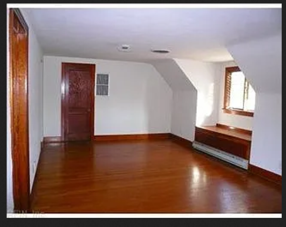

The house is a 1950s expanded Cape. The right wall of the listening room backs onto an unfinished, uninsulated attic. There’s an old 14" × 25" A/C return cutout in that wall (bottom of the opening is 50" off the floor, top at 75"). Seems like the perfect spot for an infinite baffle sub!
IB Sub Plan
(2) Dayton Audio UMII18-22 Ultimax II 18" drivers
Small sealed enclosure ~10" × 24" × 24" built from ¾" MDO plywood, mounted between the studs
Cover with a grille to match the room
Powered by a Behringer NX3000D (with DSP)
Basically turning that giant unused return into a huge manifold straight into the attic — should have basically unlimited airspace back there.
Any thoughts, gotchas, or “you’re gonna hate this” warnings before I start cutting and ordering drivers?

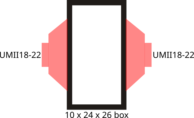

    I'm planning a Dual-Opposed Manifold - force cancelling... to supposedly handle the vibration, and using the Ultimax II because I want the slightly stiffer suspension for transient response. Love the feedback here! Partially inspired by "Eric's Home Theater"

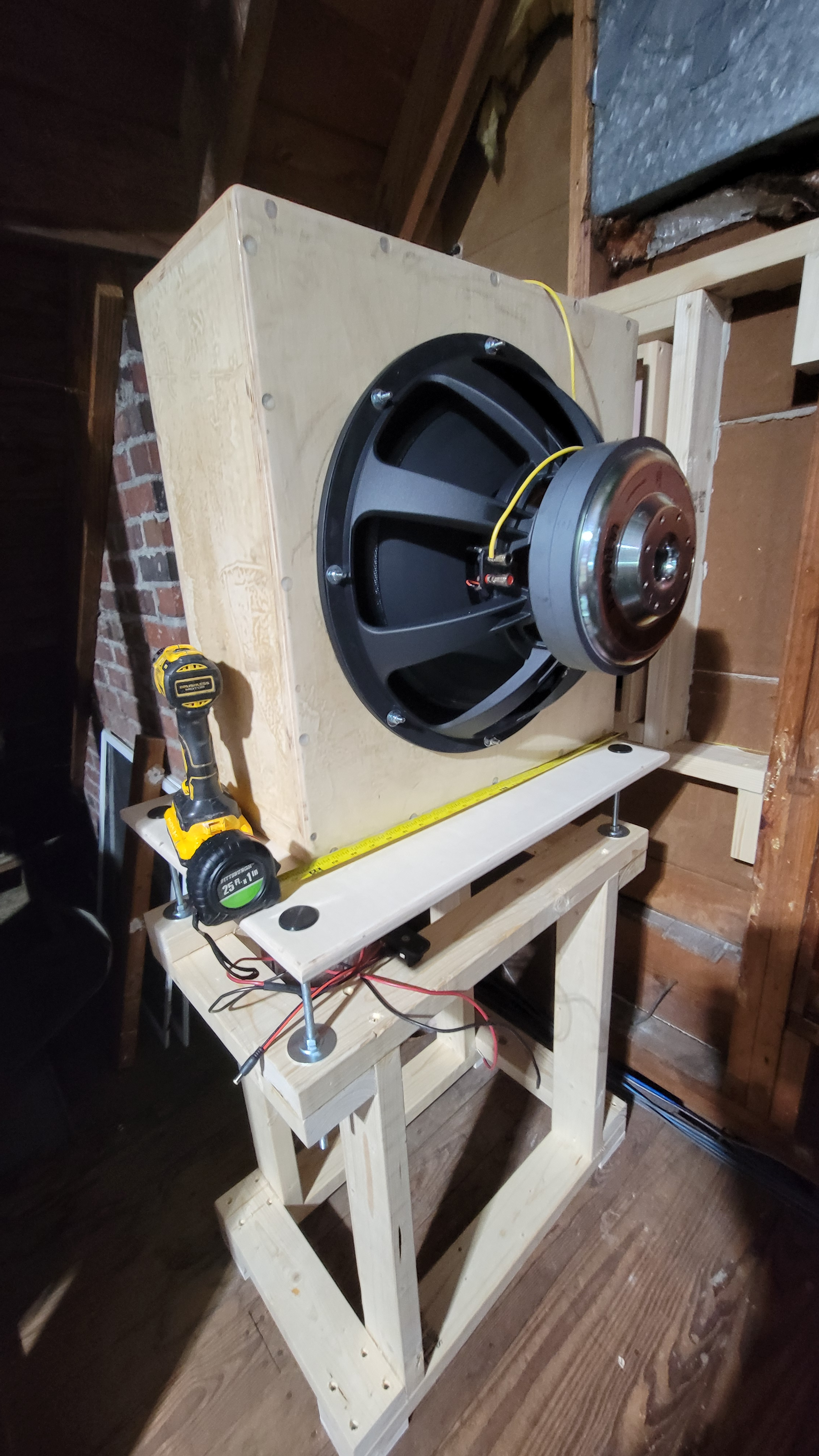

    Still some work todo, but it is progressing...
    It wouldn't fit in the old AC return grille hole because the roof interfered with the drivers... durr... It's in a more manageable spot now.
    Some box finishing to do, wiring, make an EPDM rubber boot to connect to the port in the wall, etc. Should be operational Jan 4th.
