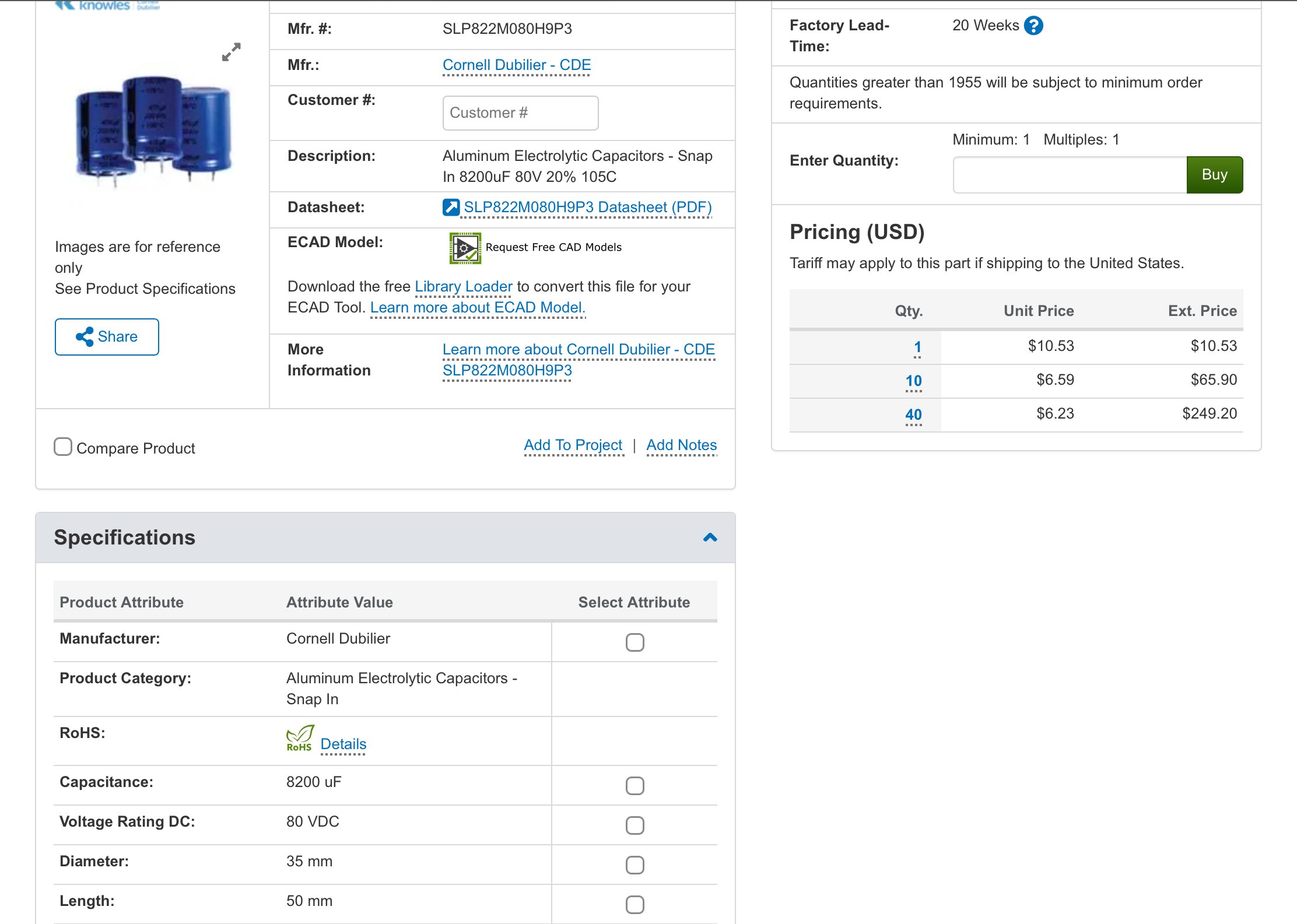

    If I were to attempt a recap on the RF amp, I’d create a bank of 5 of these per large cap for 41,000uf. I’d have to measure, but it looks like there’s room. Cost would be $55ish per cap, and they would have a much better ESR…:-)

    I just corrected mine. I've found them with mouser and others but must buy 30 at about $30 each.
    I'm not sure a bank would work on mine as they bolt directly to the board with the board resting on top of the 4 cans. I'm not dismissing your ideas you're more experienced than I am but the way the amp is built you would be redesigning the interior.

    That does get tricky when the mechanical hurdles that are more difficult to overcome than the electrical. Have you checked to see if something with slightly higher voltage or capacitance is available in a size that would fit?

    No I have not. When I was looking a few years ago I was just looking at the value. It wasn't until Trey started the big ML amps that I screen shot that above to see if he ran across something similar in his shopping. Using that DCM number last night actually brought up suppliers that had them, none however sold individuals, just cases of 30 or more. I guess I could use the dimensions of that can to research larger values and temp in that size.

    Let me know the diameter, length and screw terminal spread, in mm and I’ll see what I can find…

    30 or more generally would mean it's being ordered from the manufacture and would have substantial wait times, ymmv

    Correct, states 18 weeks.
