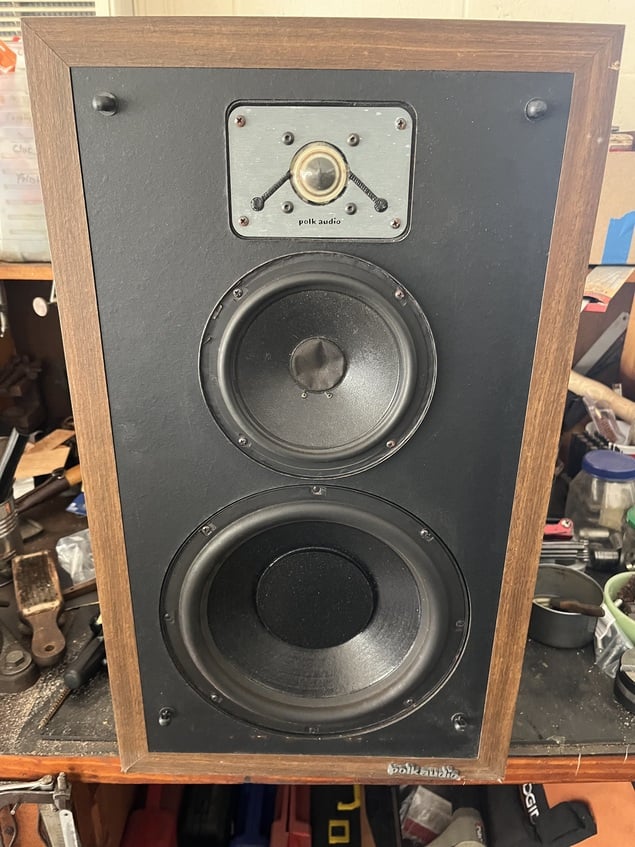

Hi,
Looking for anyone that has done this seems the Cap Values are the same but Resistors and how they are set up is different?
Any ideas on this???

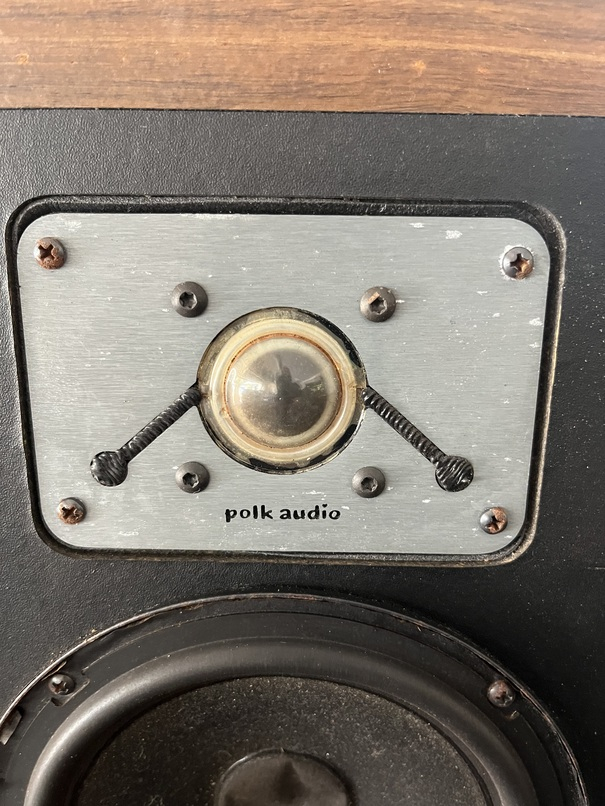

    Hi,

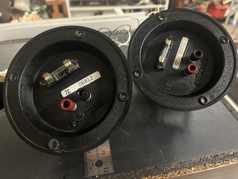

    Thanks, mine is an odd duck for a 7C or early model as it has the fuse holder and straight cut front on Cab... (no front bevel)
    I have been told a Peerless will go right in as the SL1000 was made to replace the Peerless!

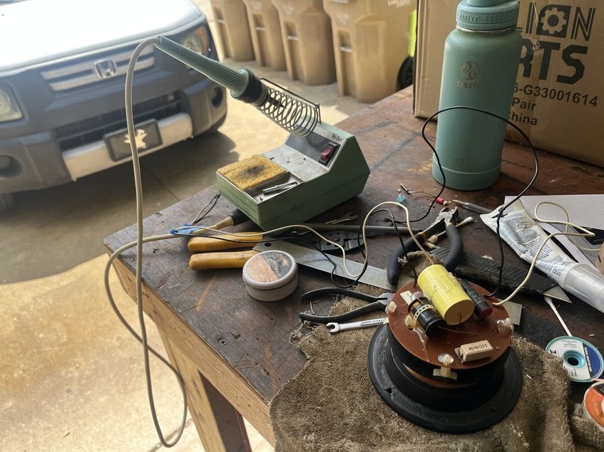

    F1 Nut also said it was a go, and good news.
    I will try the SL1000 after rebuild/ crossover work, just to see how it sounds but will probably put in a clone Peerless at the end of the day!

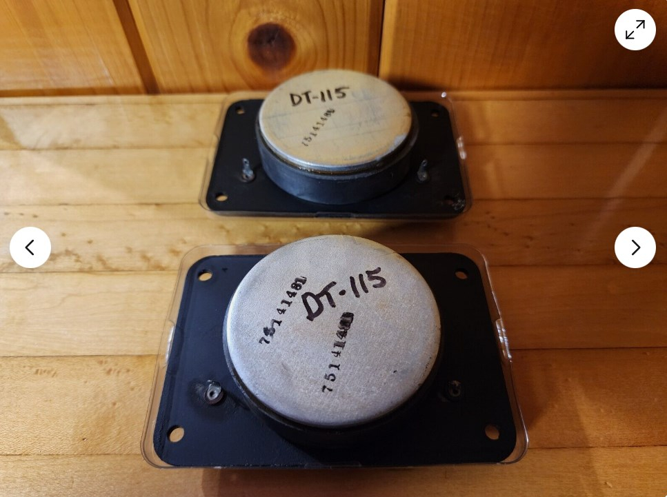

    If I'm going to spend the money I want Danish built...Why not?

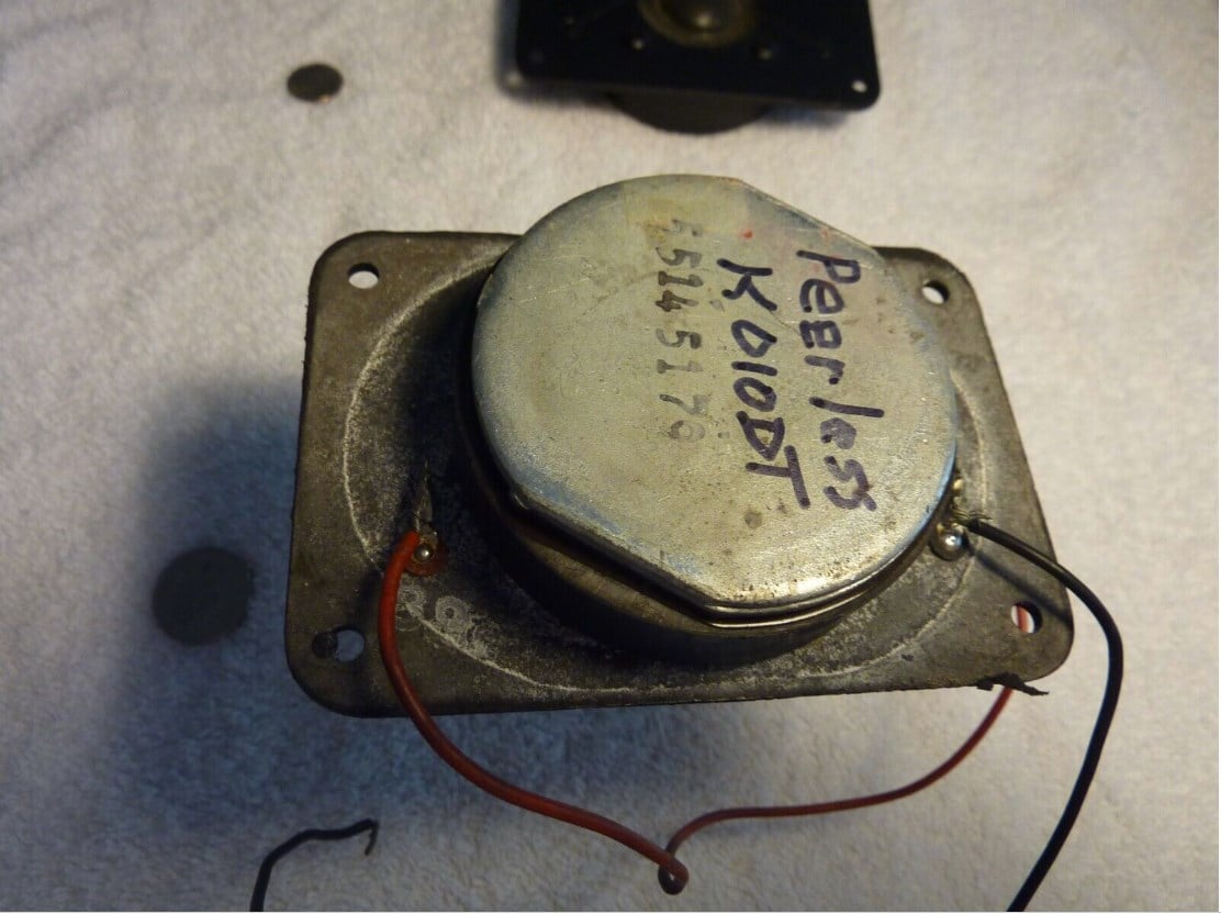

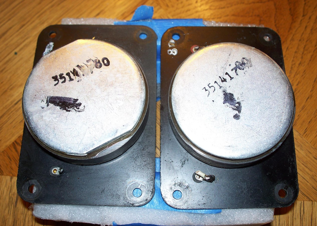

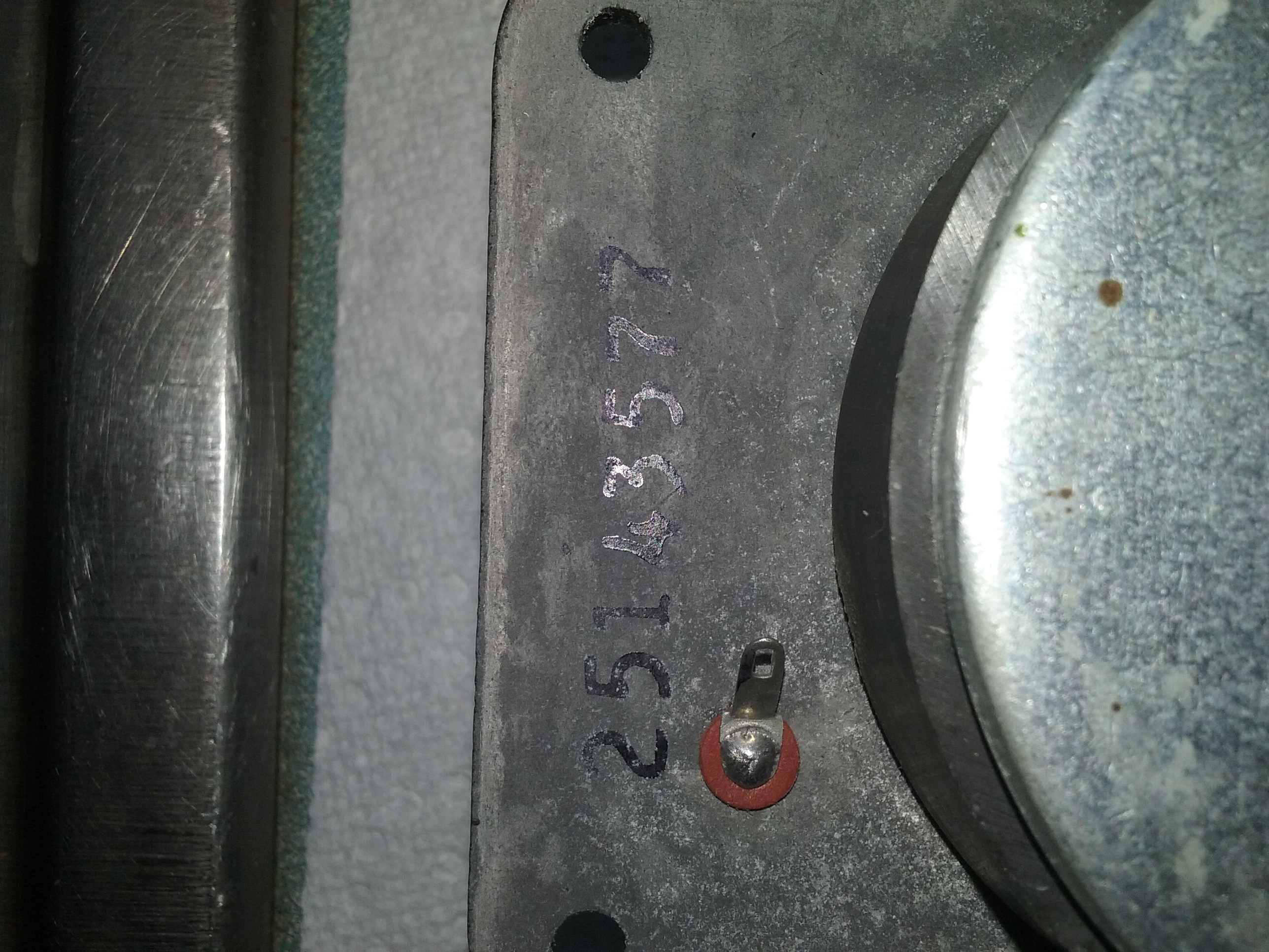

    Danish-made Peerless speakers are often marked with "7514____" on the magnet or plate. The last two numbers indicate the year of manufacture.
    US-made Peerless speakers are typically marked with "5514____".
    pitdogg2 Posts: 27,921
    edited July 2025
    The flats IIRC may mean Danish, it's been a while but I thought the USA were round or vice versa.
    By the way Polk burned holes in the domes, they did not come that way from the factory. Polk used a soldering iron to make a small hole in the dome.

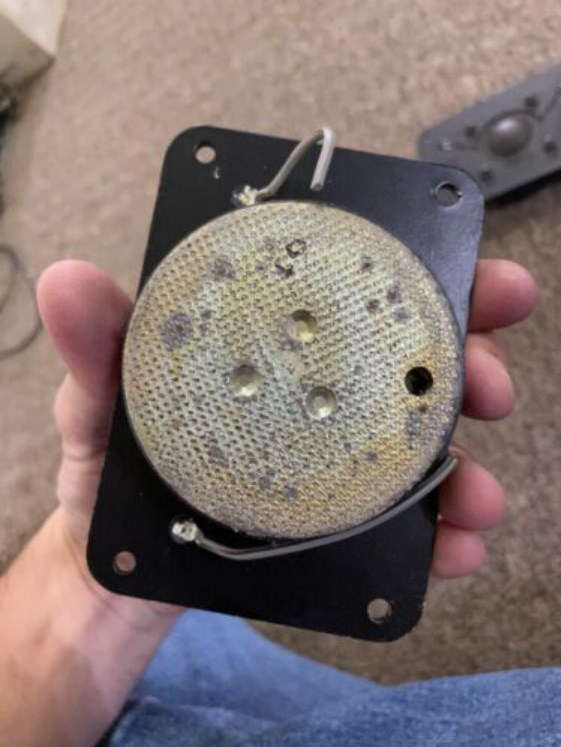

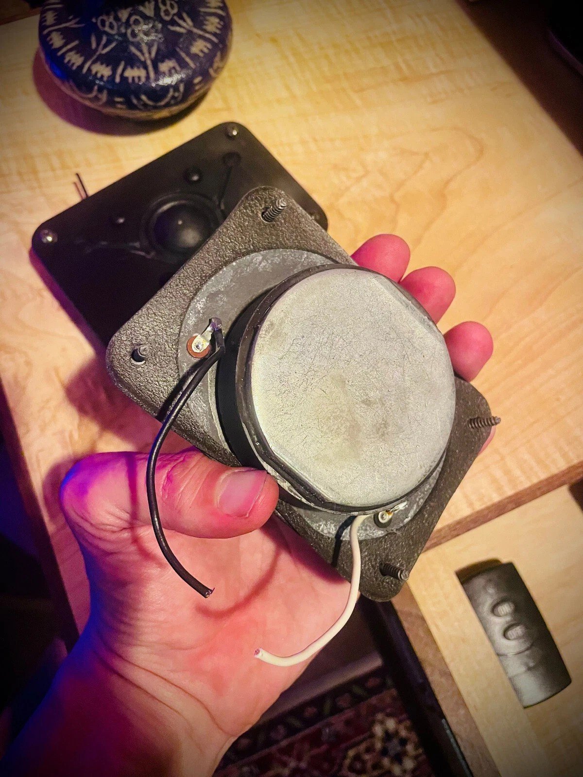

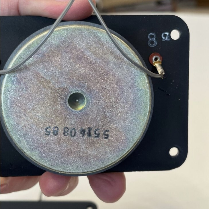

    Here's a US Made 5514...
  • seagiant
    seagiant Posts: 51
    edited July 2025
    Hi,

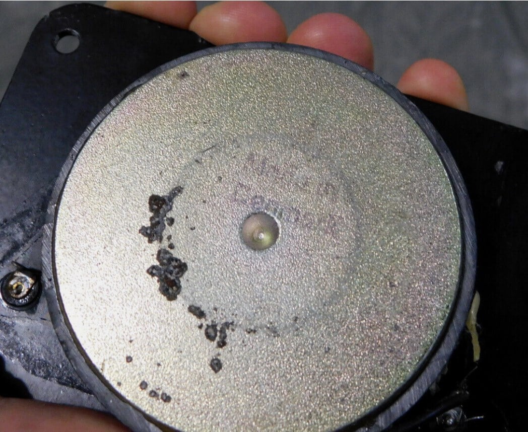

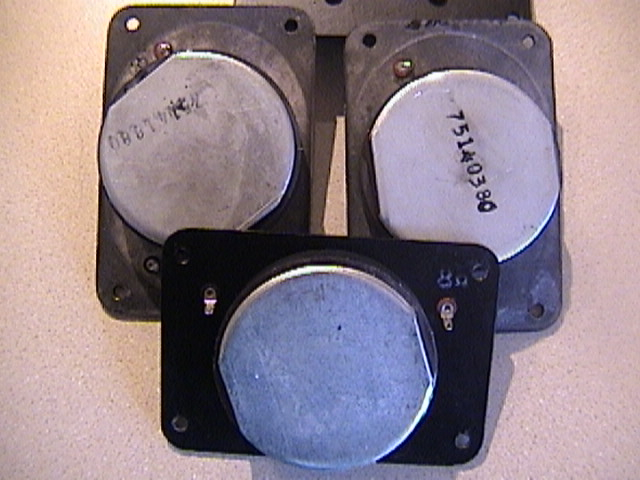

    Danish Peerless...7514...
  • seagiant
    seagiant Posts: 51
    Hi,
    Well, Vintage Peerless pair I'm looking at, look the same as the Danish from the back.
    The US made Peerless and the Clones do not have that same back plate, so I'm going to assume they are Danish made Peerless?
  • seagiant
    seagiant Posts: 51
    Hi,

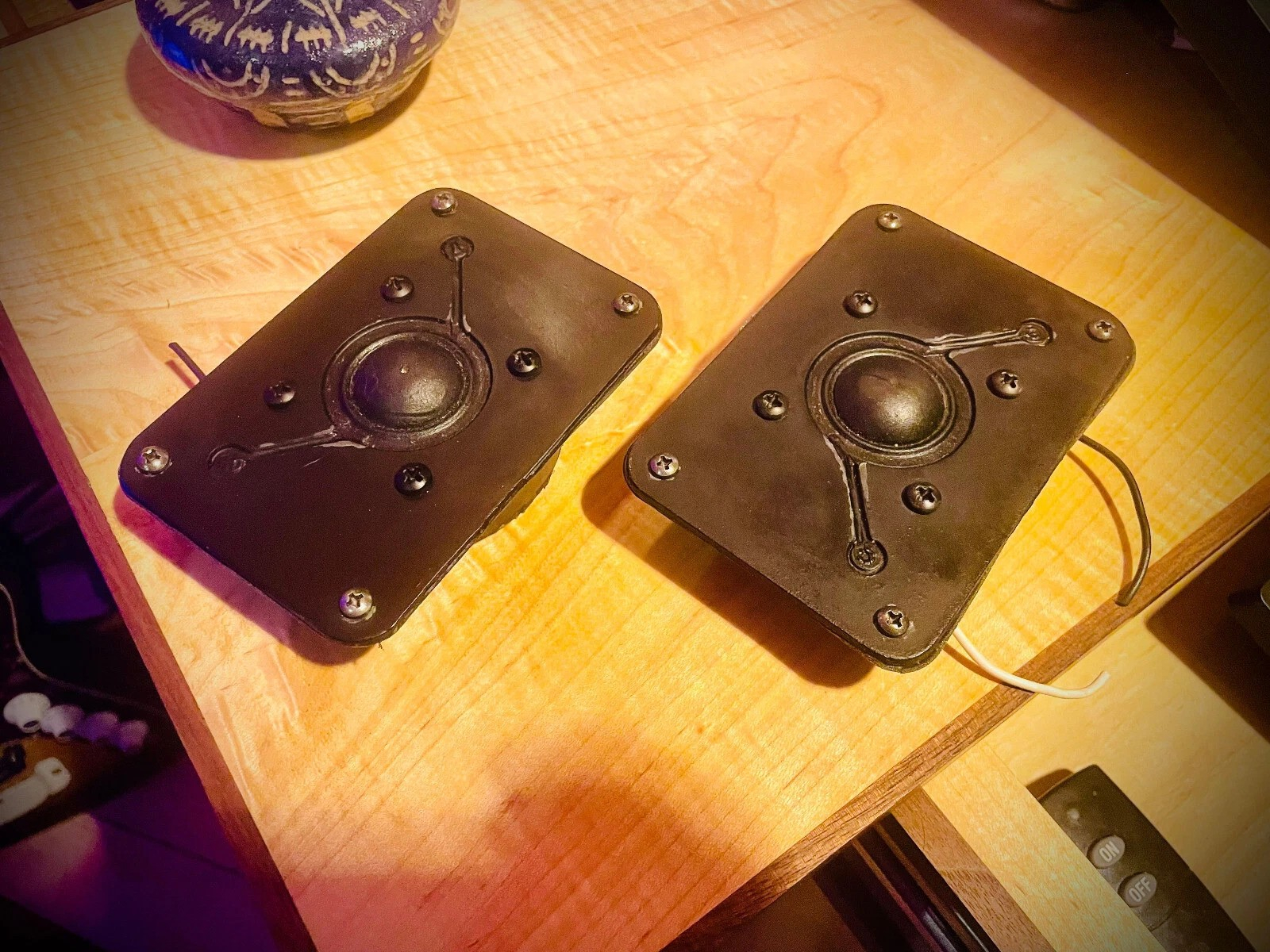

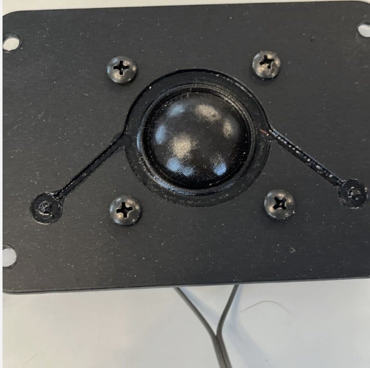

    Here is the pair from the front... Danish???
  • seagiant
    seagiant Posts: 51
    edited July 2025
    Hi,
    Ok, the back plate and the two flats on the magnet mean they are Danish, sent an offer!
    Thanks for the help!!!

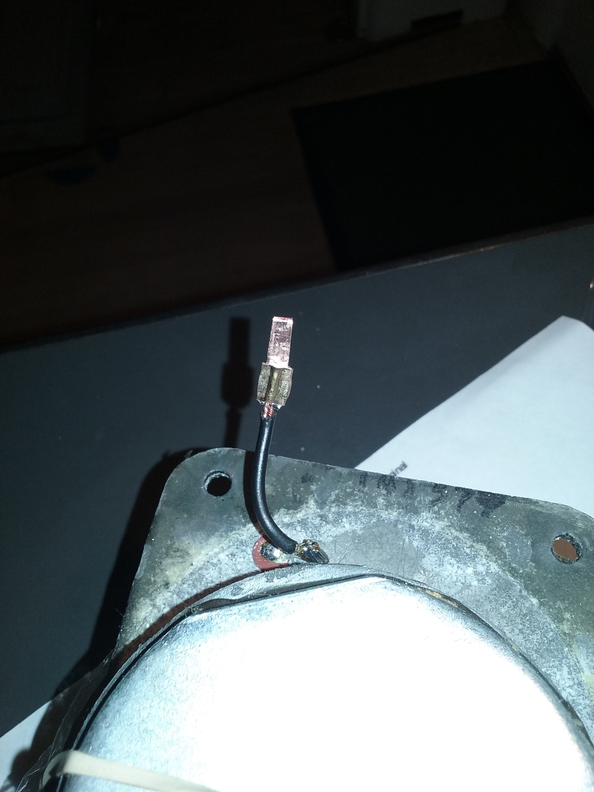

    I wouldn't try and de-solder the leads, just put quick connects on the wires, then solder those if you want after crimping. De-soldering the tabs on the face plate can ruin them fast. many have made that mistake.
  • Gardenstater
    Gardenstater Posts: 4,991
    edited July 2025

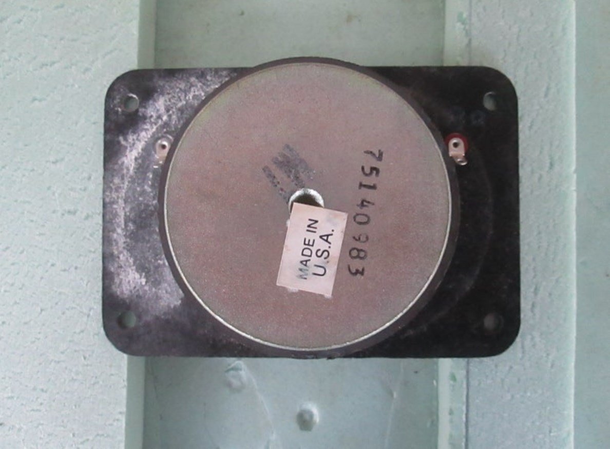

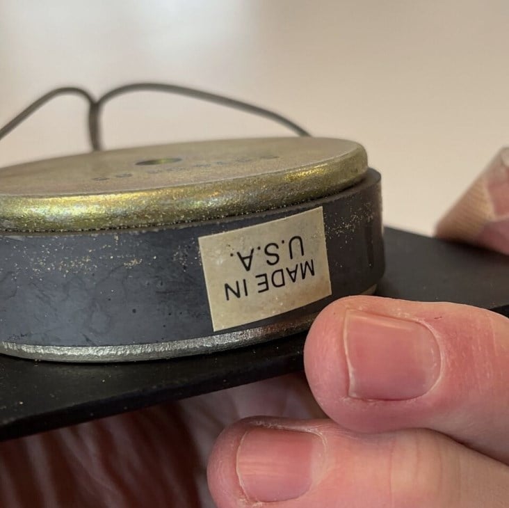

    The only way you know they were made in Denmark is if it says "Made in Denmark". I "believe" that all the ones Polk bought were made in USA and they were making Peerless in the USA from I think 1973 on.
    I have found some on eBay that were 7514XXXX and they had the "Made In USA" sticker on them.
    My 1979 7514s sound better than some 5514s that I have, so maybe it is good you got the 7514s. We don't really know what the first number means though, or at least I don't know of anyone that has explained it. I have seen 1514, 2514, 3514 and those are earlier production ones, but I have seen many 5514 with later production dates than 7514s. There are many different appearances of backplates as well. It's a mess.
    The last four numbers are the date code, with "0380" being 3rd week of 1980. That much is certain.

    Hi,
    Thanks for the info!

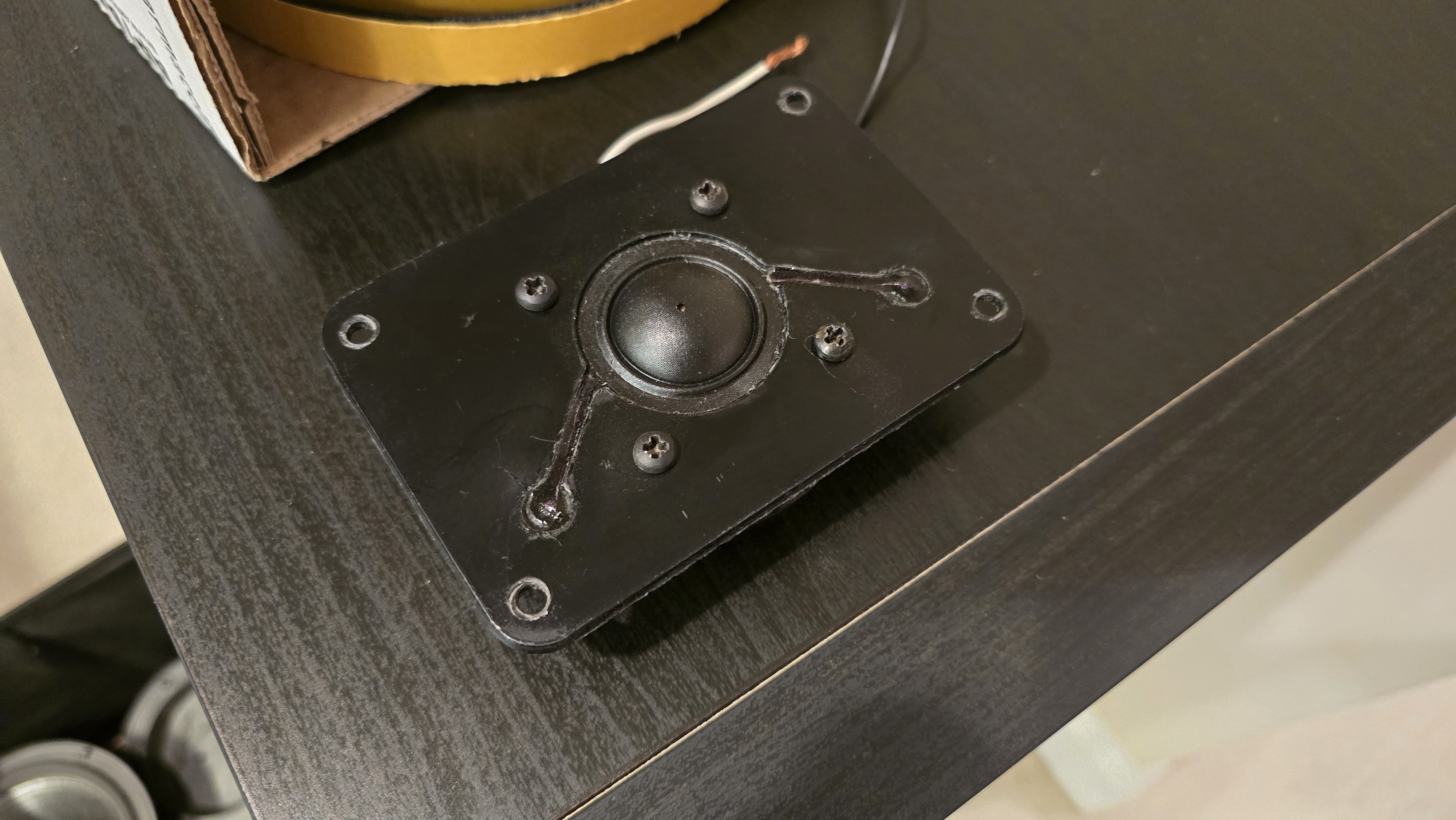

    Here are the Pair I put an offer on and will probably get.
    They have no numbers that I see, but...
    Have the Danish style back plate and the 2 flats on the Magnet...
    That is what I am going on and probably as good as it gets, from info I can dig up!
  • Gardenstater
    edited July 2025
    Those are definitely modified by Polk with the Aperture Tuning Hole in the dome. Those look like my 1979 7514s and in mine you cannot see the numbering because it is on the faceplate underneath the gasket. Like I said though, I would not assume they were made in Denmark.
    George / NJ
    Onkyo A-8017 integrated
    iFi nano iDSD DAC
    iPurifier3
    iDefender w/ iPower PS
  • seagiant
    seagiant Posts: 51
    Hi,
    I'm satisfied they are, from the info I can dig up, and not a lot of "Experts" chiming in here?
    We shall see, but I have yet to see an American made, or Chinese made ,Peerless that has the flats and the back plate indentions, or whatever they are?
    Not much else to go on?

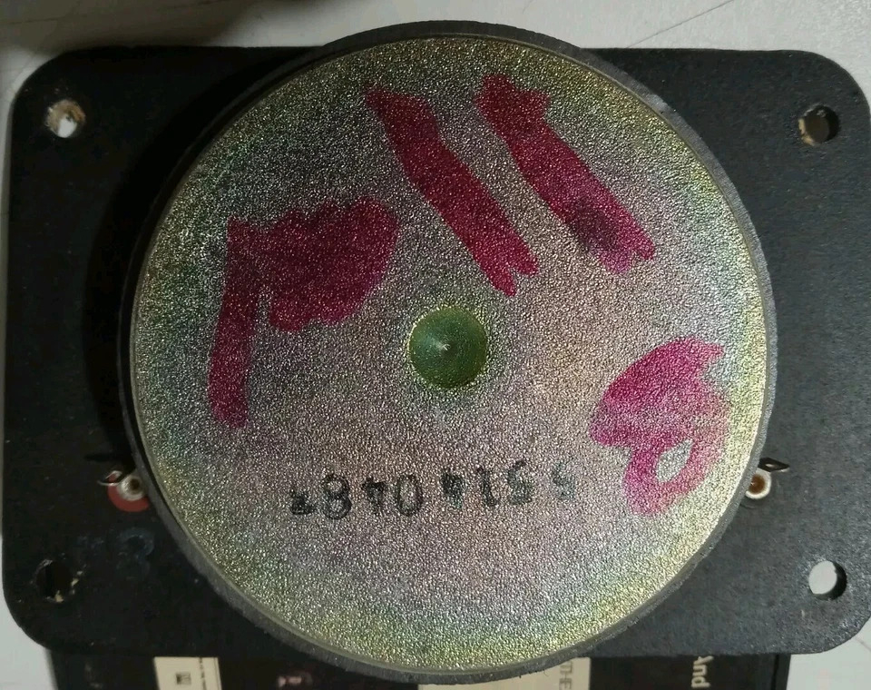

    I have so many pictures that I scrounged from eBay that it is nearly impossible to find them all easily. I know I have pictures of 7514s with "Made In USA" stickers. Does that mean that the ones without the stickers are by default Made in Denmark? I dunno.
    Here's some 7514s that have the smooth silver style back plates but these do not have the flats.
    George / NJ
    iFi nano iDSD DAC
    iPurifier3
  • Gardenstater
    edited July 2025

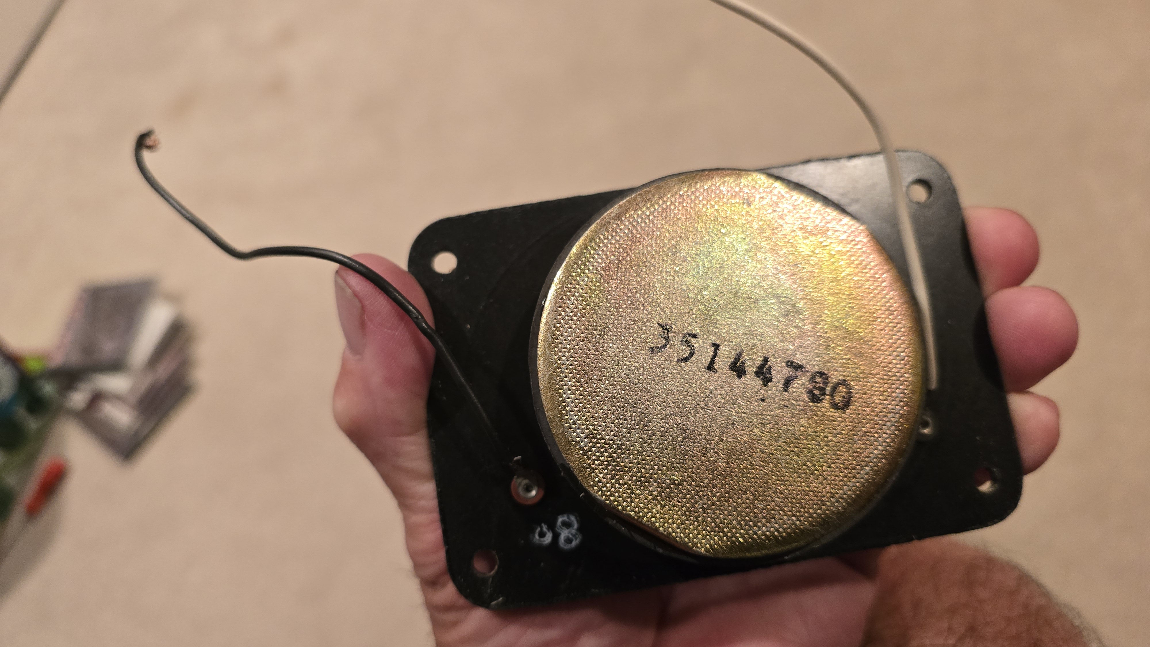

    I can tell you that I am certain that this one is Made In Denmark. Do you see a smooth silver back plate with flats? Me neither lol. There are no Chinese made Peerless KO10DT tweeters.

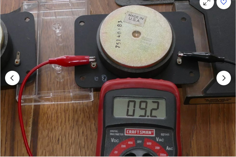

    Here is about the latest production date I have seen; 8th week of 1985. I see a back plate indention. I also see a "Made In USA" sticker.
