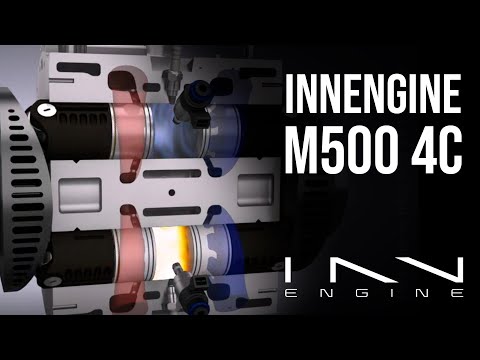

    This video shows that there is another squash plate that defines a channel with the main one, and the piston bearings are forced to ride in that channel.
    https://www.youtube.com/watch?v=gqc0KZRKreE
