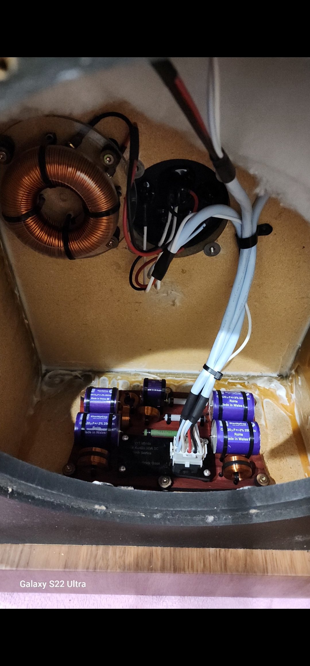

Mahogany substrate, laser cut
Custom delrin caps mounts
Jantzen inductors
Clarity csa capa
Jantzen superes resistors
Supra rondo internal wiring
Supra rondo double run sda cable nl4
Aluminum terminal plates
Jantzen inductors
Clarity csa capa

Full rebuild!
Clarity cmr
Path audio
Jantzen
Supra
Point to point
Dynamat drivers
Resealed enclosure
Hurricane nuts
Black hole 5
Dreadnought 800va

Installation steps
Gasket tape terminal opening
Install terminal plate
Route wiring, hook up sda inductor
- Not Tom ::::::: Any system can play Diana Krall. Only the best can play Limp Bizkit. -
Reinstall insulation
Reinstall drivers, replace gaskets if oem gaskets are torn or missing
Install crossover, secure wiring

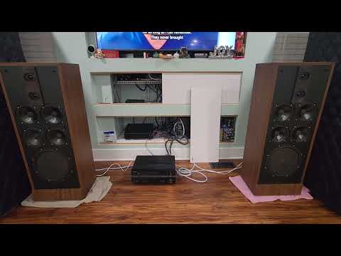

Insanely better presentation with the diffraction pads installed, easily heard in the video
https://youtu.be/hZNb0wULqp8?feature=shared - Not Tom ::::::: Any system can play Diana Krall. Only the best can play Limp Bizkit. -

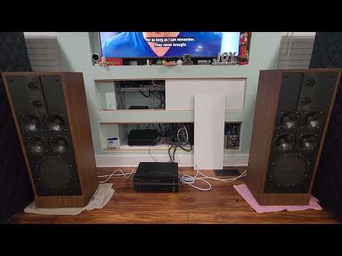

Insane amounts of bass is produced by these little guys. Truly impressive!- Not Tom ::::::: Any system can play Diana Krall. Only the best can play Limp Bizkit.
https://youtu.be/1527dovoU1M?feature=shared
You might be able to pick up the image and bass here but it easily is filling my 24x15 room with sound- Not Tom ::::::: Any system can play Diana Krall. Only the best can play Limp Bizkit. -

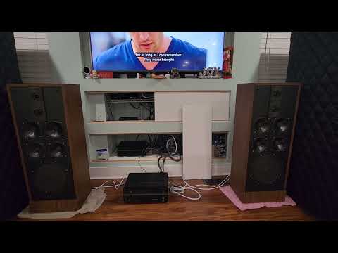

https://youtu.be/h8BjYxEN2vk?si=CdxUOiuOI7oCVTBV
This is with a 50 dollar receiver powering them to, so much fun- Not Tom ::::::: Any system can play Diana Krall. Only the best can play Limp Bizkit.
