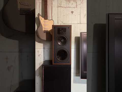

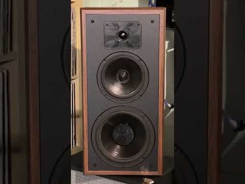

Here ta' go:
Each is about 3-4 feet away from mic, but different zooms.
Tried to match db, but likely not perfect.
Wondering if zoom affects mic gain...
Both recorded with only left channel active.
Mod 2
- Printed phase plug
- BH5
- Wuhan
- Matted basket
- Foamed
- in corner
Mod 2
https://youtu.be/iYrdVJaZ2bE
Mod 4
At about 1:43 syncs it to the same spot as the Mod 2 vid.
https://youtu.be/0ktOBXGQ5bs
Mod 4
- Aluminum plug
- BH5
- Newly upgraded crossover (needs burned-in)
- Silver wiring
- Semi rings
- Hurricanes/bolts
- New terminals
- Removed polyswitch
- New gaskets
- Daytons
- 2ft from left wall/corner

Much better. Hard for me to tell the difference with that reverb in the guitar now, though Mod 4 sounds much better in the treble region. Also zoom on iPhones and Androids does affect microphone sound because they do AI processing for "audio zoom", so don't use the zoom.
Once you're done, please set up a proper mic and get some recordings, very interested to hear how they sound. Obviously no comparison with the originals but that's okay.My gear:- TCL 75QM7K TV
