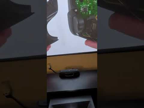

    I'm having this same problem (I've only had mine for three days), am I going to have to get a replacement too or is there a software fix?
    EDIT: In fact, here's a video of my issue https://youtu.be/rHf5yIt1bZQ.
