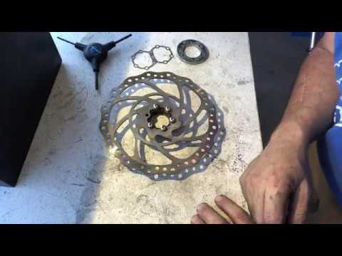

  • I was pretty sure that the hub manufacturers do not want those pieces coming apart. Maybe yours is threaded with some permanent locking compound. I don't know. I found one youtube video where a guy pulls his off with a puller (his wasn't threaded obviously) and gets the sheared bolts out from the other side
    https://www.youtube.com/watch?v=dBJ8HF_NY_c
