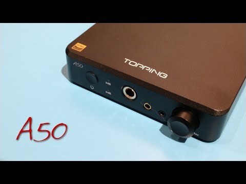

    Check this one. It puts out 2.2W at 62ohms and Toppings get good reviews.
    https://drop.com/buy/topping-a50-headphone-amp
    https://www.youtube.com/watch?v=6dVw-iRT1yg
    I have the Schiit Jotunheim and I love it.
