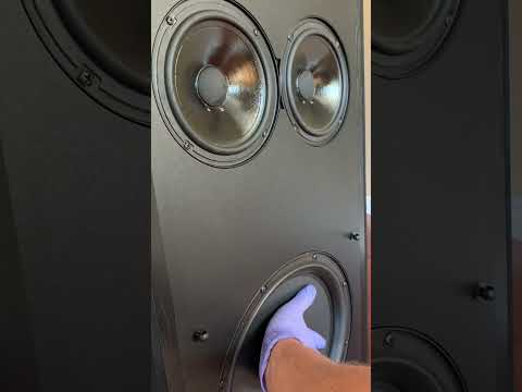

    I am pushing and holding it in. This weekend I'll try to make a short video of the MW drivers as I do this. Perhaps I'm counting too slowly or something. This way others here can see what I'm seeing and let me know what they think.

    I hear the air on both speakers. I'm nearly certain it's coming from the dust cap area. The gaskets everywhere seem fine and it looks like there's plenty of glue all around the joints inside so I'm not sure where they'd be leaking. I made a short video of the MW drivers while doing the leak test, but I haven't been able to attach it to a post. I'll keep working on that.

    I definitely don't have superhuman hearing :) So maybe I'm not hearing air like I think I am. I definitely hear some kind of hiss where the MW's are, but maybe it's just the sound of the drivers pushing outward? Unfortunately I don't have any other drivers around to swap out.
    Here is a link to a quick video I made. Hopefully this is useful. Just wondering if any of you also feel that there's a leak based on the time to recede. The 'clanking' noise as the drivers are pushed out is not the speakers, it's other background noise.
    Thanks,
    Greg
    https://youtu.be/-jyOZFRSrFk
    F1nut Posts: 52,165
    The drivers are receding too quickly. It should take 3 to 5 seconds, yours take about 1.

    About the excess glue squeeze out, it could still be brittle and cracked in places. I say this because I had my 7B's on the *operating table* many times and the last time I worked on them to put the Rob's Rings in, I leaned a bit too much on the baffle down by the passive hole and heard a definite crack sound (Doofus!). Sure enough there were now cracks in the excess squeeze out visible. I think the adhesive gets very brittle over time. That's when I pulled out the JB Weld and did an emergency repair where I put the stuff right on over the excess and did a fillet all around the lower part of the baffle until I ran out of epoxy. I'll have to do it right some time.
    I think you need to seal your cabinet joints as previously suggested.
    I watched your vid and my 7B's definitely do not do what yours do, where they initially move back in part way too fast and then seem to hold that position or move very slowly from there until you release the passive at which point the fully retract. Mine are slow and even retraction.

    Thank you very much for the feedback! I'll go ahead and seal up the cabinet joints. I figured I was failing the leak test but I appreciate the confirmation after viewing the video.
