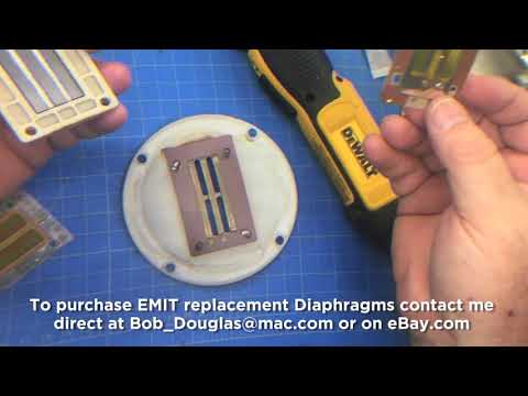

    I see these on the bay. They seem like a good deal. Seem to be quality parts. Is there any reason I should not get them? Is the install something I should send to a pro for. I know how to solder but have NEVER handled a planar tweeter.

    I thought I'd been following the thread but I didn't know you had an EMIT problem, just a possible woofer malfunction. Those tweeters aren't as flat frequency response as I would've thought. Does the speaker use some active equalization circuitry to flatten the response, or is there overlap with the mids to flatten the overall response?

    I dont know but I feel the tweeters are not 100%.
    These speakers are going to get more attention and funding from me than any other speakers I've owned. Just wanting to make sure I do them right and wanted to get new planar tweeters.

    Dang, sorry to hear the EMITs may have issues too.

    They might be fine, I just want a second pair to compare to and if they are fine I want a second set for backups before they get any more costly.

    Looks like they are an easy replacement.
    https://youtu.be/yXaVErRn6u4
