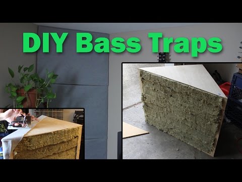

    I traded my SRS 2 for a complete acoustic treatment for my small humble room. Guy came up from Miami did several messument with some mic's and a PC. Placed 9 Owens Corning 1 inch glass fiber and two bass traps. I added 4 more corner bass traps later.
    Before I made this deal I was going to go with Roxul. Here is one of the videos I liked for the DIY.
    https://youtu.be/41liBn-QNW4
    You can use the same stuff for some acoustic panels.
