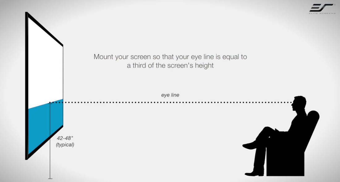

my screen is mounted as shown
Ok, but you don't look at the bottom third of your screen... And the sound shouldn't come from the bottom third either.
Aim for tweeters to be ear height when sitting.
When we did the speakers behind a projection screen for my parent's den, we placed them tweeter ear height while screen was mounted similar to pic above (eyeline coming out close to 1/3rd of screen height).
Both movies and music performance were excellent and I wouldn't do it any other way.
