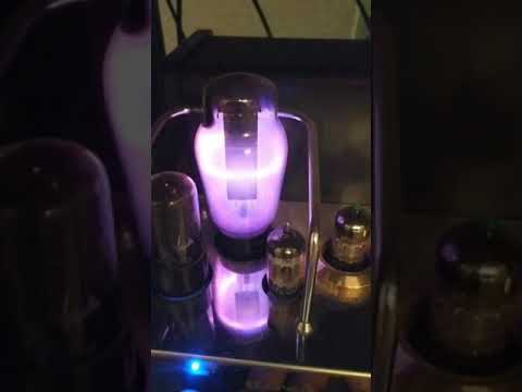

Is it normal for a 5U4G power tube to glow purple, flicker purple, etc. when it's first turned on? I don't recall ever seeing this happen. Even after they settle down there's still two small sections of "wire" (filament?) inside the tube that stay purple until the tube has been powered up for several minutes which the purple then goes away completely. I feel like this is an indication that the tube is on it's way out or is somehow leaking but thought I'd ask the forum since after it totally warms up it looks like normal. Should I pull and trash it?
Sorry for the horrible picture. I don't have a tripod and close up shots the shutter stays open so long that I inevitably move the camera.

    Not normal in a 5U4 IME & to the best of my knowledge. My guess is that it's "gassy" = bad. Now, it is possible that it's a symptom of another problem (specifically, excessive current draw by the components "downstream" of the HV rectifier), but it may well also be (as an MD would put it) idiopathic. I.e., it's gone bad because... it's gone bad B)
    Is that, by any chance a "modern" 5U4 (more to the point, a Chinese or even Russian tube)?
    I'd replace it, were it mine. Do you have access to a tube tester?

    It's an old RCA.
    Thanks for the correction Marv.
    I'm pretty sure the only other 5U4G I have is the Chinese one that came with the preamp. I'll see if I can find it.

    True although, of course, a 5U4/5U4G/5U4GB HV rectifier is a high power tube in most audio applications (all the HV juice, at least, flows through it!) and dissipates a lot of heat, akin to a power output tube.
