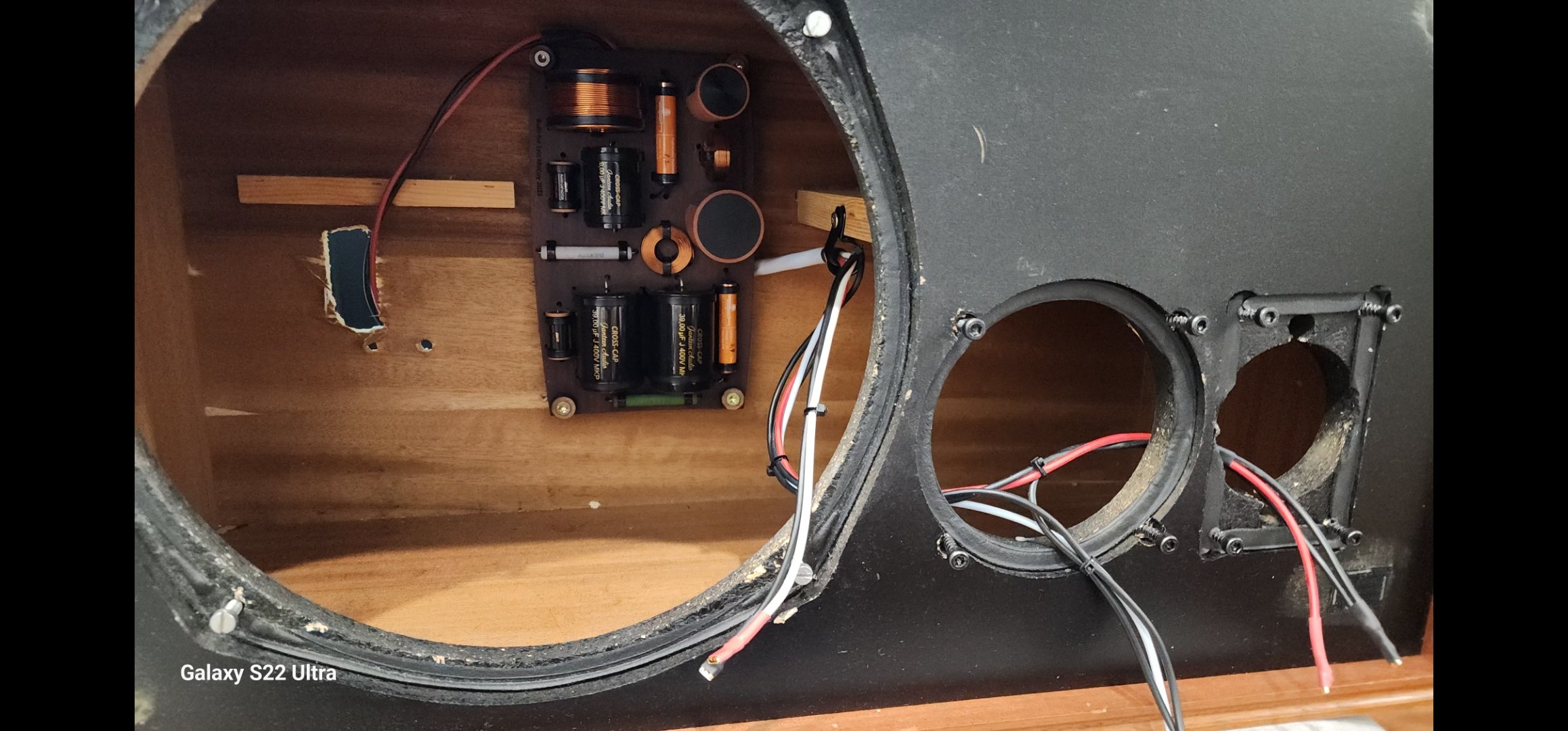

Got a pair of these local and really dig the cabinet and design. Crossover PCB is superb for the year these were manufactured (around 1971 - 1974). This is going to be a winter project with new capacitors, new seals for the drivers, new mounting hardware, possibly new binding posts and a lite sand and shine for the cabinets.
Ongoing thread, and here are a few pictures:
Not mine, but here is a pic of the speakers with grill removed:

Tandberg made excellent receivers as well. The drivers on this speakers look phenomenal, the crossovers look really clean too. I would test the components before replacing anything... you may find that their still under spec. -
Hmmm,
Frequency Response: 35Hz to 22kHz
Power Handling: 45W (max continuous)
Crossover Frequency: 700, 2000Hz
Impedance: 4Ω-8Ω
Xover 700hz,2000hz
I'd replace the resistors at least with some Mills...
Better inductors too if the old are not hand wound...
The Xover diagram is at hifiengine.
FWIW the only thing I'd be looking (hard) at are those capacitors. I cannot tell what they are based on the photo. If (????) they're NP electrolytics, that's what I'd change.
They may well not be -- but I ain't sure.

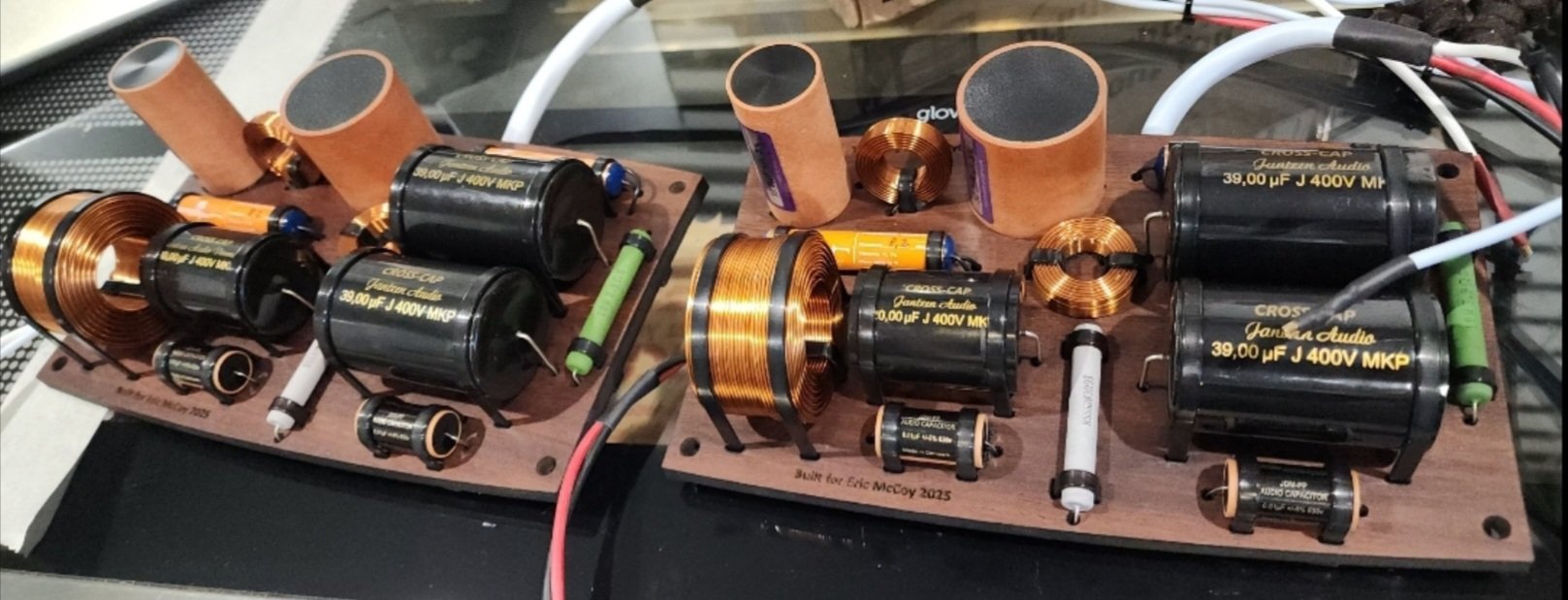

Update:
Ordered Mills resistors from Sonic Craft and Dayton capacitors from P.E.
Also ordered some of the P.E. speaker gasket material. I'm going to stick with the stock inductors to keep cost down for this project.
