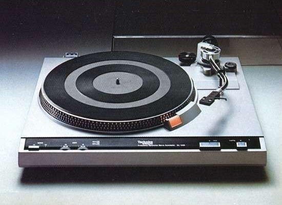

After a long dry spell i found something worth the while at Goodwill. The SL220 is in good shape, has some Shure cartridge, and the belt looks new. Speed drifts a little but it may be a dirty pot. Didn't really need it but it was only $30

That one's belt drive, yes? (I am too lazy to double-check!)
The speed variations are "usually" (often) dirty trim pots for the speed adjustments on the belt drive Technics' IME. I would think checking into the lubrication of the platter (spindle) bearing & the condition of the drive belt would also be well-invested effort.
EDIT: Yup (I checked)
http://www.vintagetechnics.audio/showitem.php?id=YToyOntpOjA7czo2OiJzbC0yMjAiO2k6MTtzOjEzOiJiZWx0X2RyaXZlX3R0Ijt9
Vinylengine's got operating and service manuals, it appears (if you didn't snag them already):
https://www.vinylengine.com/library/technics/sl-220.shtml
