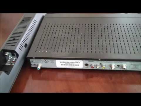

Maybe this will be more helpful to you if your equipment looks like this from DTV.
https://www.youtube.com/watch?v=v7ZatQVdEWw HT SYSTEM-
