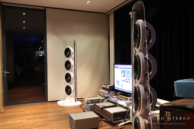

  • WLDock
    WLDock Posts: 3,073
    Speaker stands should not have glass plates such as that monoprice stand.
    Yeah, I thought the same thing when I first saw the Sonus Faber Venere speakers and speaker stand bases: 413sonus.promo_.jpg?itok=WDJWHqtD
    I still want a set of the Venere 3.0!
    And I guess these co. did not get the memo? Crazy interesting stuff! Some are always pushing the edge.
    http://www.waterfallaudio.com/?lang=en
    http://www.perfect8.com/point.htm
    http://www.crystalcable.com/speakers/arabesque-glass-master/
    13562132_1737181183236169_510354_n.jpg?ig_cache_key=MTI4Nzk4MjIxOTkyMzM3MDkyMQ%3D%3D.2.c
    mount-it-premium-aluminum-and-glass-speaker-stands-for-home-theater-satellite-speakers.jpg
    Yzg1MGMyNmQwZGY3ZmZiZjlmMjdiNGU1NjBiMjkxOWE5sBBXVhV37cRy2BcUvnxYaHR0cDovL21lZGlhLmFkc2ltZy5jb20vZTg1MWQ3YzkxODc2YWEzNzk3OTM4MGVlMWMxYzQxNDcyYmUxZjdjZjYzMmUzZTEzMWY3Nzc1NzIyZGU5YzY0Zi5qcGd8fHx8fHwyNDl4MjkyfGh0dHA6Ly93d3cuYWR2ZXJ0cy5pZS9zdGF0aWMvaS93YXRlcm1hcmsucG5nfHx8.jpg
    F1nut Posts: 51,880
    In reference to those glass speakers, more like a sales gimmick, IMO.
    I don't know, I've never considered glass in be inert, but what do I know.
  • mdaudioguy
    mdaudioguy Posts: 5,164
    But they're so transparent! ;)

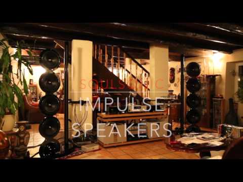

  • WLDock
    WLDock Posts: 3,073
    There are no gimmicks audio....you get what you pay for right?
    $100,000! http://www.soulsonicspeakers.com/index.html
    The question is, are the tempered glass $100K speakers worth the price any more than ones made with MDF, wood, or aluminum? I guess that's up to the designer and the listener...willing to pay the BIG bucks.
    https://youtu.be/9S5NfIJ4yts
    From >$200 speaker stands to $100K glass speakers what a crazy thread redirect. Sorry Dan!
