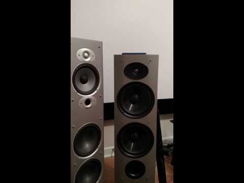

    Thank you all for your input. I decided to take a video to capture the noise that I am experiencing. In this video, the ONLY thing I had connected to the amp was 1. the power cord and 2. one speaker. I don't have any inputs or interconnects connected to the amplifier. In a quiet room, I can faintly hear this buzzing from 10 feet away.
    Please let me know what you think!
    https://www.youtube.com/watch?v=JIL3XIXYnKw

    It is 120 hz. I wouldn't live with it. You do need to determine whether it actually is louder on the main channels or whether the sensitivity of the larger towers make it seem louder. Move an offending main speaker to other channels to test levels of buzz in each so that you know what to tell a tech. It would be time for me to take it to a tech.
    msg Posts: 10,473
    Yeah, not the same hum I was talking about, either. That sounds similar to ground loop hum when I had that problem, which is more of a buzz to my ears than a hum. Agreed, with nothing else connected, definite seems amp related since you've also tried a cheater plug of sorts as well.
    Dennis - side question - how can you tell it's 120?
  • Dennis Gardner
    Dennis Gardner Posts: 4,861
    I RTA'd it on my phone app.

    Thank you everyone for your input and suggestions. Through your help, it has become clear that this buzzing is not "normal" for a parasound amplifier. Now that I know this, I'll have a professional look at it and hopefully it will be a simple fix. :#

    Now that I got a chance to see and "hear" your video, that is not normal for that amp. Mine never had a buzzing sound that loud.
  • Upstatemax
    Upstatemax Posts: 2,802
    That does not sound normal for Parasound at all.
