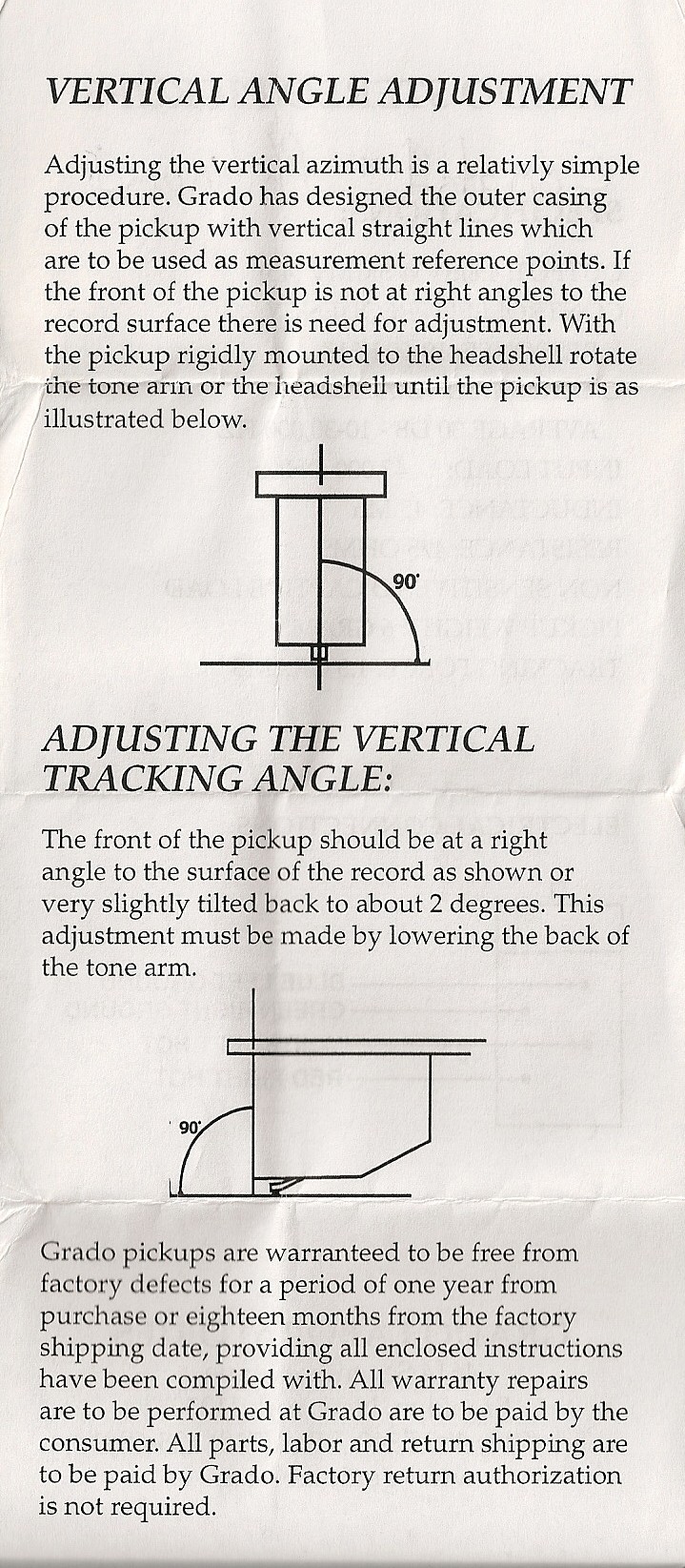

    I definitely adjust my VTA. Luckily the four tables I own all have adjustable VTA. I read an article from Michael Fremer stating that basically most records are cut with the cutter head stylus at 92° and that one should also set the styli on your turntable at 92° to replicate the cutter head. After reading this I gave it a try. On 22 of the 23 cartridges I own, setting the VTA at 92° made a definite improvement in sound. The tonal balance from top to bottom was correct, and the soundstage width and depth increased from a decent to huge amount depending on the particular cartridge.
    One of the things you hear a lot in the audio community is Grado cartridges in general have rolled off highs. You need to hear a Grado set with a VTA of 92°! The highs really come to life, detail is improved, and soundstage width and depth become huge. Granted there still may not be as much high end extension as your typical AT or Sumiko, but high level detail is definitely there and much better than many realize without them being set to the proper VTA.

    Dawgfish wrote: »
    So you're saying you have the back of the arm up higher then the front to get 92°?

    Dawgfish Posts: 2,554
    gce wrote: »
    Dawgfish wrote: »
    Yes that's exactly right. It sounds counter-intuitive to what you always heard about setup before. Before reading the article, I always ran the tonearm either level with the record or even with the tonearm slightly lower than the headshell with most carts. The thing is when you first try it, the rear of the tonearm will be higher than you were expecting it to be. It's ok though. Try it! You'll like what you hear! BTW, Soundsmith recommends setting carts up with a 92° VTA also.

    when you mention 92 degrees I get lost thinking is that open? or closed? as it depends how you look at it. but now i know what you mean.
  • gce
    gce Posts: 2,158
    voltz wrote: »
    Yeah, I was a little confused too. That's why I put up the pic. Now I'zz get it. ;)

  • StevieB
    StevieB Posts: 257
    I
    gce wrote: »
    voltz wrote: »
    It appears on the Expressimoaudio site they are measuring the 92 degrees from the other side of the stylus.

  • Dawgfish
    edited February 2016
    Trust me gentlemen, you want the back of the tonearm to be higher. http://www.analogplanet.com/content/how-use-usb-digital-microscope-set-92-degree-stylus-rake-angle-sra#vZepvdDA4cR7TY6l.97. This is a good place to start getting your read on. Not the using the USB microscope part, but click on the links regarding the 92° setting. Try it and let your own ears tell you!
    Oh yeah if you go to the Expressimo Audio website,http://www.expressimoaudio.com/vtablock.html, you want to use the +2 gauge block shown on the bottom pic. Raise the tonearm until the front of the cart is parallel to the edge of the +2 gauge block.

  • gce
    gce Posts: 2,158
    Dawgfish wrote: »
    So if I understand this right, if I have a 9" arm raising or lowering it .157" (4mm) would = 1°. So if I was at 90° I would have to raise the back (pivot point) .314" to get 92°? That seems like a lot.

  • miner
    miner Posts: 1,305
    That is right.
    Sin 2 deg = 0.0349
    0.0349 = A/9
    A = 9 X 0.0349 = 0.314
    On my VPI that would be 10 full turns of the VTA tower.
  • Dawgfish
    gce wrote: »
    Dawgfish wrote: »
    That is right. Again like I mentioned before, it seems like you raise it more than you should, but it works. I read somebody else's post in another forum that explains a cool experiment to try and here it goes: run your finger nail along a surface like a piece of lumber, tile, vinyl etc. First try it with your finger perpendicular to the surface to simulate a 90° VTA. Now try it with your finger raked back slightly to simulate a 92° VTA. Tell me what you feel and what the differences are. I know it's not a completely analogous comparison, but still try it and then think about what you just experienced. I'm not going to say any more about it. You can either dismiss it or try it. I tried it and was glad I did. I'm not the one who made this up.
