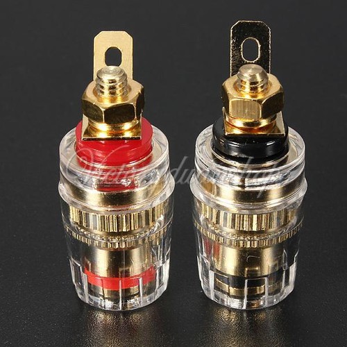

Replacing them all. If one broke I'm afraid the others might also and if I'm gonna replace one might as well do them all.

I didn't know if the crossover was attached to the cup holding the binding posts. I just ordered 8 new posts from Amazon. They weren't to awful expensive.

The Binding Post Cup connects to the Crossover via Molex Type connectors. Disconnect them, remove the four screws on the back, and remove the Cup. The wires connect to the Binding Posts via Crimp Ring Connectors. Remove the Hot Glue, and Use a Nut Driver to remove the nuts. You new Binding Posts may or may not fit through the Ring Connectors. You can replace them with new Crimp Ring Connectors, or Solder the wires directly to the Binding Posts.

westmassguy wrote: »The Binding Post Cup connects to the Crossover via Molex Type connectors. Disconnect them, remove the four screws on the back, and remove the Cup. The wires connect to the Binding Posts via Crimp Ring Connectors. Remove the Hot Glue, and Use a Nut Driver to remove the nuts. You new Binding Posts may or may not fit through the Ring Connectors. You can replace them with new Crimp Ring Connectors, or Solder the wires directly to the Binding Posts.

Depends Randy. If the Binding Post itself is loose and spinning, then just tighten the nuts in the back. If the plastic hold-down nuts are spinning, the plastic threads are stripped. I've got a tone of old Polk Posts if you need, but replacing them with better quality posts is the best option.boston1450 wrote: »Thats to replace them correct ? If they keep turning & not tightening up-does that mean they need to be replaced ? Are there other ways to keep existing post & repair methods ? Reason i ask is ive heard this before & wondered

In my case the plastic nut is stripped. I have no desire to replace the one with an OEM binding post. A quick Google let me a video on how to remove the hot glue. This doesn't look to hard to do. I'll post some pics that is as long as I'm successful.
