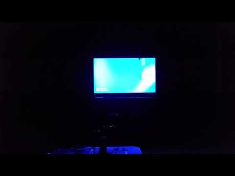

    Wow, Freeride, is that the vid of your last colonoscopy? If so, two observations: 1) They had the 'scope's light source dialed up too high early on for the procedure to be of any diagnostic/therapeutic value. 2) It looks like you might suffer from some serious acid overproduction issues.
    jmho, of course.
  • Thanks for being so concerned about my **** haha. Sorry thats the only response i could think of. LOL

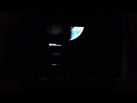

  • All of the new components are here hate to take them out of service for a while.
    https://youtu.be/KH_yqxsTRS4
