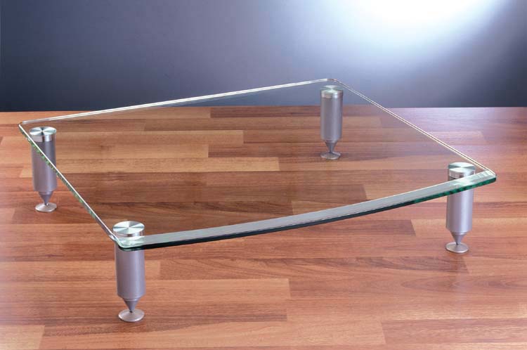

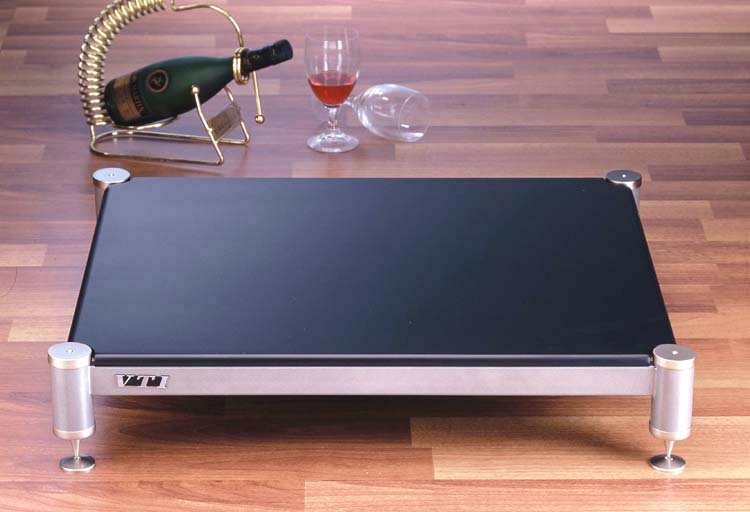

    Here are a couple of amp stands we carry. Both come in either silver or black. PM me if you have any questions.

    I did not know you were selling amp stands Doug, now I have a new link to recommend people to look at :) and I may see about getting one from you soon.

    We just started being a dealer for VTI manufacturing at the first of the year. I have some of their speaker stands listed on our website, but have lots more to get listed. Give me a holler when you need something.
