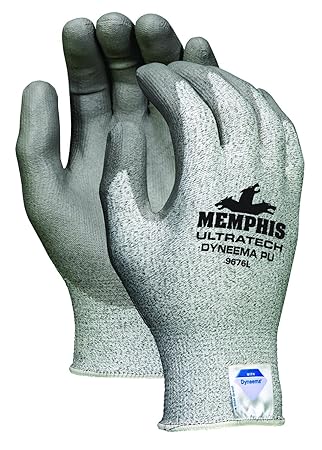

    SCompRacer Posts: 9,128
    bartkess wrote: »
    I have the Pro-Ject Audio - Tube Box DS. The tubes don't stick out enough for me to get a good grip on them to pull them out. How do you guys get them out?
    Thanks for the help.
    Welcome!
    I wear a pair of Dyneema Polyurethane Gloves. Around $10-$35 depending on brand. They aren't too thick or thin and provide a non slip grip on the glass. AKA cut resistant gloves.
  • bartkess
    bartkess Posts: 2
    Thanks for the info. I was able to get the tubes out using kitchen gloves. But was not able to get the dampers off the tubes. I wanted to see what tubes are in it.
