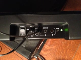

Attached is a copy of the ports on the soundbar -
Hello,
You are correct, you'll need a 3.5mm cable to RCA type to make the connection to the bar. The goal is to make a good mechanical ground connection between components. If the TV has an RCA type connection, try connecting the cable box and it first.
Yes, reestablish the digital connections you've already had.
Regards, Ken -
