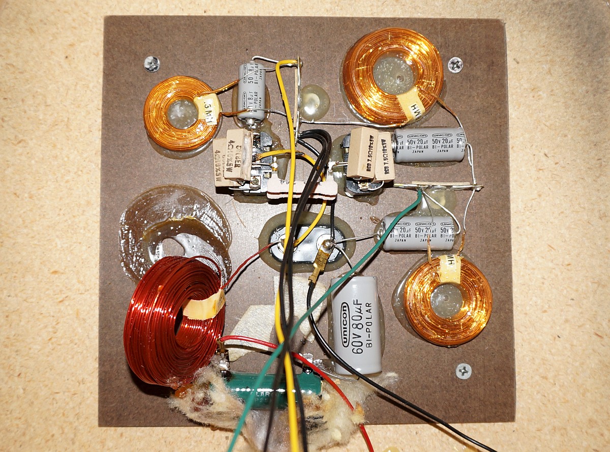

Tweeter checked out okay by the multimeter so had to take crossover out.
Very decent crossover. You have to take the tweeter/mid panel off, then take the padding out and finally the board on the back.
I see one big inductor was hanging but that was not the issue.
Why does a 3-way speaker need 4 inductors?
I grabbed alligator clips and went on checking tweeter connections.
One 8uF capacitor was the issue. It was not sending any signal to the tweeter even though it had continuity.
Anyone know what that green/blue component is on the bottom? May be 1ohm resistor in the schematics but it's huge.

Replaced the tweeter capacitor, secured the inductor with hot glue and put back everything.
As soon as I lifted the speaker, I heard clunk, clunk.
WTH??? Took the crossover out to see another smaller inductor was unglued on one side. This time, I glued all the inductors and checked if anything is loose.
Put back together and sounded great but the speaker with new tweeter capacitor sounds much brighter.
Obviously, the other speaker had old worn out capacitor so I replaced that cap on the other one as well.
They definitely need new caps on all circuits but I don't have them at the moment.

The green component is most likely a vitreous, or glass coated load resistor.
A 2nd order band-pass for the midrange would have two coilsHome Theater/2 Channel:
dhsspeakerservice.com/ -
westmassguy wrote: »The green component is most likely a vitreous, or glass coated load resistor.
Definitely that 1 Ohm 25W power resistor shown on the schematic.'65 427 Shelby Cobra

westmassguy wrote: »A 2nd order band-pass for the midrange would have two coils
Hmm... over my head so I'll leave them along and replace the caps.
I remember now.
I do have a big package of new caps and resistors from Madisound that I ordered for bunch of vintage Polks that I already sold.
I may be able to get them pretty close to spec within 5% for the woofer in Genesis by combining few different capacitors.
Tweeter cap is already replaced.
I have matching caps for mids but lows uses 80uF that I don't have.
If I combine 3 caps, I can come up with 84uF instead of 80uF.
That's still will be within 5% tolerance, don't you think?
I'll see how it works out since I already have them.
Hmmm... will update.
Capacitors replaced.
I didn't replace resistors as from my past experiences, resistor values were pretty much the same and also no point in replacing sand cast with sand cast.
Highs/mids have mylar caps and lows have a combination of NP and mylar.
Mids are better and have more punch than before but vocals became slightly edgy/rough.
Should get better after burning in but it does add realistic tones to instruments and may be that's how it should sound.
Guitar sounds like someone is plucking the strings in the room itself.
Also, haven't played with the attenuators in the back for mid range and tweeter level adjustments for the right balance.
I have both at normal levels.
Lows improved dramatically. More power and punch than before.
