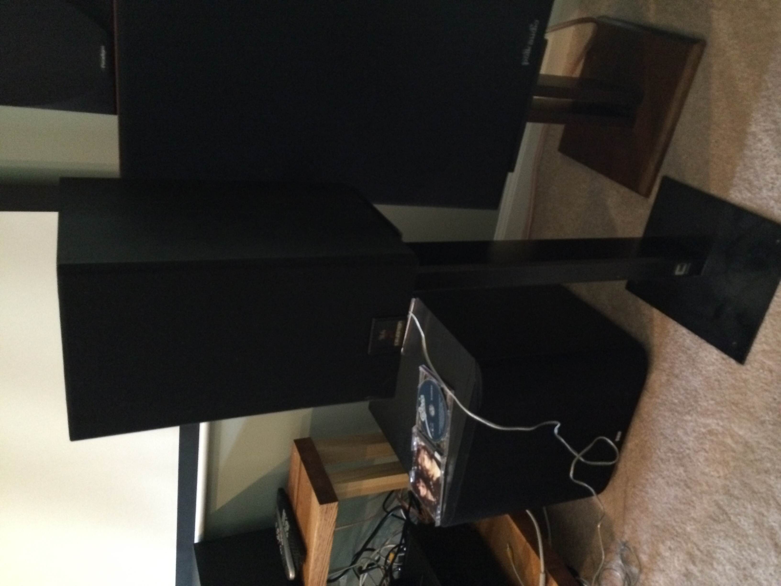

I just won a local estate auction for a pair of Celestion SL6Sis. They were hard to make out in the online photos, and I think that's why my bid won. Judging from what they go for on eBay, I made out.
So I picked them up today. They amazingly came with a ton of heavy speaker cable (which I haven't gone through yet) and were mounted on their original equipment steel Celestion stands, which weigh a ton. So a total score!

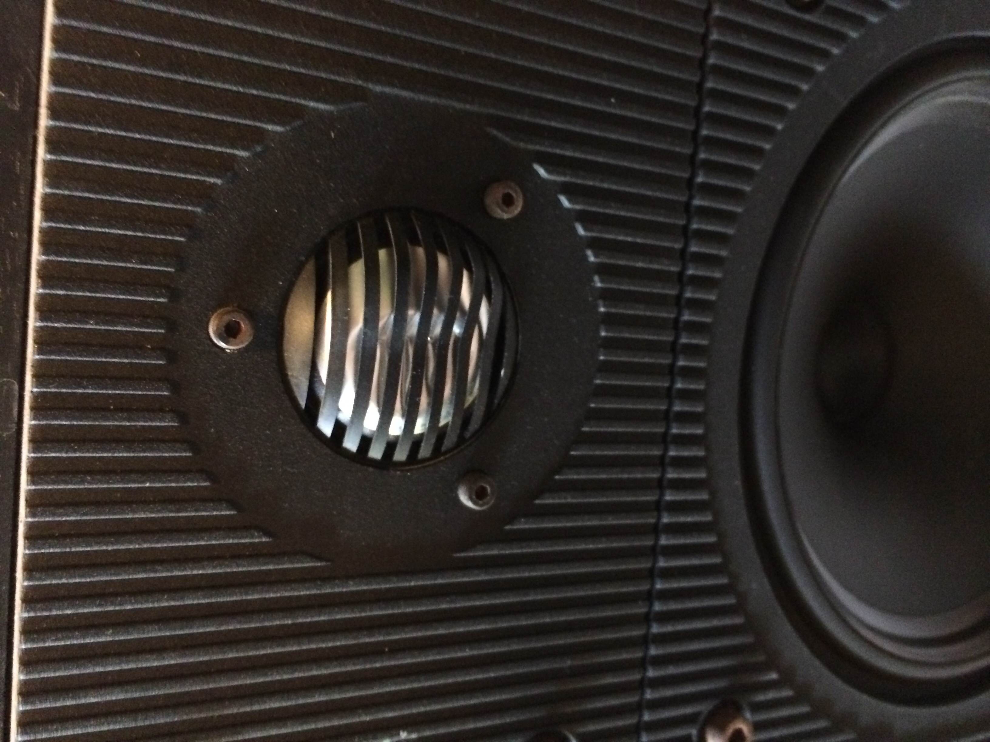

The cabinets are a bit beat up but the grilles are nice. Then I pull the grilles off.
Uh oh!
Two dented tweeters! These are the later aluminum dome tweeters. Maybe my investment wasn't as good as I thought it was. I started to think that at least I can part them out and get my money back.
But when I set them up and plugged them in to my NAD 7100 receiver, I was quite impressed. These sound pretty good. On the stands they throw a good soundstage and sound quite well-balanced. Bass is a little absent but for a small two-way monitor I'm not surprised.
My short listen didn't uncover anything that would lead me to believe that the tweeters were not functioning normally. I'm going to try them out against a few other pairs of my speakers lying around (Paradigm Atoms, B&W DM601s, Polk Monitor 7s) to see what I can tease out.

This pair is a little beat up and the tweeters are a little bent. I would restore them but unless I can find a set of mint replacement tweeters at a reasonable price I'll likely just let them be the way they are.

If you are lucky it might be possible to pull the dents out with tape or a vacuum nozzle. I have pretty good luck making caved in JBL domes almost perfect with those methods.
Thanks, I'll try that! I was thinking about trying a repair at first but at this point I'm almost leery of hurting anything - they make me happy as-is. that said sometimes I think I can hear some sort of click or resonance during transitions but there is no distortion or regular artifacts that I can pinpoint. Maybe I'm just being paranoid....

There's a few Celestion tweeters on eBay. You'll have to get the model off the back of yours.
You could try the vacuum method, if you can separate the front grill from the diaphragm. The dents will interfere with the dispersion characteristics.Home Theater/2 Channel:
dhsspeakerservice.com/ -
not sure about the celestion tweets but many of the old vintage tweets can be easily dissasembled and then reassembled with some care to get the VC centered properly. I would try the vacuum method first but if that fails and they can be dissasmbled, the dome can be worked from the backside through the voice coil. I do prefer the vacuum method in these situations when it works, however.If con is the opposite of pro, is Congress the opposite of Progress?!
