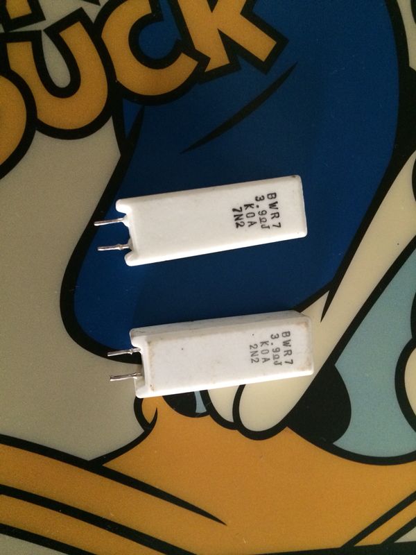

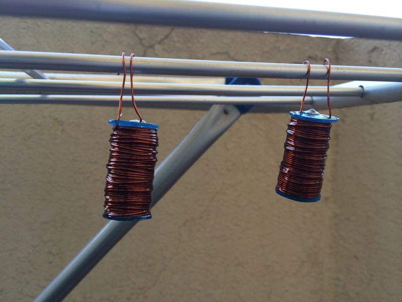

    Thanks for all the input, hmmm I think its better to have a step by step approach. The biggest problem is that I've never come across these speakers with anyone in this region yet, and that makes it difficult for me to make up my mind to what these speakers will really sound like. Am attaching the pics for the newly wound inductor and resistor that my friend has done for me.
    Let me know your thoughts about the same.

    Don't know about the quality of either of those components. The inductors look to be wound haphazardly with thick gauge wire. Ideally you would match the DCR as well as the inductance used in the originals. Modern inductors such as the jantzen sound better due to the higher purity copper wire used, as well as the way they're machine wound.
    Can't comment on the resistors other than to say they look like the originals, which were probably good in their day. Technology marches on though and Mills or something like them would almost certainly sound better.
    Since you already have those components may as well try them. My philosophy is I don't like to do things twice so I usually go for the best I can on the first try.

    Thank you all for the support and knowledge that you all have shared with me.
    My oh my.. Its absolutely brilliant now after changing the resistor and inductor coil. The sound stage is really wide and open.
    Listened to the Frozen by Madonna it was a really an experience. Am really a proud owner of SDA speaker now.
    I think the bass needs some more improvement cause and the moment its not really tight. May be it will improve with time since these where not pushed since a decade plus,
    I believe they are a bit power hungry, what I noticed is that when I bring my Emotiva preamp volume to 12 o'clock on my EMOTIVA XPA-2 the real color is coming out.
