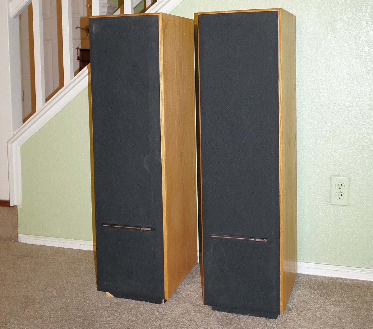

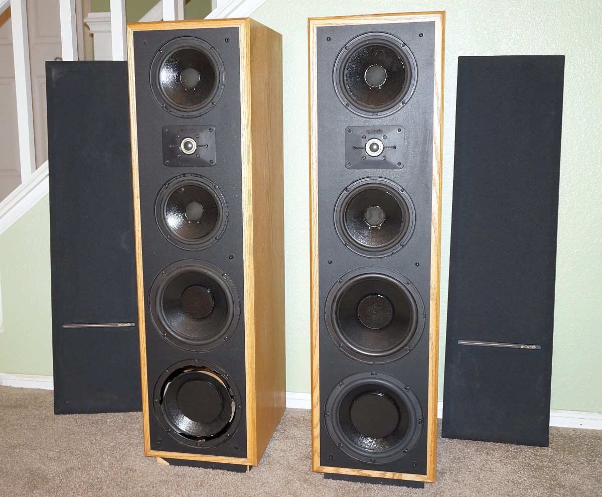

    Anywho, back to the RTA-11T. They need some TLC definitely.
    I had RTA-8TL and didn't impress me much but these are massive compared to them so may sound better.

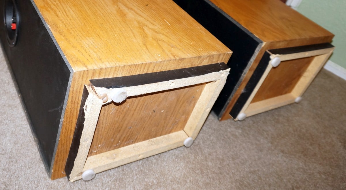

    The base stands are damaged/loose and one round stabilizing thingy out of four is missing in each so they tilt at one corner but that's not a biggy.
    One cabinet has almost all the grill pegs broken.

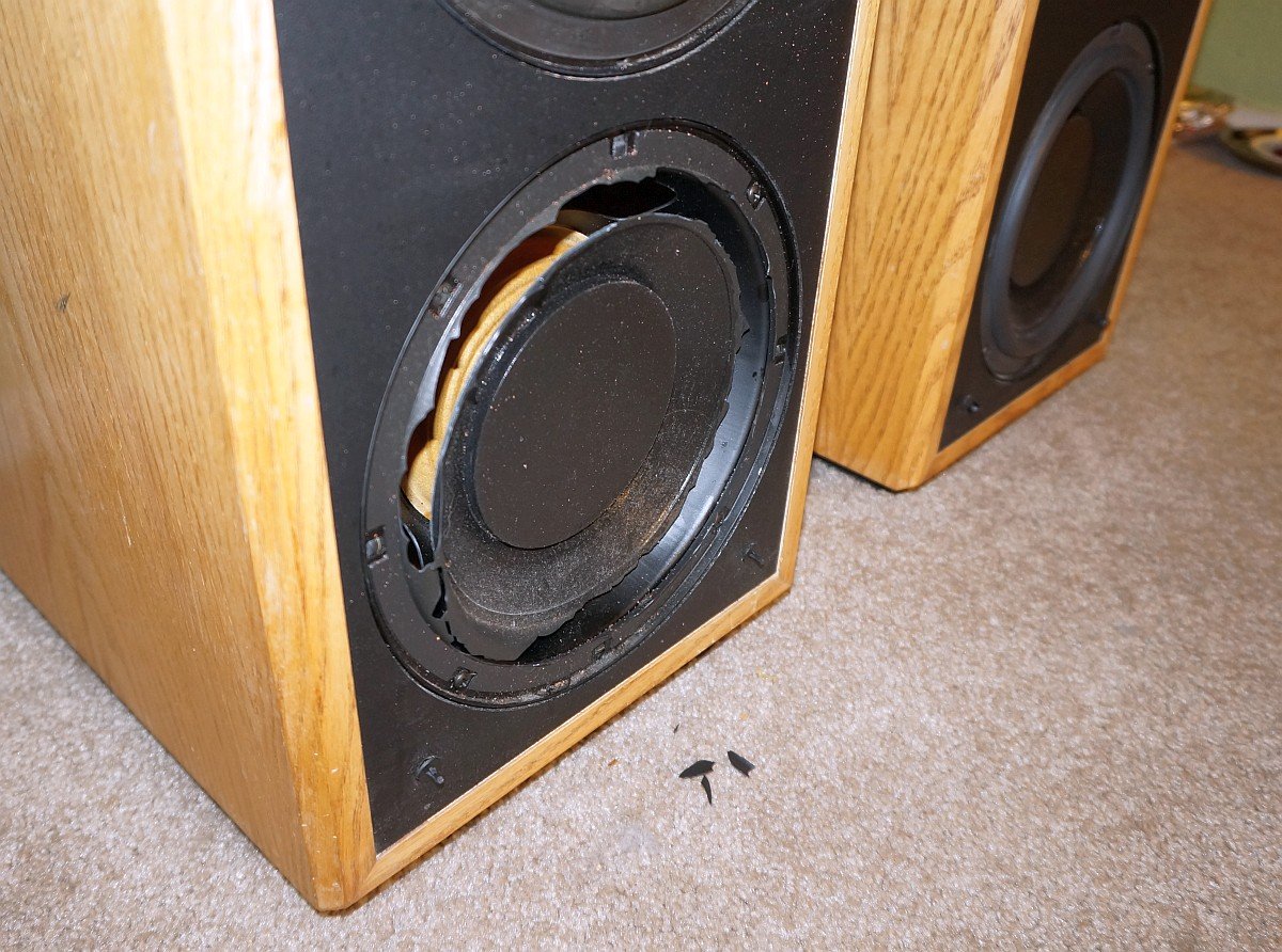

    Except the hard/brittle plastic surround on one PR, other drivers look okay but I didn't hear much output from the top mid woofer of the damaged PR cabinet but the cone moves freely in/out.
    Close up of the brittle/hard surround.
    There is not even .0001% rubber like characteristics on them. It's like dry plastic cone.
    It does look original so I have no idea what caused only this one to be like that.
    What are my options? Can I remove it from the cone using some goo-gone and then re-foam or find another PR?

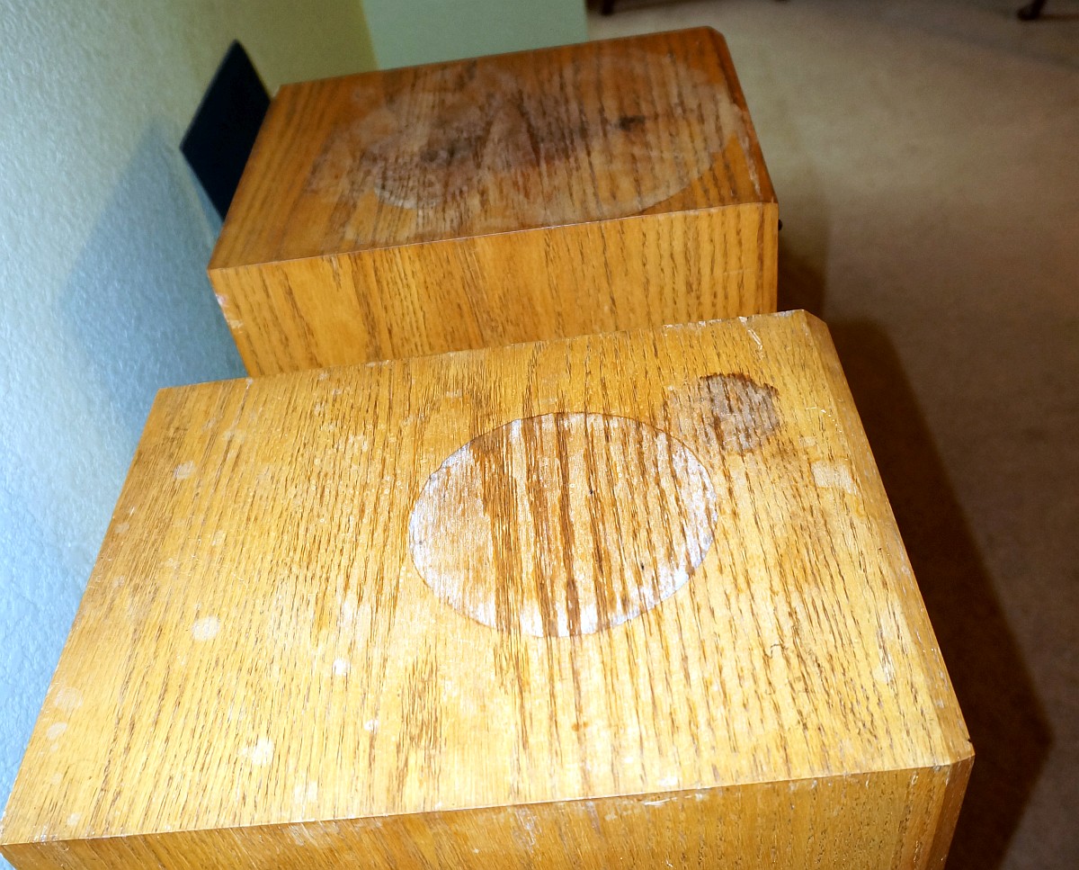

    Horrible water rings on top of both.
    I read hydrogen peroxide or some other chemical like Oxalic acid can remove the water rings.
    Any idea?

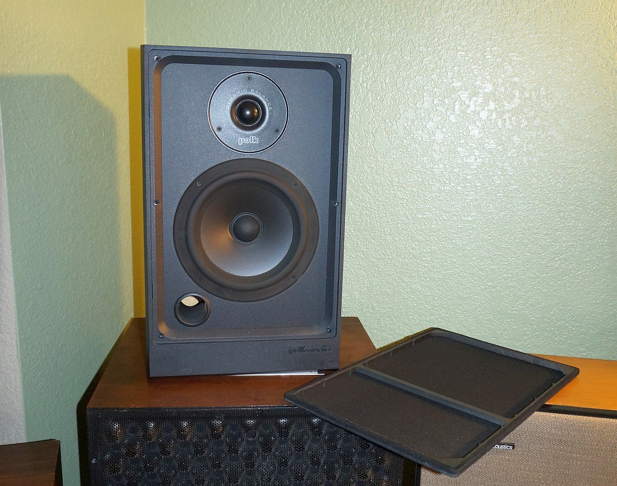

    BTW, also grabbed a pair of S4 today. They sound pretty decent for that size.
    The large white glides someone put on, the small brown one is an original. I'd remove the busted up bases, plug the screw holes and install tall spikes, say at least 2 inches.
    Any idea?
    Those are pretty bad, but I've seen worse. Oxalic acid is your friend, but it would tough to do without the slurry getting on the baffle and you really should do all the veneer to equal out. I'd suggest reveenering them.
    I've never seen a Polk PR or driver with that issue. nbrowser listed likely causes. Acidic liquids such as dog piss could also cause that.
    I'll try some chemicals and stain. Reveneering is out of scope due to my lack of skill/time.
    Weird thing is it only happened to that PR and it's not at one spot but all around the PR as if it's made with entirely different material. Even the PR above has good surrounds. :rolleyes:

    Those water stains are harsh looking! I have had great results with water stain removal by taking a clothes iron to it. Take a white old t-shirt and set on top so it is two layers thick. Then iron on high without steam on . Work at it until you see the results you are happy with. It might do the trick or at least lessen the damaged look. I have not heard those speakers. But Some people swear by the sound stage. Good luck. D

    Rubber surrounds can be replaced, more of a PITA than foam though. You're better off picking up one off eBay.

    Yes, real wood. A light sanding should be done before applying Oxalic acid, but a light sanding is not going to remove the stains on those speakers.
    The heat from an iron can remove cloudy marks, which are from moisture being trapped beneath a clear coat finish. However, this is NOT the case here.

    Ironing didn't do anything.
    On the right speaker, water marks are so bad that I see fine wood splits in few places, not deep, only on surface.
    Not really big but can see them when looking at the water damage closely. Looks like water stayed on the top for a while to soak in.

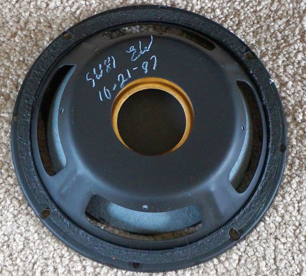

    I took the PR out and it is indeed original SW81 dated 10-21-87.
    Whatever made them brittle must have been equally applied to the whole PR or the material is made such that if one spot is brittle, it makes the whole thing brittle. Not sure what's the case.
    I'll see if I can remove the surrounds as I have bunch of 8" stiff foam surrounds lying around.
    Not rubber but they are pretty stiff so may work out fine.

    I wouldn't advise foam surrounds in place of the rubber. The T/S parameters will change quite a bit

    Told ya. I do this stuff for a living, I'm damn good at it and I know all the tricks.
    It's fairly thin veneer, I'd say it's worse than you think. I mean, I can tell from your pic that the right speaker top is basically F'd. The only way you'll get the black marks out is with Oxalic acid, but like I said it would be almost impossible to do without getting it all over the baffle and back. Time for new veneer.
    The oak has turned black because the moisture has caused a reaction with the tannin in the oak. As you suspect, it took a bit of time for that to happen, but perhaps only a few weeks if the moisture was present all the time.
    I agree 100%

    If I go oxalic acid method, I'll put it in a plastic tub and flip the speaker upside down so it only touches the top end.

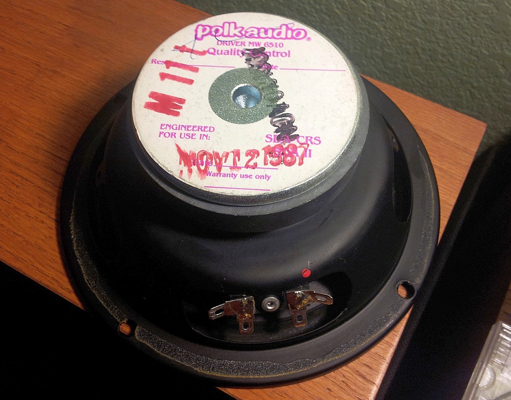

    BTW, my suspicion of the top mid woofer MW6501 not working on the cab with bad PR is correct.
    It measures 7.7 ohms and cone freely moves in/out so it must be okay.
    May be a loose connection in the crossover.
    Keep in mind that the Oxalic acid/water mix has to evaporate and return to a crystal form in order for the process to work, so the surface needs contact with the air.
    BTW, do NOT breath the crystals or you will have a sneezing fit like no other.

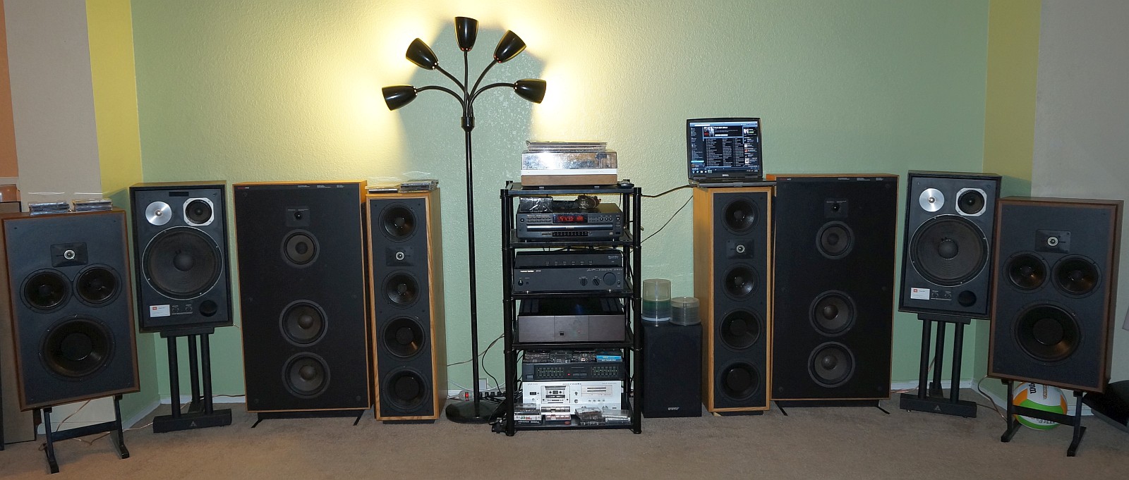

    Got a PR from Larry so all I have to check is that one mid woofer that doesn't make any sound, at least for functionality.
    No drooling but look at all those drivers!
    Yes, all are hooked up to a Phoenix Gold 6-speaker selector powered by Rotel RB-990BX. :smile:
    I was thinking I am thinning the herd but looks like I am just replacing the herd. :rolleyes:
    They are crowded but two pairs are up for sale so hopefully it'll thin out soon.

    I thought it read 7.7 ohms before but I took it out and it's open.
    The cone moves freely without any noise of rub.
    The mid woofer is 6510, not 6501.
    It has MW6510 SDA CRS written on the label as well as M 11t (may be for monitor 11?). Date is Nov 12 1987.
    Looks like VC is gone kaput.
    Anyway to fix it?
    I had a Polk driver lying around without any sticker so used it for now.
    It measures 7.7 ohms in my cheapo DMM while the working mid driver from other RTA-11T cabinet measures 8.0 ohms.
    I'm not sure if they are same drivers since there is .3 ohms difference.
    They sound the same so it may work out.
    What say you?
    I have seen replacement rubber surround kits available. http://www.simplyspeakers.com/Rubber-Edge-Kits_c_254-1-3.html
    It may still change the characteristics some but it would be a better match than going with foam.

  • westmassguy
    westmassguy Posts: 6,850
    edited March 2014
    After you're finished with the oxalic acid, you can neutralize it with baking soda mixed with water. The oxalic acid never goes away, it re-crystalizes in the wood fibers
    Home Theater/2 Channel:
    dhsspeakerservice.com/
  • Hofy
    Hofy Posts: 169
    edited March 2014
    With all the time and work and dedicated space needed to do the oxalic acid procedure, wouldnt make more sense to learn how to veneer? It really isnt that hard and you will end up with a better finished result. Plus you will have a new skill.
  • Mystery
    Mystery Posts: 2,546
    edited March 2014
    Hofy wrote: »
    Yes but no interest to learning veneer for now.
    I may buy veneer just for the top and glue it there or just paint something over the rings with darker stain instead of trying to remove the rings.
