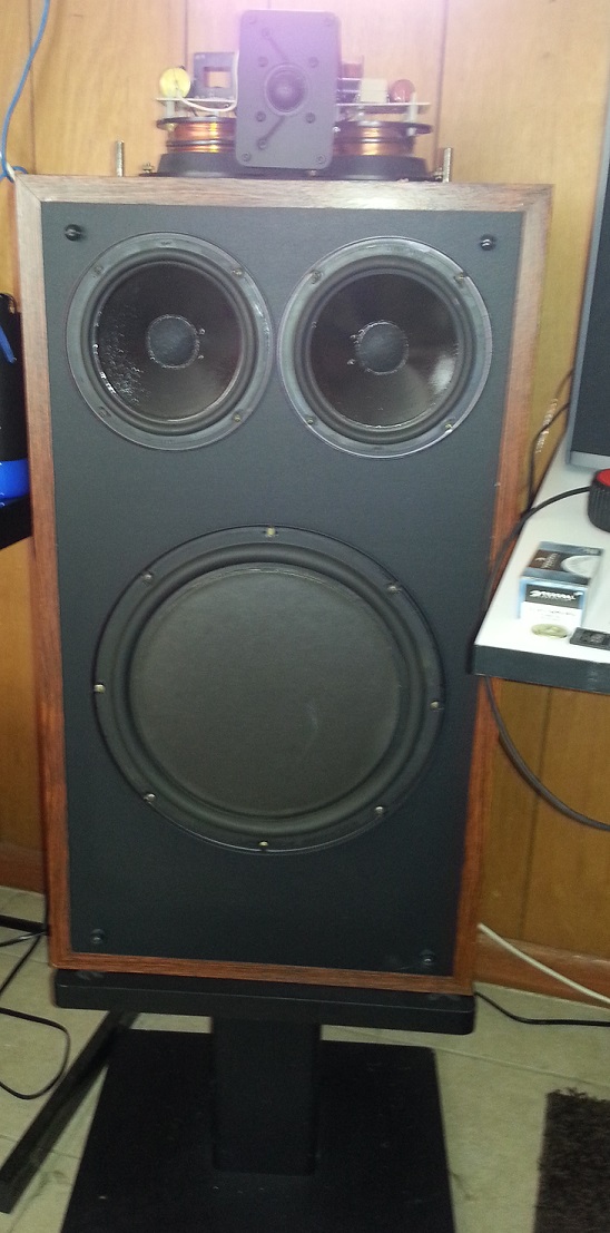

    Thanks guys. Here's a picture of one with the cover off.
    Is this still the preferred way of gluing? Also, do I remove the speakers through the front of the cabinet by removing the screws? Or does the back come off in a way I'm not seeing? The big radiator won't have a magnet, right?

    Yes, you remove the drivers through the front by removing the screws. And no, the big passive radiator won't have a magnet.
    Lots of people around here use the JB Weld and seem to be very happy with it. Others use Loctite epoxy, or some other types of epoxy, with good results also.

    I noticed today that it looks like some of the foam on the face of the woofer is starting to lift a bit at the edge, visible in the picture above, from about 3-4 o'clock. Is this something I can fix? Should I ignore it? They seem to sound just fine, no rattles or harshness that I can hear.
  • westmassguy
    westmassguy Posts: 6,850
    edited March 2014
    That's not a woofer, it's a Passive Radiator. A little Aleene's Tacky Glue applied where it's lifting, should hold it down. Wipe off any excess with a damp cloth.

    ? Are those speakers stable on those stand. I had a friend who had same ones & they were quite heavy IIRC. It may be the the pic makes them look ?able. Maybe cause my head is sideways :smile: Congrats. They look very nice & welcome to club Polk

    They are shockingly stable, and the stands are heavier than I would've expected, and actually, the speakers are a little lighter than I thought they were going to be (the Polk website lists the weight of RTA-12Bs at 75 lbs each I believe). One was a little unstable, but I fixed that with some little rubber feet on the stand. Since I am currently using them connected to my PC (though the Sony), the stands are great, they put the speakers at a nice listening height. I keep forgetting that big thing is passive, not used to having such giant, awesome sounding speakers.

    Got ya on stands. Pic exploded them to looking wider than they are. Those are earlier 12's did they come with hats also-to cover tweets

    BTW, to the OP, the RTA 12s were not meant to be used with stands. I can't tell from the photo, but if the stands are pitched back at all, that would be bad.
    They are totally level. They actually say Polk on the bottom, though I don't know if Polk themselves put that there. Mind if I send you a PM about crossover rebuilds after I get enough posts?
    The base should be about an 1 1/2" as I recall. The tweeters look to be way too high on the stands. The design was for real time array AKA RTA. The stands would mess with that.

    The top of the tweeter is currently 45 1/2" off the floor on the stands. Should I try them on the floor? I feel like they'll be lower than the desk they're next to at the moment.

    The original RTA12's are suppose to be on stands. The later RTA12's have their own "stand" built into the bottom, unlike the flat bottomed originals.

    I see that now. Seems odd that the tweeters end up being that high, compared to the 12 B/C
