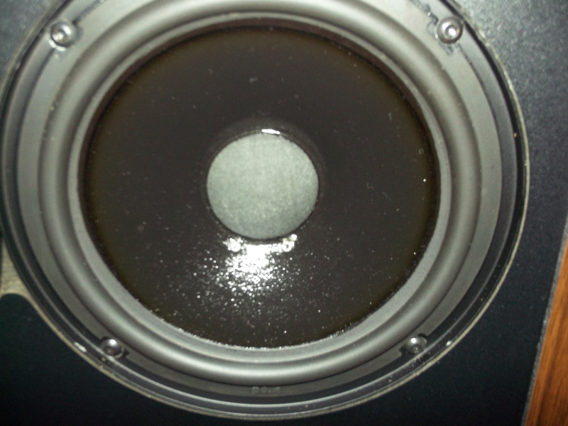

  • westmassguy
    westmassguy Posts: 6,850
    edited February 2014
    Here's two examples, an older MW6500 with felt dust cap, and newer 6510 with mesh:
    Home Theater/2 Channel:
    dhsspeakerservice.com/
  • leftwinger57
    leftwinger57 Posts: 2,917
    Looks like from your pix mine is the 1st one. I did your flashligh test and it is the smallest mesh screen I'd ever seen.There does not seem to be any coating on them and the pole I just couldn't see,maybe when it gets darker I'll notice the pole. So the right side w/ little movement would be considered the leakery side. The throw again on the mids of other side does extend pretty damn far but clearly does not take all that long to decompress back. I asked this on anonther thread but you how one does a draft test in your house to see where you have gaps at doors and windows, anyone invent such a test for these speakers so you don't have regasket all the speakers.
