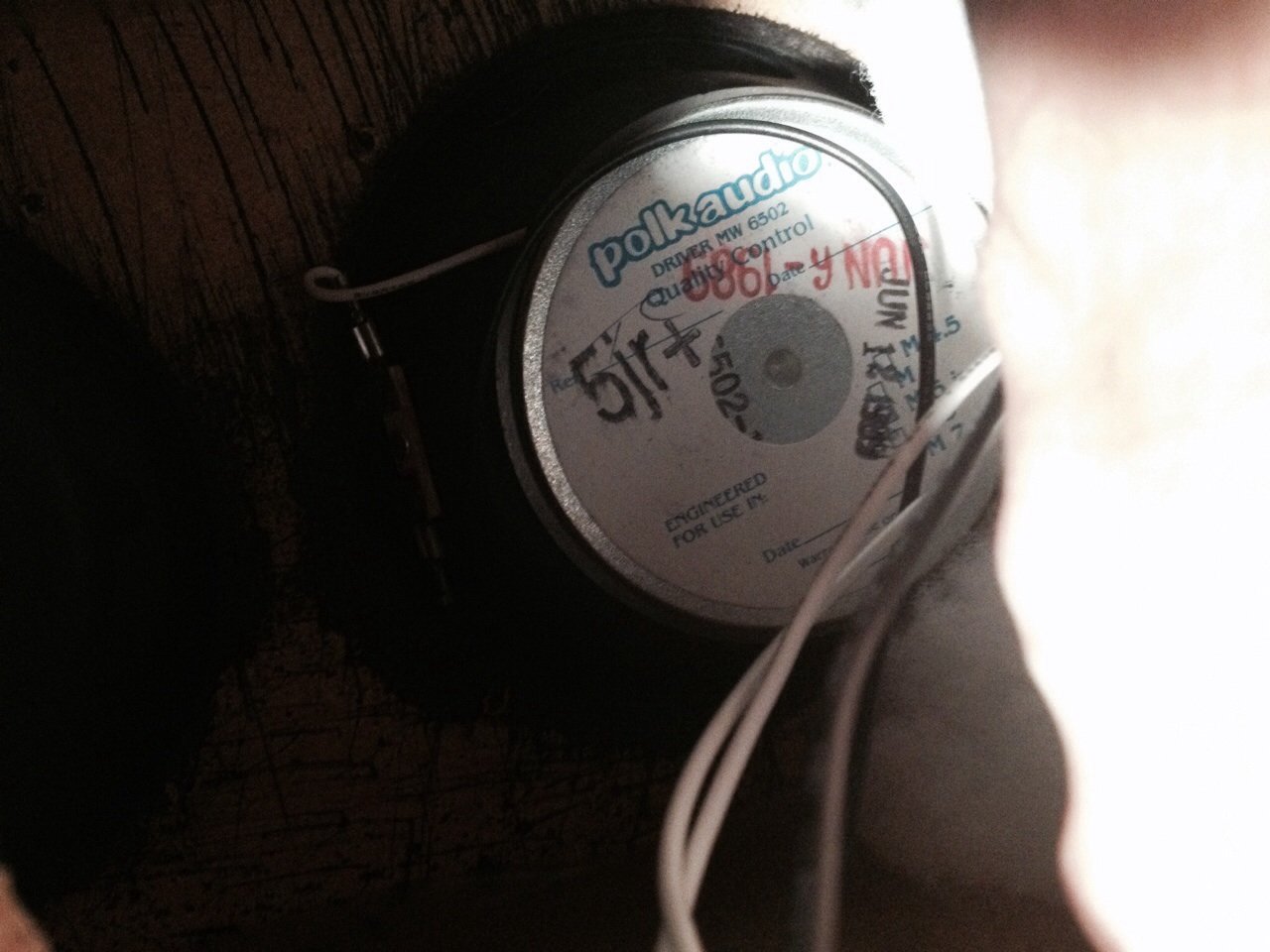

    Thanks fir the replies, ill call polk audio tomorrow and will place an order. By the way, my speakers are the 5jr. The 5jr+ have a bigger passive radiator, I think.

    cortico wrote: »
    No. The 5jr has no passive, it is a ported design. Yours are 5jr+s.

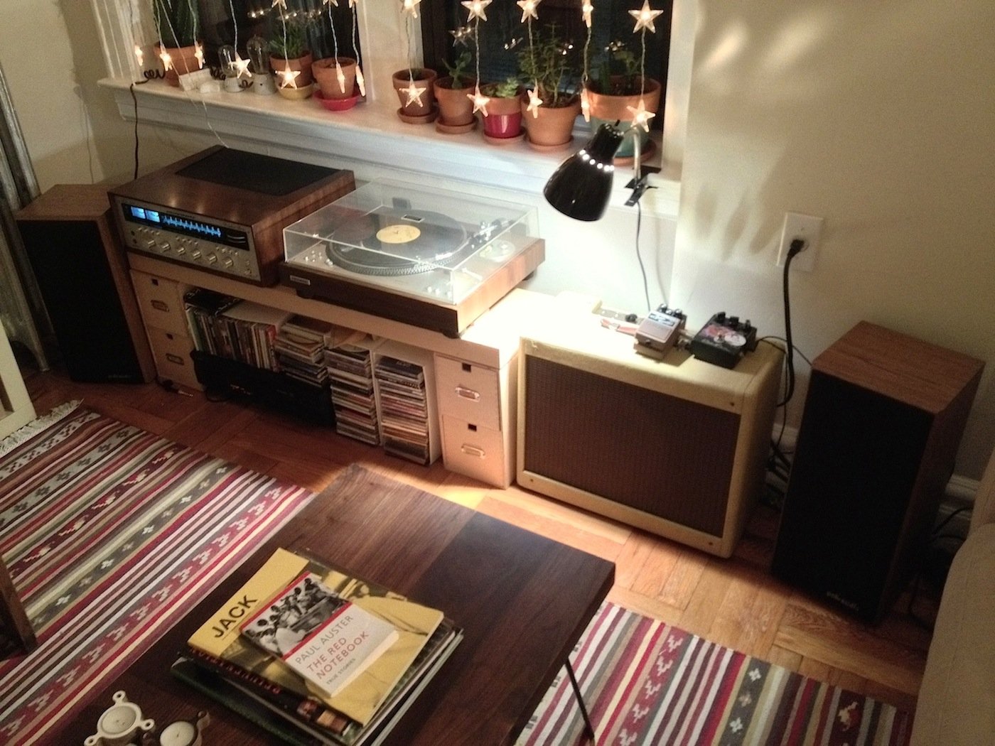

    The grills are upside down. ;)

    Big Dawg wrote: »
    Only the earliest 5jr versions were ported. Later 5jr and 5jr+ models BOTH had a 6-1/2" PR.

    Nightfall wrote: »
    True that. Give the grilles a 180-degree rotation so the emblems are in the lower right corner and (of course!) turn the emblems so they read properly when they're repositioned.

    Big Dawg wrote: »
    I have some 5jr that look just like those also-i also have the 5jr+'s..... Both have tags on back also ???? There may be a 5jr with port also ???? Agree with the RDO vs Peerless. From what ive been told the RDO is as good if not better. Tho ive never switched mine out

  • cortico
    cortico Posts: 587
    edited January 2014
    Big Dawg wrote: »
    teekay0007 wrote: »
    Thanks for clarifying! I have attached the serial picture

    Nightfall wrote: »
    teekay0007 wrote: »
    Thanks! The speaker do sound sweet on the Marantz. Probably, the drifted caps are doing their magic :). Anyway, I had to kick back the Treble one notch to center, the Bass is one center and the Mid is one past center and loudness on, and both high/low pass filters are off.
    I only listen at low volumes, have to admit that I was happy with the Monitor 4 series 2 that I still own. Then someone told me that I should get better speakers to match the receiver. Is not a great step up, but there's a difference. The Monitor 5 have a punchier sound and more presence.
    Here is a pic of my rig. I have turned the grille around, it was looking off…

    cortico, get those speakers up off the ground - preferably to about tweeters at ear level when in your favorite comfy listening chair - on some stands, with a slight back tilt if possible, and they will sound ever so much better.

    He is right Google you speakers then click at top, Images
    and you have a wonderful beautiful PL530(?)570 I might add!
    What Cartridge?

    I have looking inside, to check the year of manufacturing 1989 there's a jr+ stamp on the magnets:

    The MW6502 is used in alot of the Monitor speakers & can be switched out which is a big plus- http://www.polkaudio.com/forums/showthread.php?38755-POLK-AUDIO-Speaker-Wiring-Schematics-amp-More-ALL-MODELS-except-SDA

    Nice setup. Getting those speakers up on stands and tilted back a bit will really make you say WOW!

    Got this on the bay, they raise the speaker 9" above floor. that puts that more or less at listening position ear height.

    I've had those before, be careful the rods don't pull out of the foam tubes while you're setting them up.

    Interesting stands-those will work alot better than the floor. You should notice a big difference hearing the tweeters at your ears

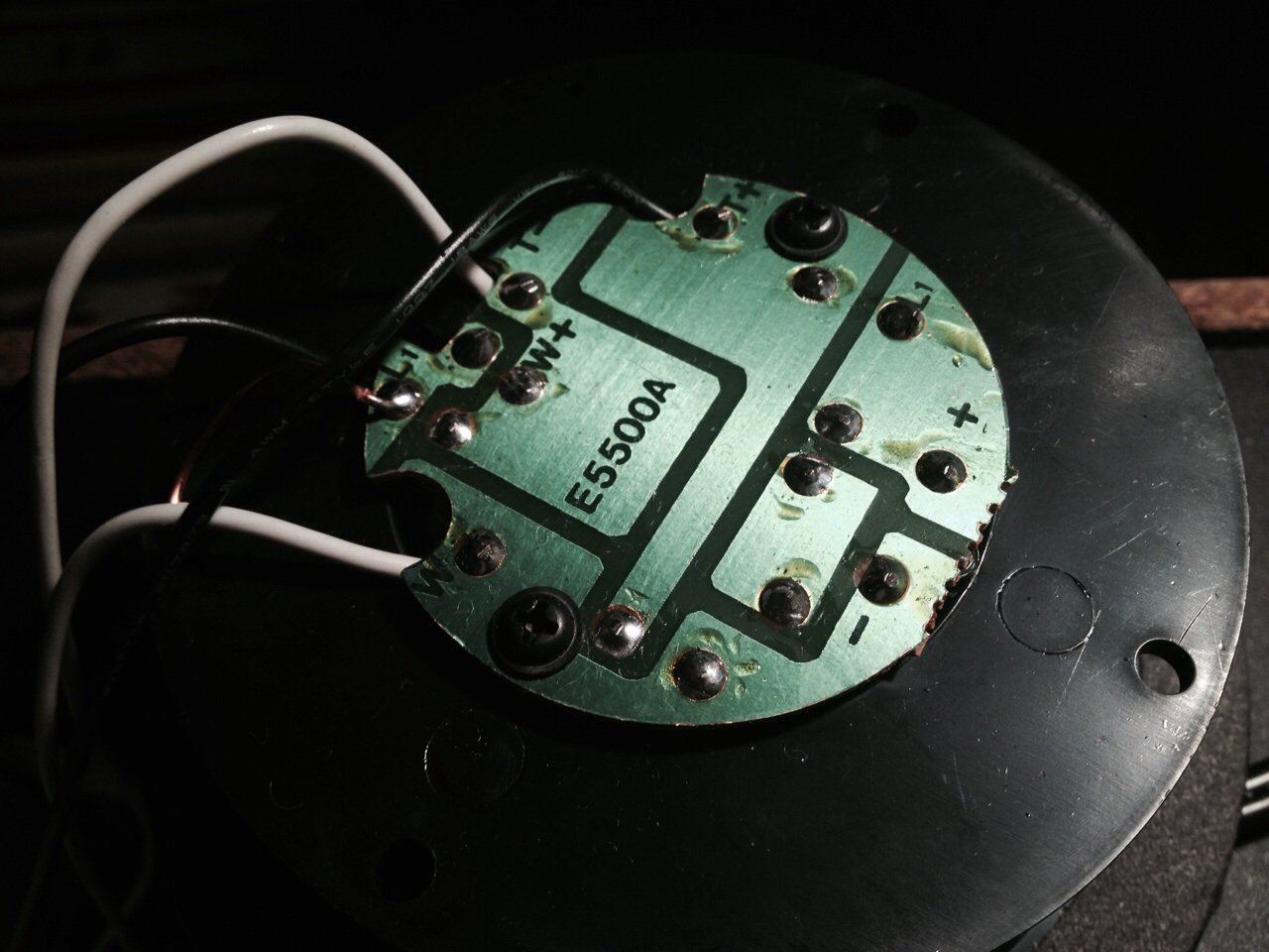

    Just to be sure you are getting the right tweeter, (get them in pairs and replace both) the RD0194 is the replacement for the tweeter pictured (SL2000). The RD0198, is preferred but requires the aforementioned change in the crossover capacitor from 12uF to 13.5uF. Later model 5jr+'s had a black tweeter with a foam ring around them (SL2500). These already have the 13.5uF cap, and the RD0198 is the proper replacement.
