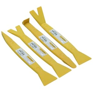

    If these are like other Polk speakers from recent years, they are designed to be assembled quick and easy. So that would me that they should be easy to dissasemble. The "beauty rings" that the LSiM are become more and more common. Most are just press/lock fit and are easy to remove. If you don't have on, get yourseld a plastic/nylon pry bar like these used in this kit:
    Can find them cheap on eBay, Amazon, or a local store.
