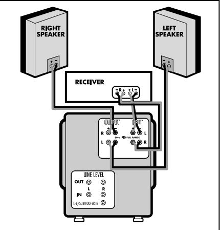

Really what you need it a way to test either the sub or the receiver. Since your receiver has preouts you could try plugging the sub into something else (maybe center) to see if you get any audio on a low setting. That's the only way to test it I can think of without actually testing with different equipment. You don't mention your sub model, but if it supports high voltage input you can run some speaker wire from the outputs on the receiver from that to test.
Hope you figure it out. Good luck.
Edit: Missed your sig, your sub does have speaker level inputs, so give those a shot instead, if it still doesn't play it's like the amp on the sub. -

I know its a bummer but...
You can always run the sub using speaker out of AVR and manually adjust crossover
Good luck2-channel: Modwright KWI-200 Integrated, Dynaudio C1-II Signatures
Yeah I've considered that as well. Im thinking that at this point Im not gonna spend anymore cash and when I decide to use the Pioneer AVR again I'm just gonna do that .^^My Set-Up:
