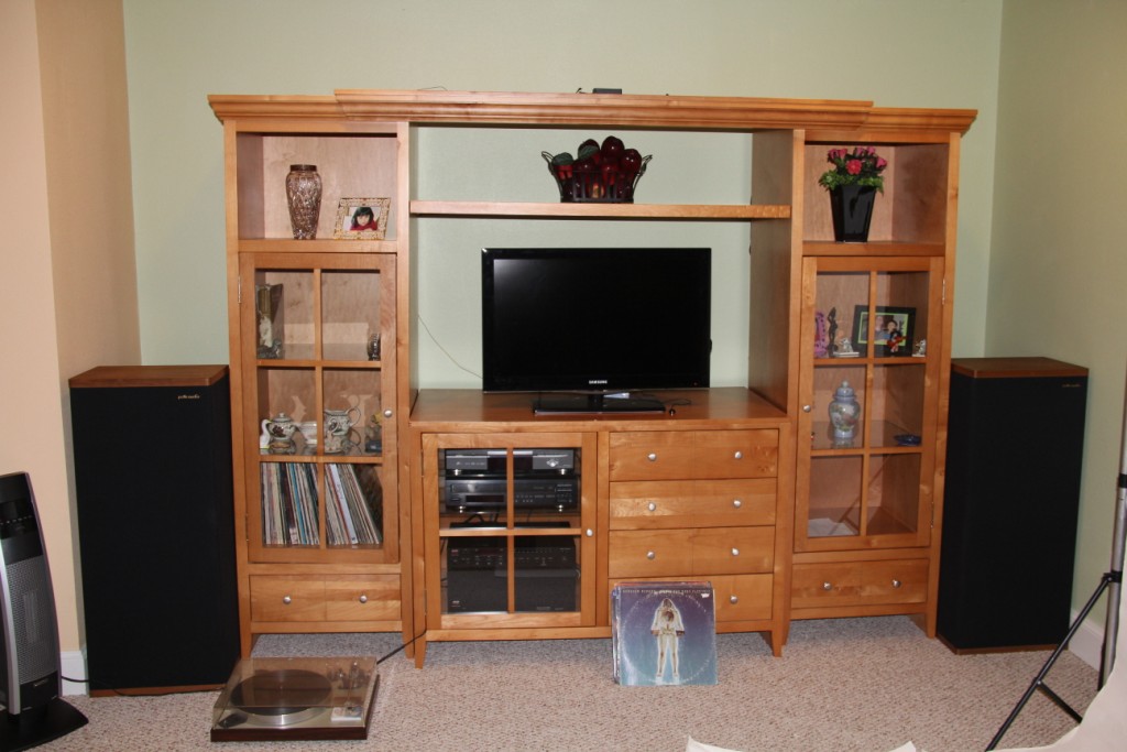

    Congrats, you will love those speakers. Yes, placement is an issue for you, the way you have them set is far from ideal. But what's even worse than your speaker placement is your turntable placement :eek:!!!
  • normac
    normac Posts: 13
    edited December 2013
    You need a bigger TV. Just sayin....Jk, welcome to CP. Check your wallet at the door!
    The one large TV we have is in the living room. This entertainment piece, in the living room and shown below, also houses my original SDA CRS+ (with RDO-194s). I imagine placement is killing much of the sound, even though they still sound good inside the cabinet. I have placed the CRS+s on rubber "potriser" insulating pads, used to raised outdoor planters off wooden decks. This has definitely helped reduce vibration and sound dispersion. Let me know if you have any other ideas for improving sound from this type of a setup. Unfortunately, given the available space, I cannot mount them on external stands, hence the to be finished setup with the 2Bs.
    But anyway, you're correct, a larger TV would be more pleasing. Its a work in process. Mods on the 2bs are the priority!
  • normac
    normac Posts: 13
    I just pulled this Luxman turntable out of storage along with the remnants of my aged record collection. For kicks I thought I would hook it up and see what these old records sounded like on the new (for me) system. Much to my delight for the most part they were a joy to listen to. Not many scratched, blips or pops. Someone must have been careful with them, thankfully. Yeah, I know the turntable should get off the floor. Give me a few pointers on turntable placement and care, etc, as I see records will remain a portion of my library. Thanks!
