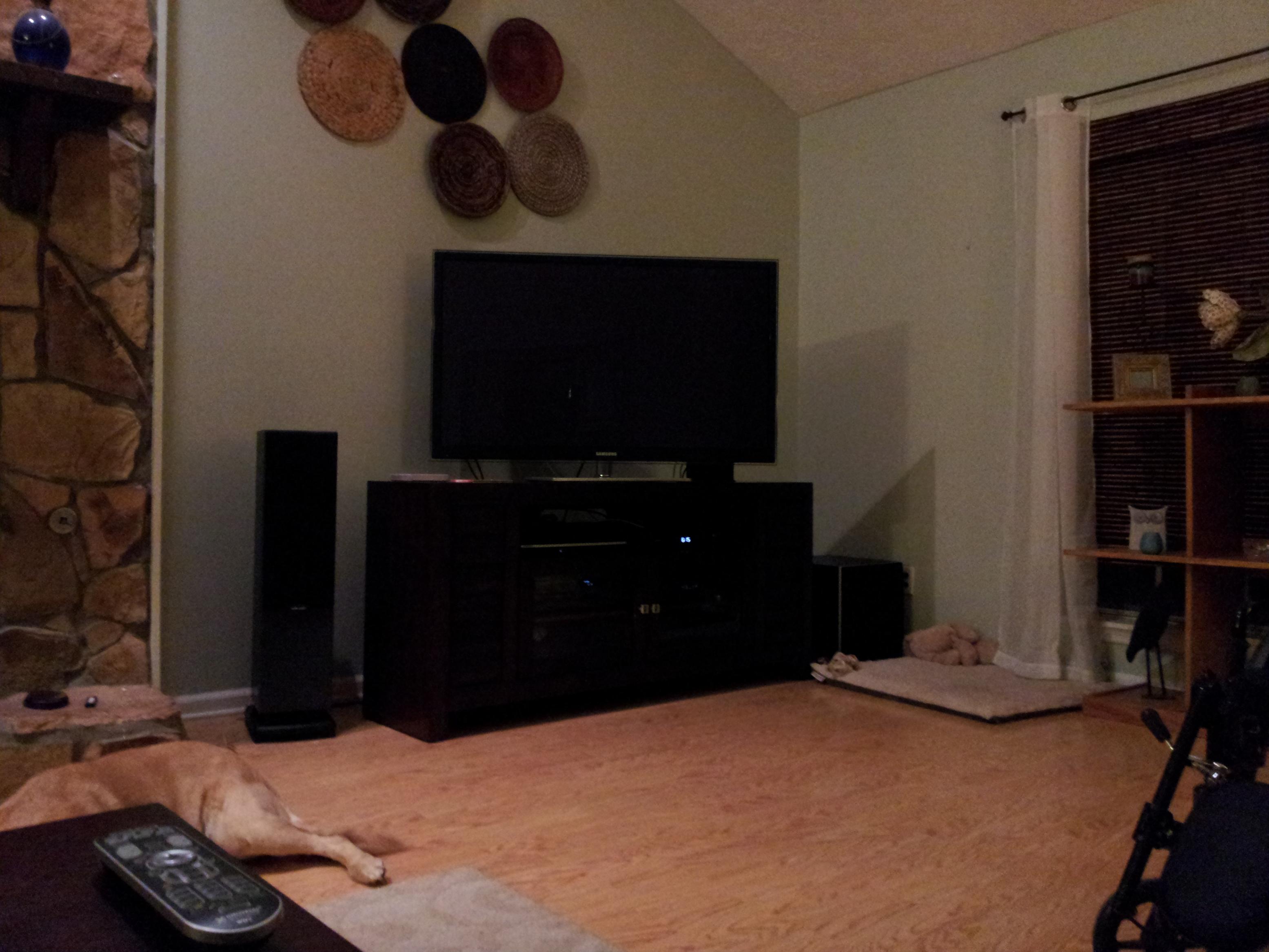

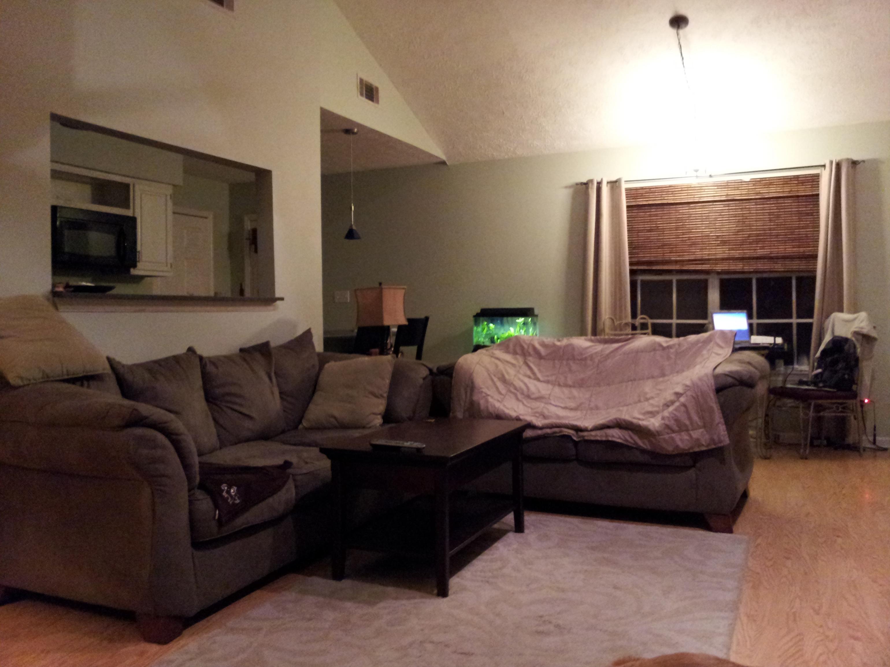

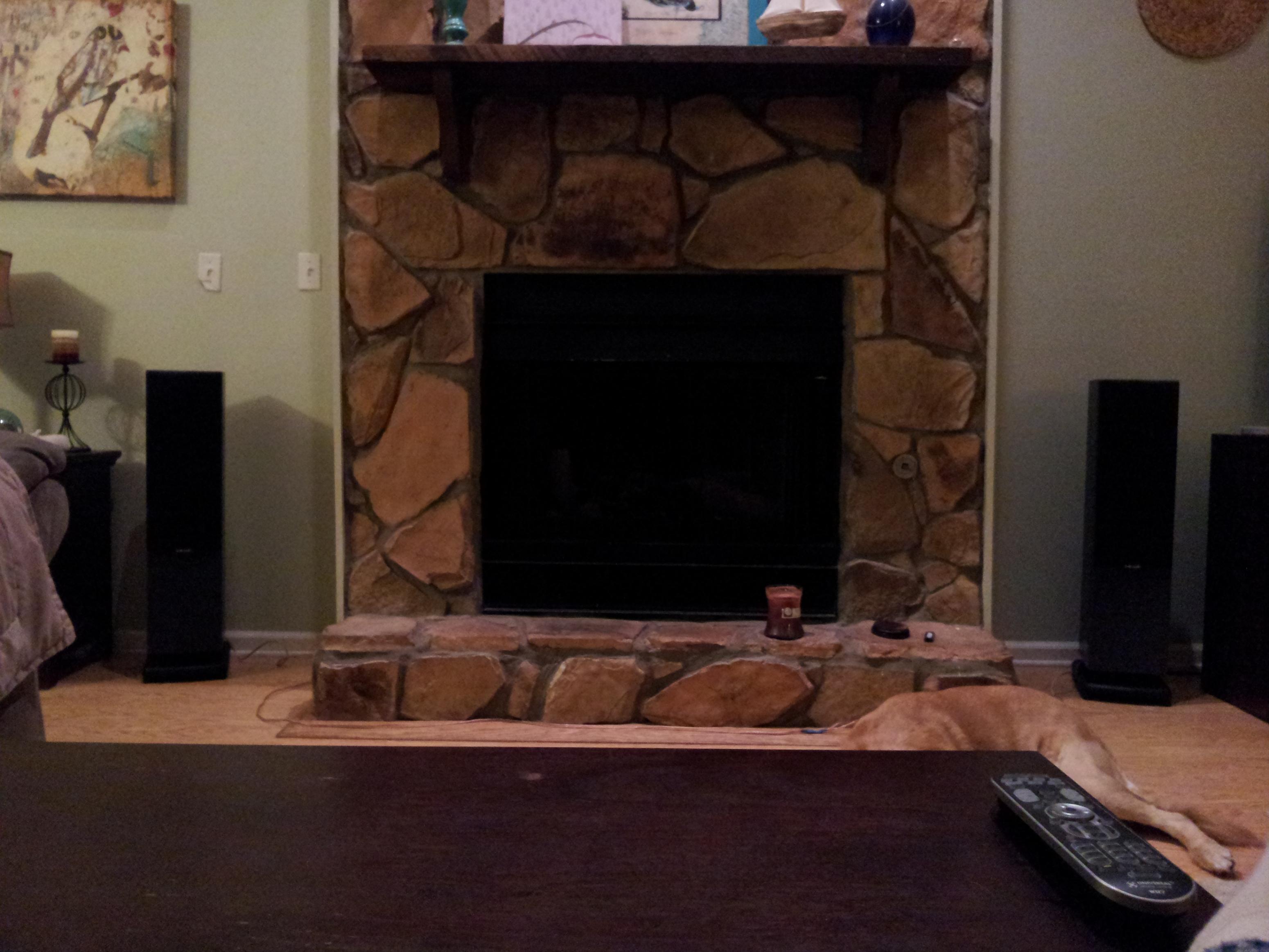

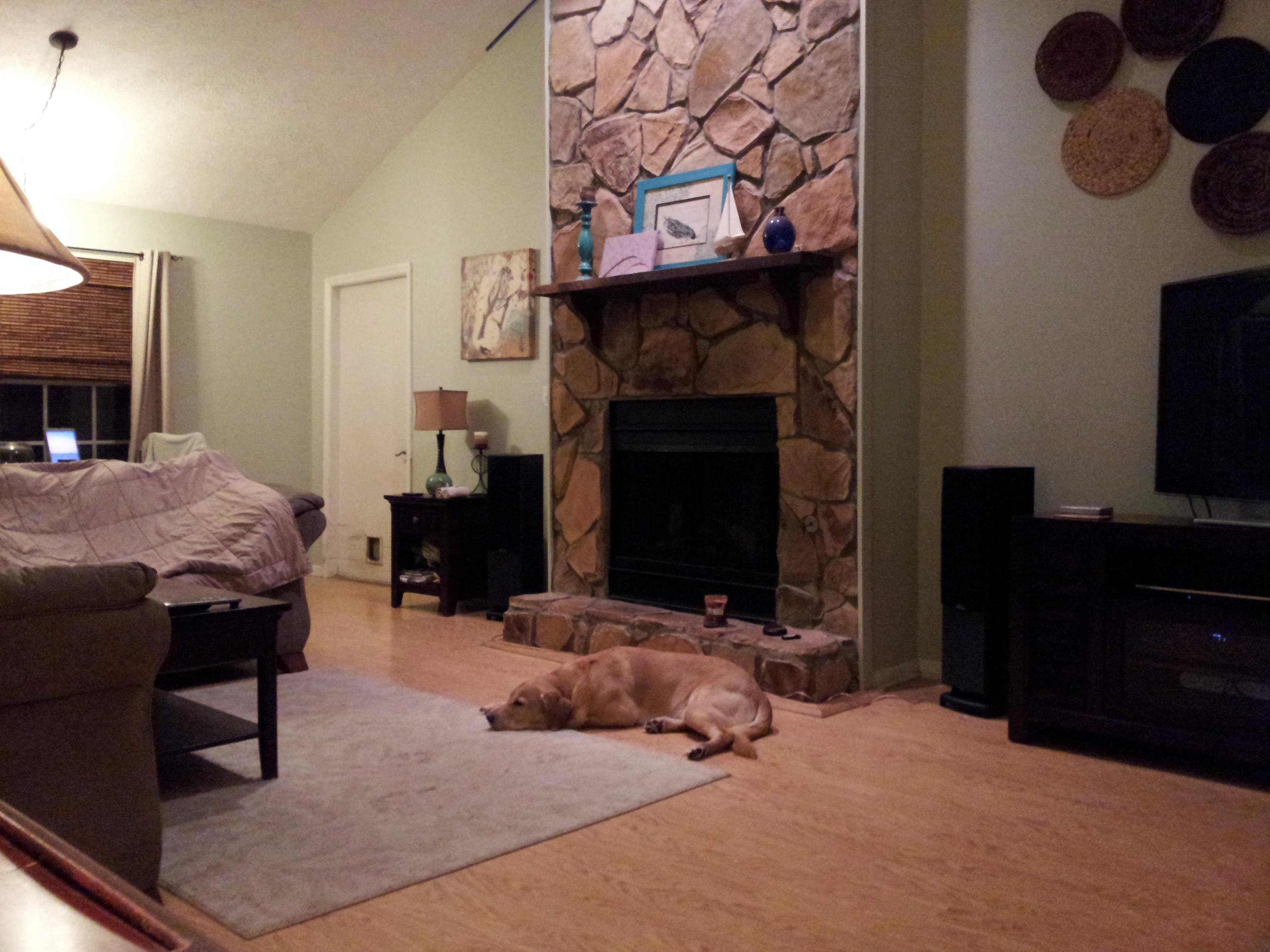

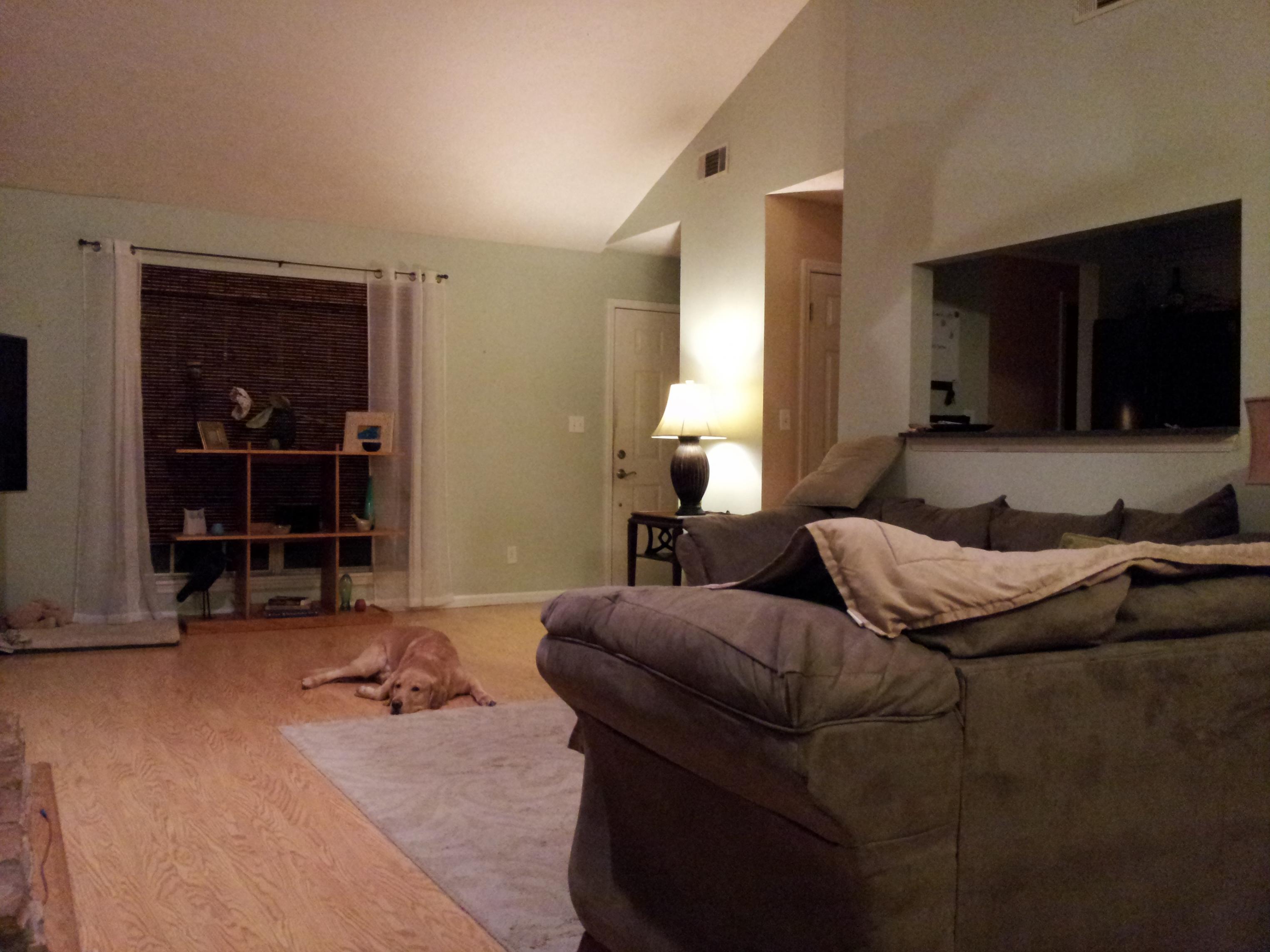

    Here are pictures of my listening area, as requested.
    This is the view from my listening position.
    This is looking at the listening position from the right corner.
    This is looking from the right rear corner.
    Looking right from the listening position at the sub and right speaker.
    Looking from the left front corner.
    The room is pretty big. Clearly to big for the single 12" sub.

    As other have mentioned it looks like you have a lot of reflective surfaces. These will all affect the sound to some degree.
    Room looks very cozy and your dog is beautiful. Does he/she sing along with you music like mine?

    tonyb Posts: 33,068
    edited November 2013
    Alan,
    Pics...good man. Some suggestions aside from the receiver F1nut mentioned, pull those speakers away from the wall a good 6 inches and if you can move that sub to the opposite side of the fireplace....at least the opposite side of the rack, it's too far off as is.
    Fireplaces always present a challenge for audio, I have the same problem, which I still am struggling with myself....and the wife. Have you thought about re-arranging the room ? Maybe put the system in front by the window ?
