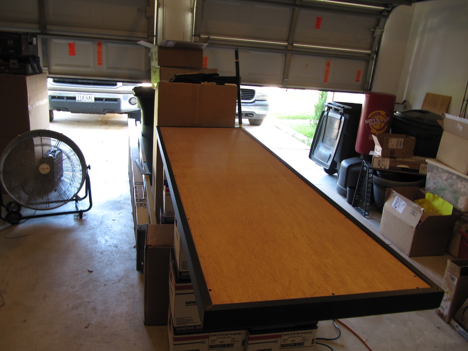

Here are examples of my panels using the same material. My Dynaudio's are rear ported and when placed to close to the wall like at LSAF they tend to sound boomy. The panels help tighten and produce clean bass.2-channel: Modwright KWI-200 Integrated, Dynaudio C1-II Signatures
Thanks for posting the pictures. Those turned out very nice! Did you use Owens Corning insulation as a back to some of your panels and wood for others? If I did this, I hadn't planned on putting a back on them, I was going to use a couple slats on the back to hold the insulation in place and to staple the fabric to. And use a couple braces to keep the panel square and use plywood or leftover baseboards for the frames. I was also trying to keep the weight down on each panel because I was going to try and hang them like a picture. Is it flimsy enough to where I'll have to put a full back on it? I've read that you are supposed to keep it a couple inches away from the wall. Does having plywood in the back change how it works as a sound absorption panel or is it a non-issue?
I would use cloth as a backing not plywood because then the more you space then off the wall the better they work.Absolute corruption empowers absolutely.

I think I just figured out one of my questions...he's got plywood on the back, Owens Corning on the front, Quiet Batt in the middle. It came to me in a dream. I might just wait until I find some fiberglass...I don't know.
Back to sleep now. -
The plywood backing is thin and light, same plywood used as the backing in most entertainment systems. Staples penetrate like butter.

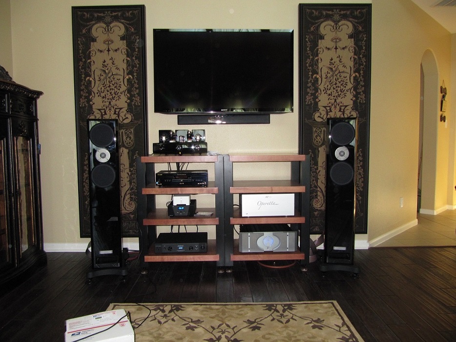

Here are a couple WAF panels in my living room system using tapestry. The insulation is very dense and heavier that all the wood frame put together.
Those are impressive looking! Nice match to the floor rug.
Thanks, unfortunately they were not cost effective, but paid off in the long run with sound a were wife approved "happy wife, happy life"2-channel: Modwright KWI-200 Integrated, Dynaudio C1-II Signatures
