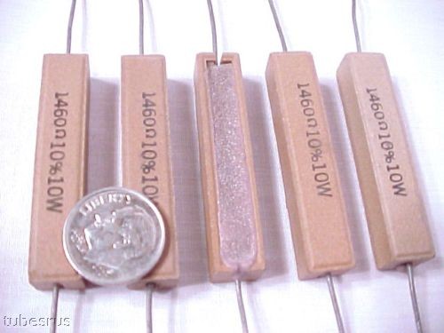

  • Glen B
    Glen B Posts: 269
    edited September 2013
    Thanks, I have no idea what the other sand cast resistor is but according to Gimpod's schematic there is a resistor to do away w/ and just add a jumper ?
    Its the upright mounted resistor next to the empty "C5" slot on the board. You can't miss a sand cast resistor. The case looks like its cast in sand, just as its name implies.
  • leftwinger57
    leftwinger57 Posts: 2,917
    Now that it's pointed out it's pretty obvious what a sc resistor is lol. What value of resistor is to be used in it's place or the same value that's shown in your post? I guess I could refer back to the schematic also.....
