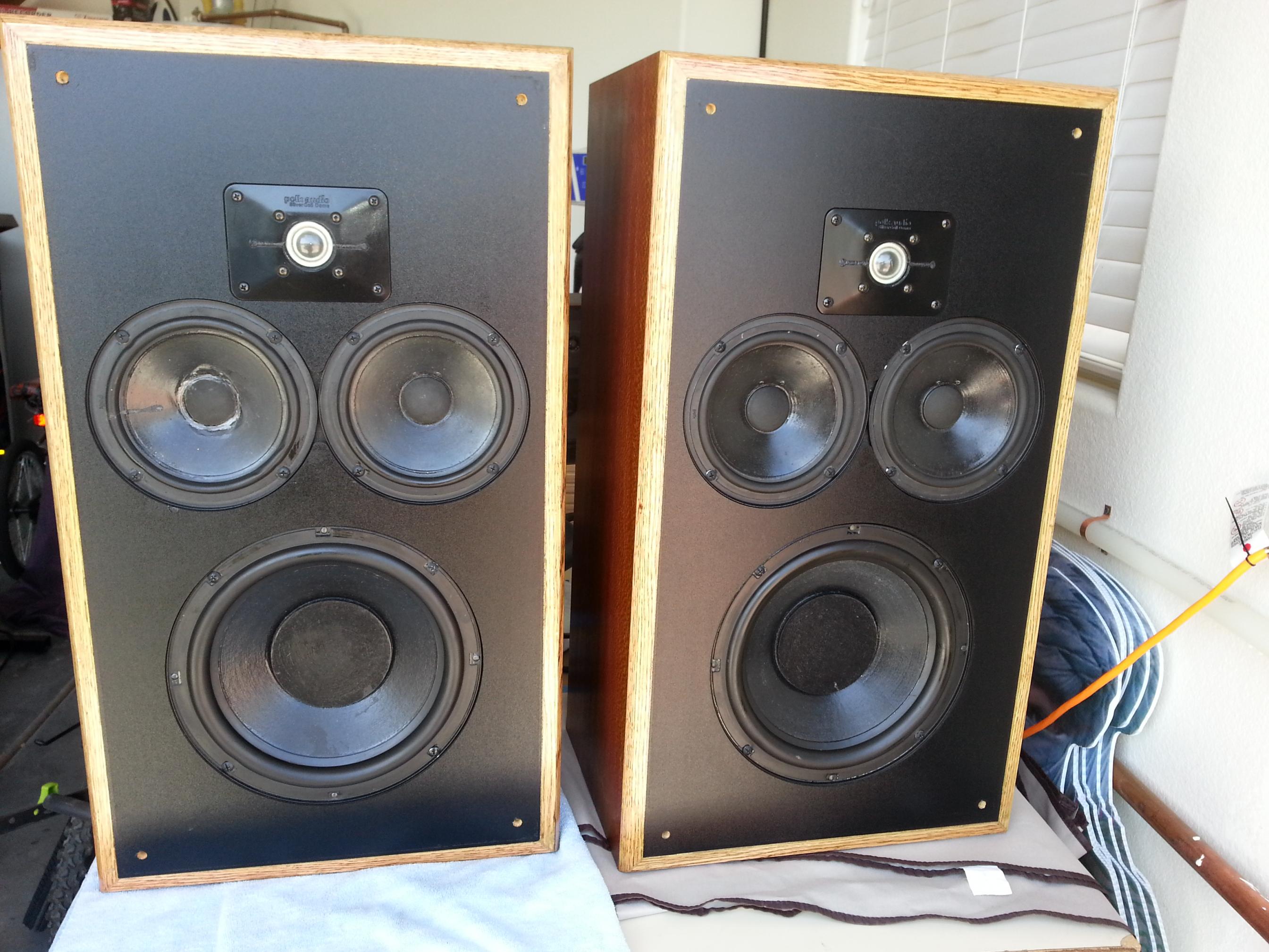

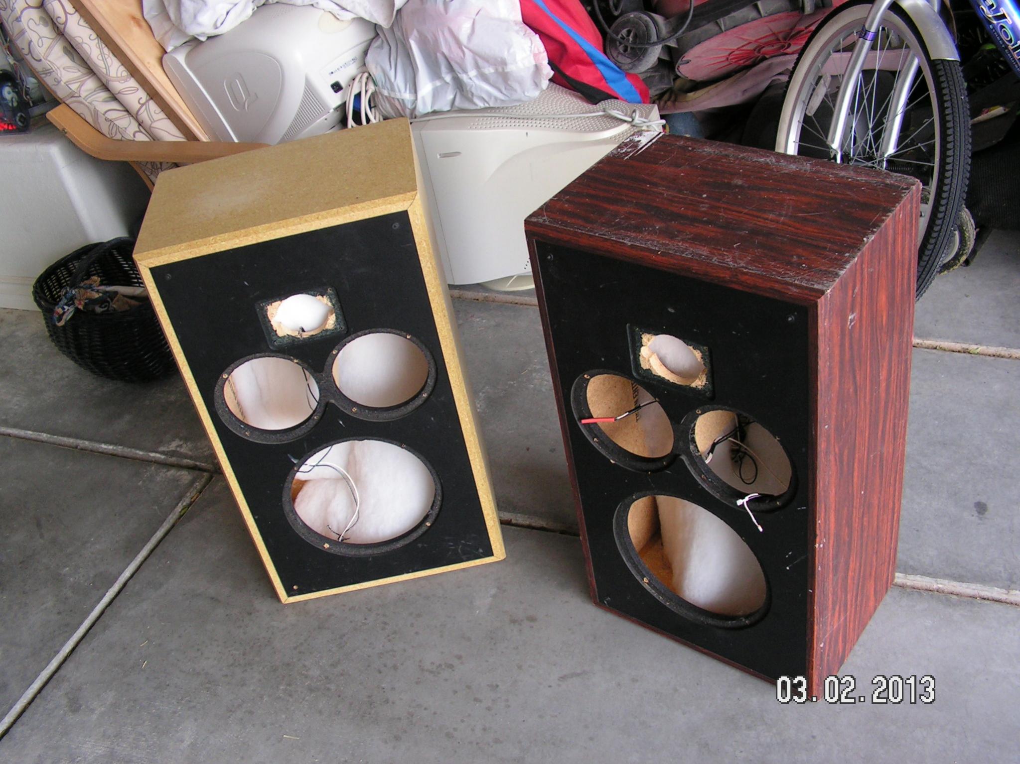

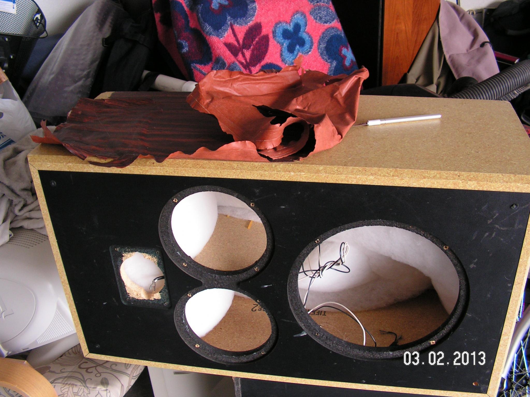

Hi there guys,

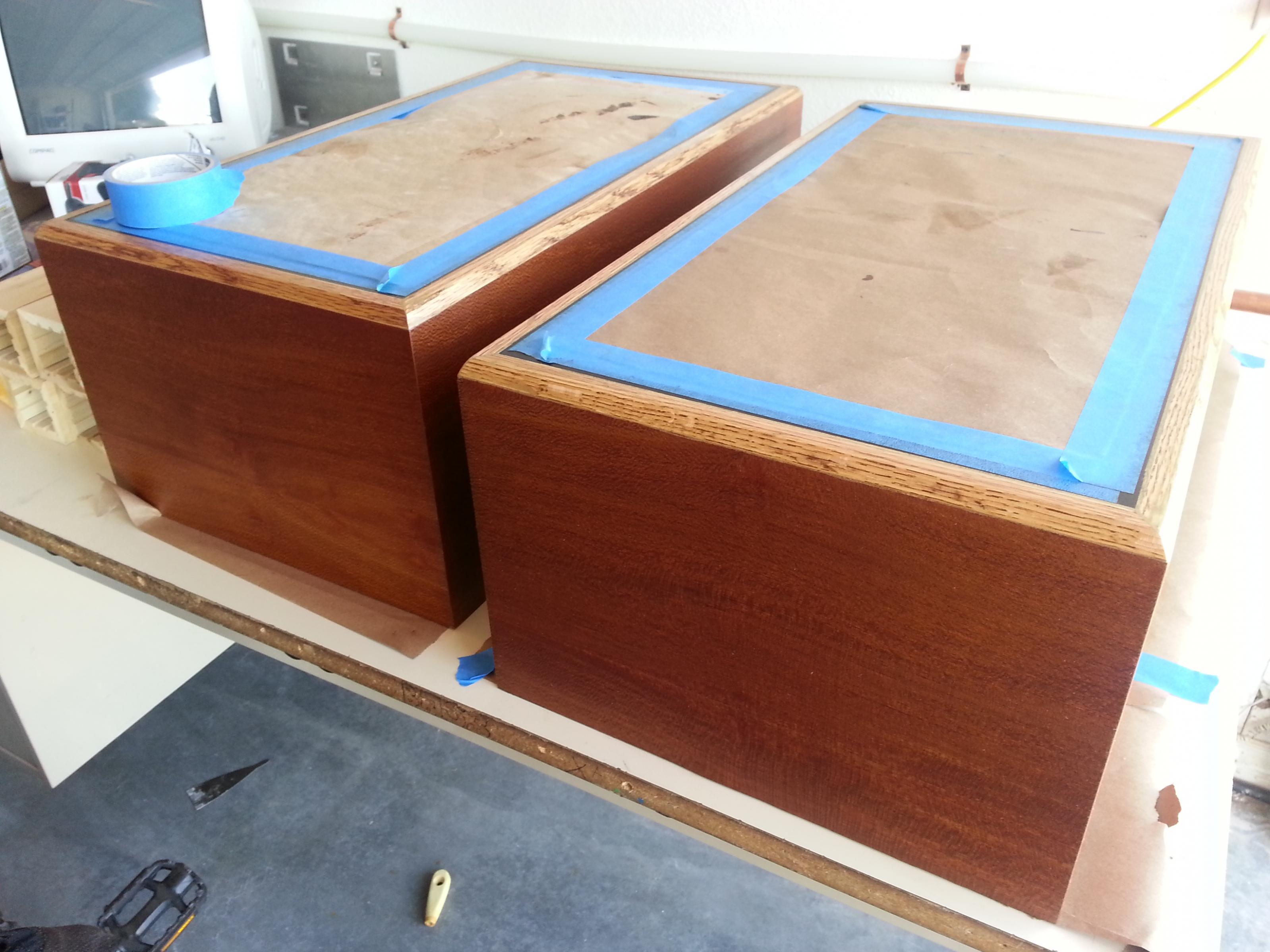

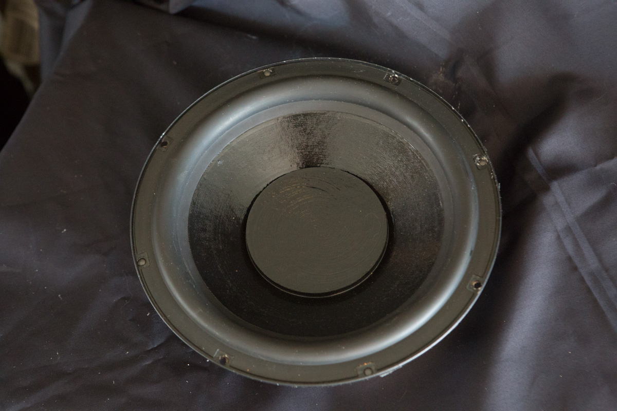

I have been working on restoring a set of monitor 10B's that I received earlier this year. It has been a long road trying to restore these because of work and family etc. Well, I have finally completed them. I only need to make some grills since they did not come with any and were in really bad shape( 3 drivers had shifted magnets etc.) Those will be done in a few weeks, but thought I would post the complete some pics of the completed restoration. I must thank all the members here who helped by answering all my questions and giving me ideas etc.
Here is a link to the restoration thread on AK.
http://www.audiokarma.org/forums/showthread.php?t=505777&highlight=blacksoldier
Thanks again guys.

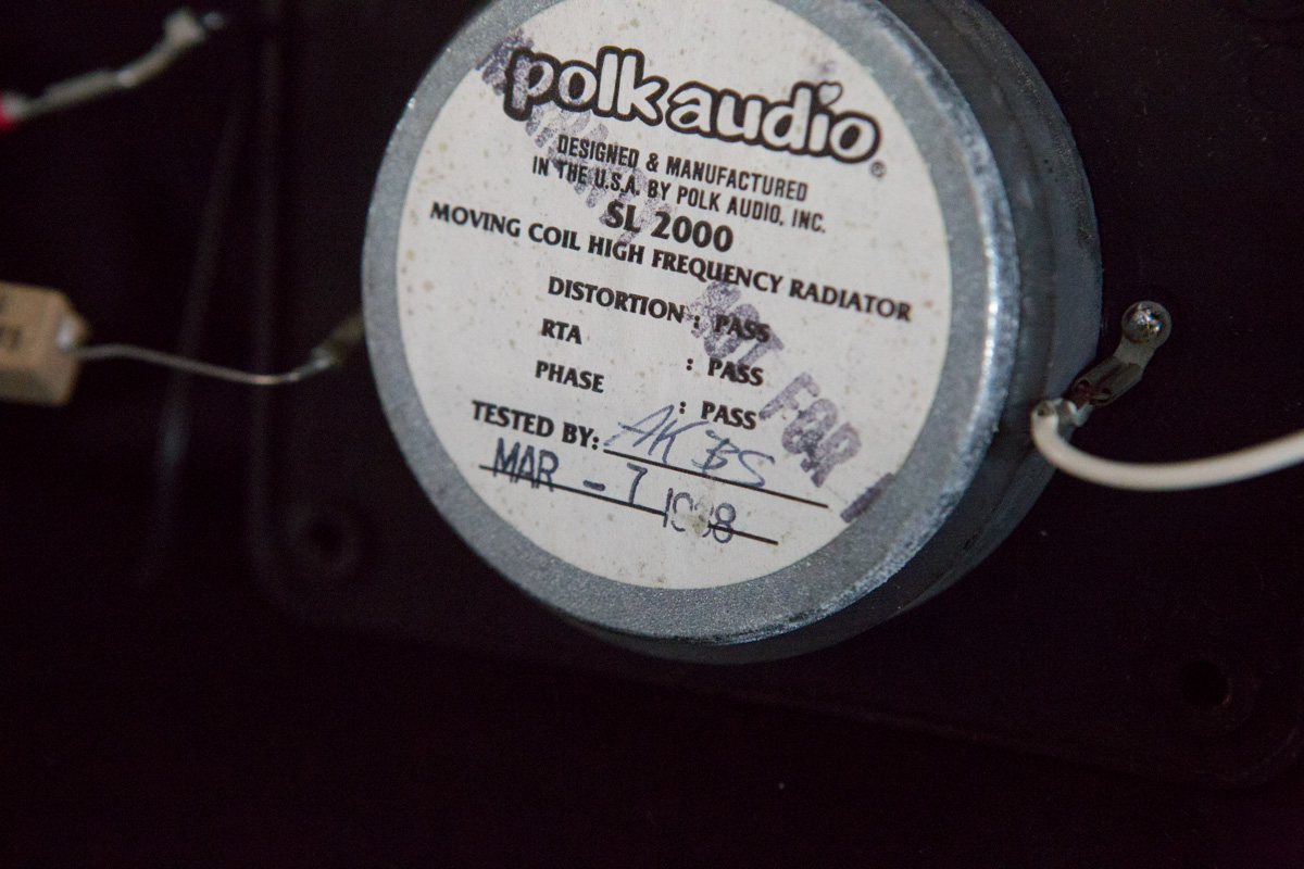

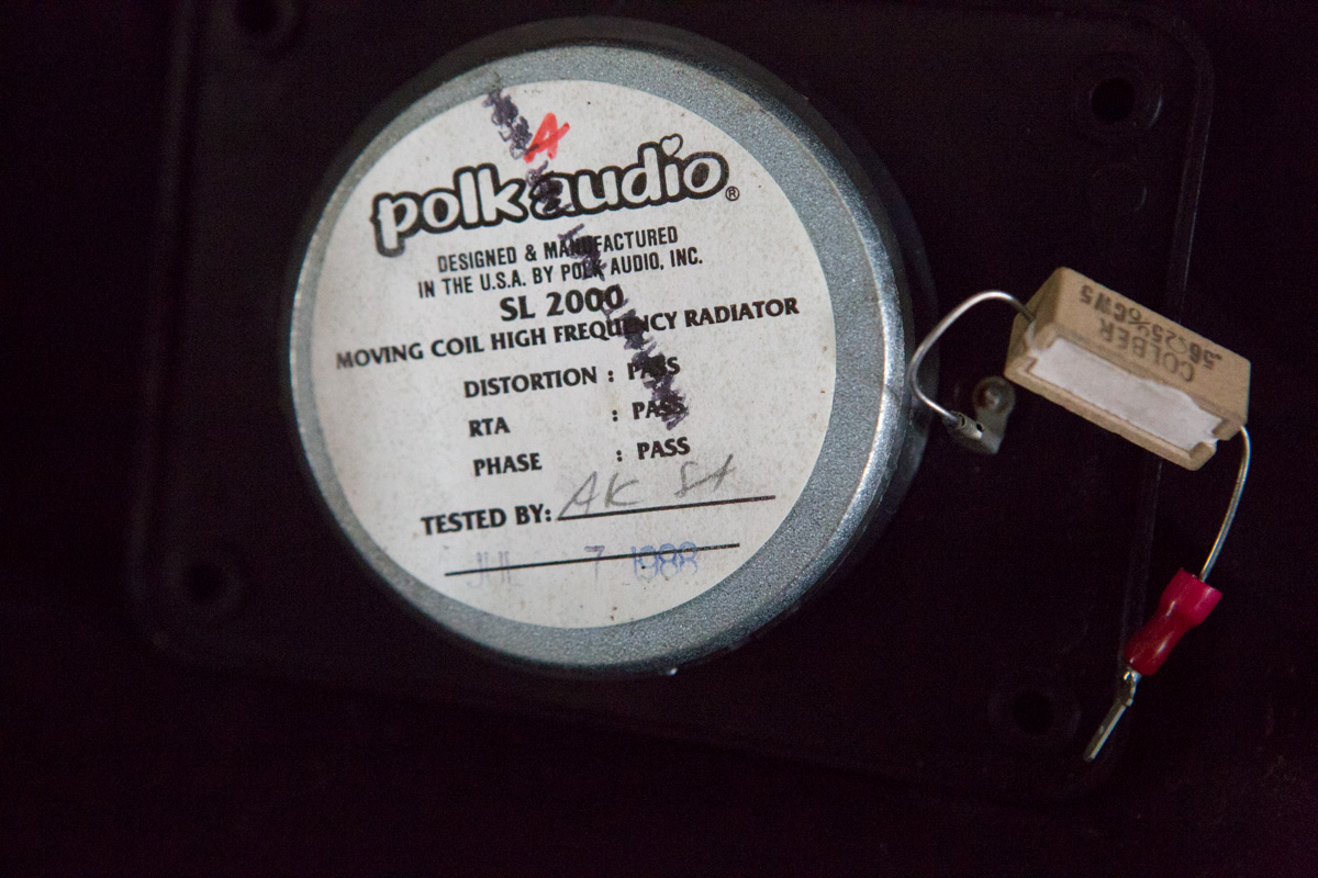

    Nice wood-working! Have you done anything to the inside (e.g. XO's)? I can see you still have the SL2000 tweets.

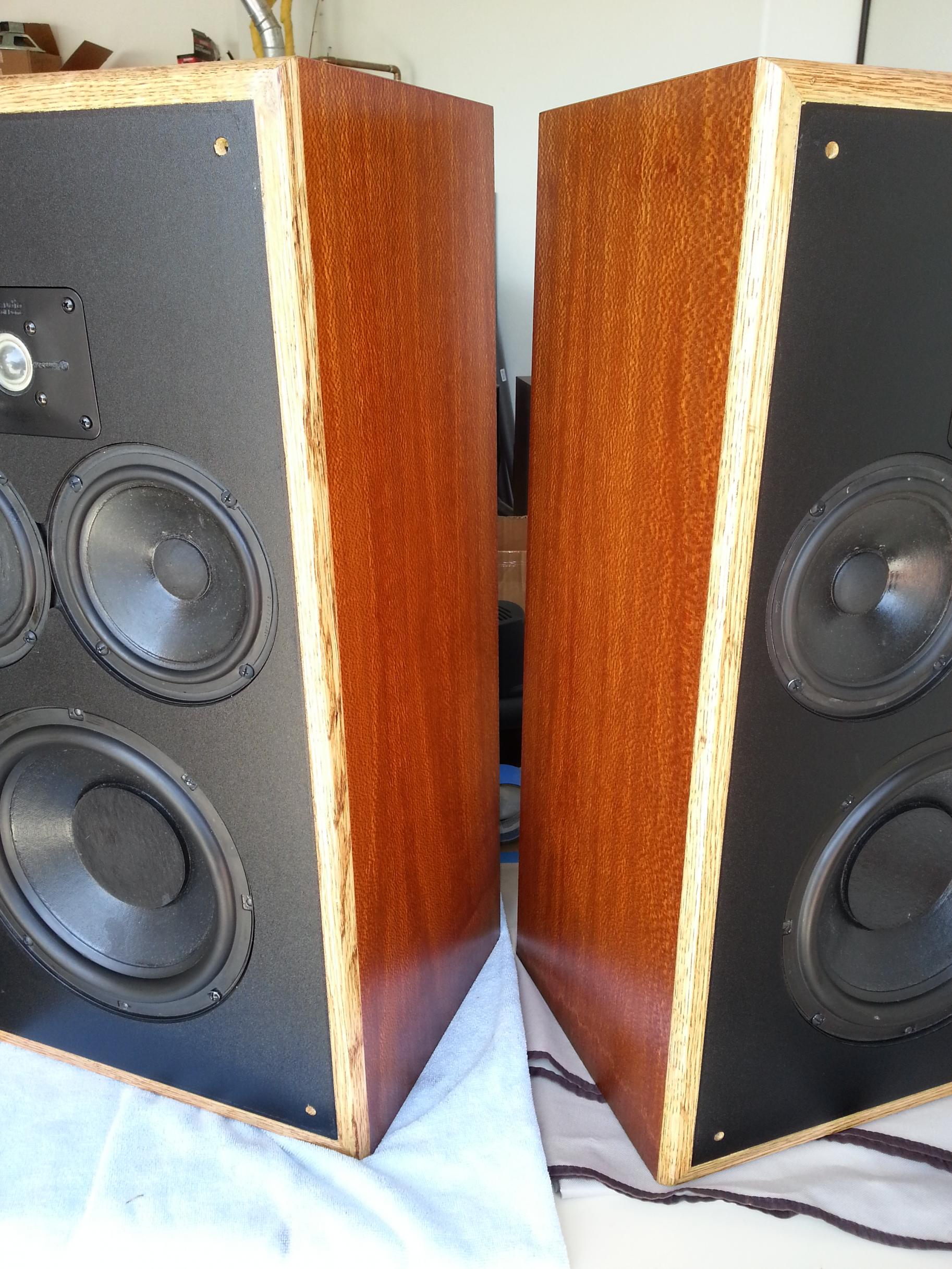

    Is that sapele veneer? The front looks like oak. Nice work!

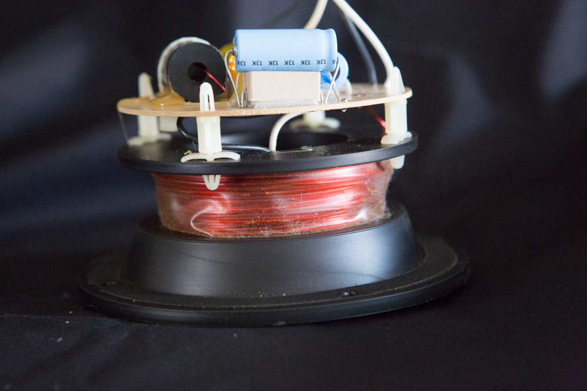

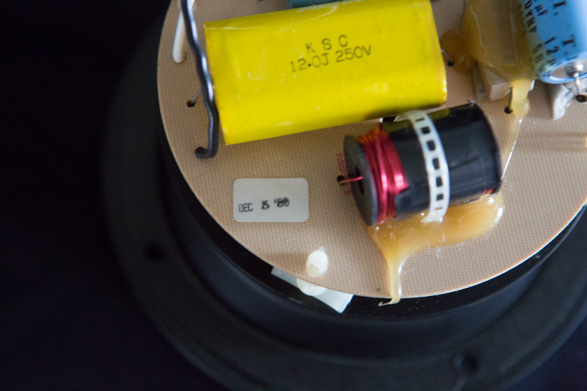

    Thanks a lot guys, I feel very good about how they turned out. Again i picked the brains of quite a few members on this sight about the bad drivers I had and also about redoing my crossovers. I got a lot of great useful information that helped me a lot. Thanks again everyone.
    DSkip wrote: »
    Looking good man. Congrats on a successful project. But, um.... that restoration isn't done yet. Have you done any mods to improve the sound yet?

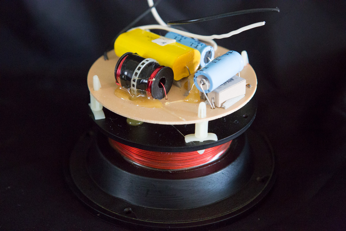

    Thanks DSkip, yes, I have used dynamat on all the drivers and the passive subwoofer, redid the crossovers using Mills resistors and film caps, glued magnets and also ensured that the enclosures were properly sealed.
    StantonZ wrote: »

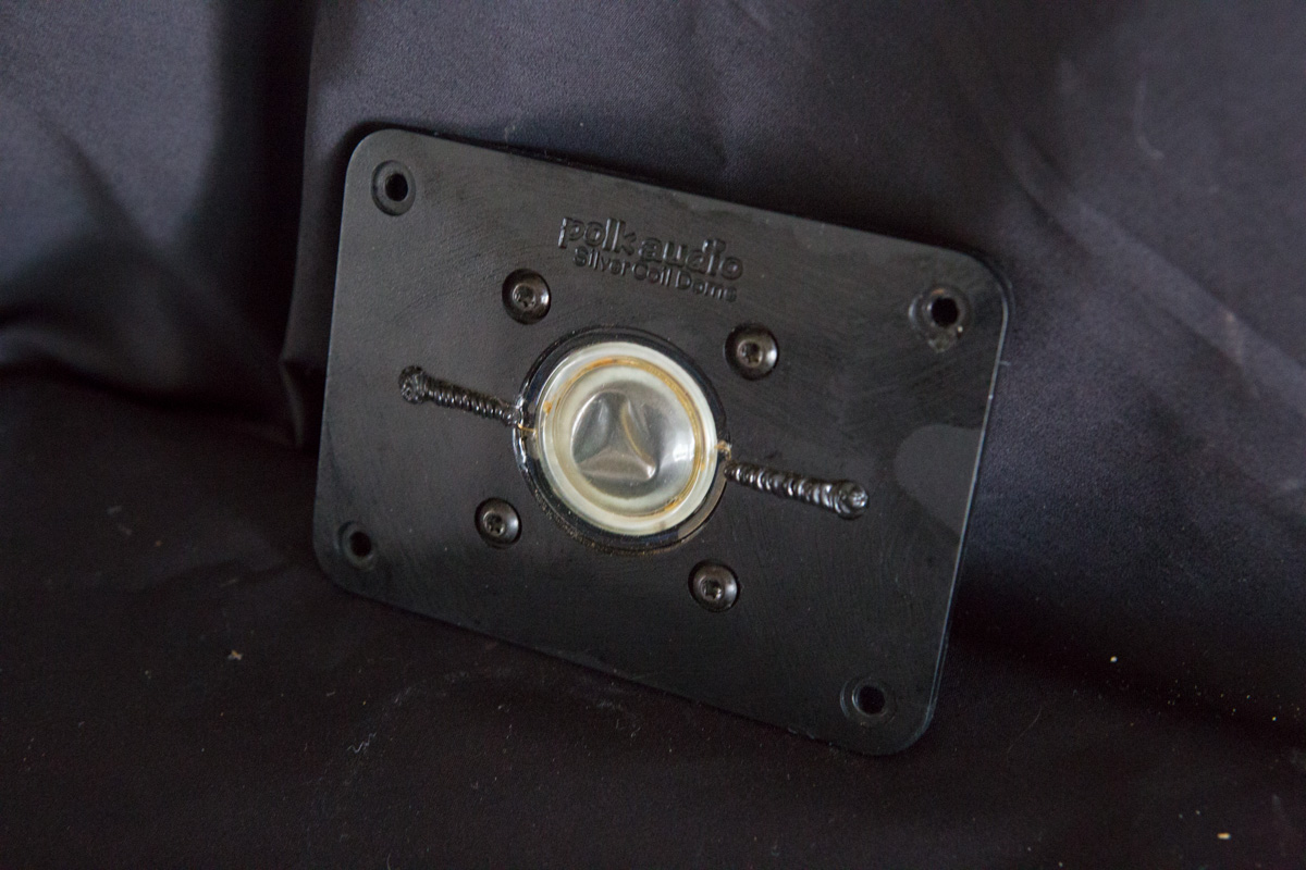

    Thanks StantonZ, this was my first time doing anything like this and I am very impressed by my work to be honest. The crossovers were redone, using quality parts as mentioned my numerous others here on this forum. As far as the SL2000 tweets, I left them in place for now. They do sound a little bright, but I will wait a while and let the crossover break in and then decide if i will replace it or not.
    lbcgav wrote: »
    The veneer is actually called "Planetree" and I like the look a lot. Plus, I got it on Amazon for over 50% off at the time. Yes, the front bezel is made from Oak.
    Nice work They didn't look that good when they were BF new!!!
    Lol..I agree with you, I hated that cheap plastic veneer they used on it too. I like them much better as they are now.

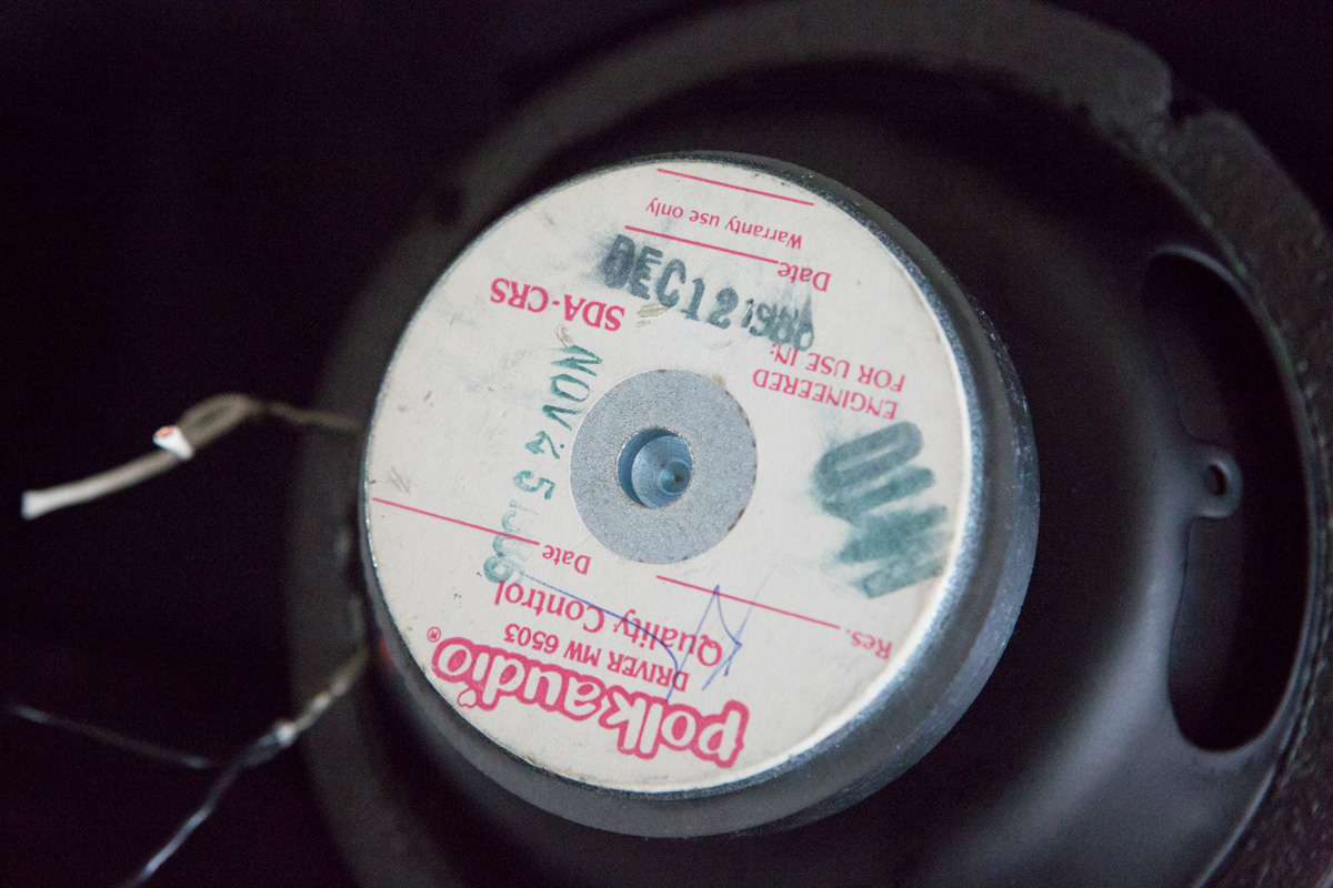

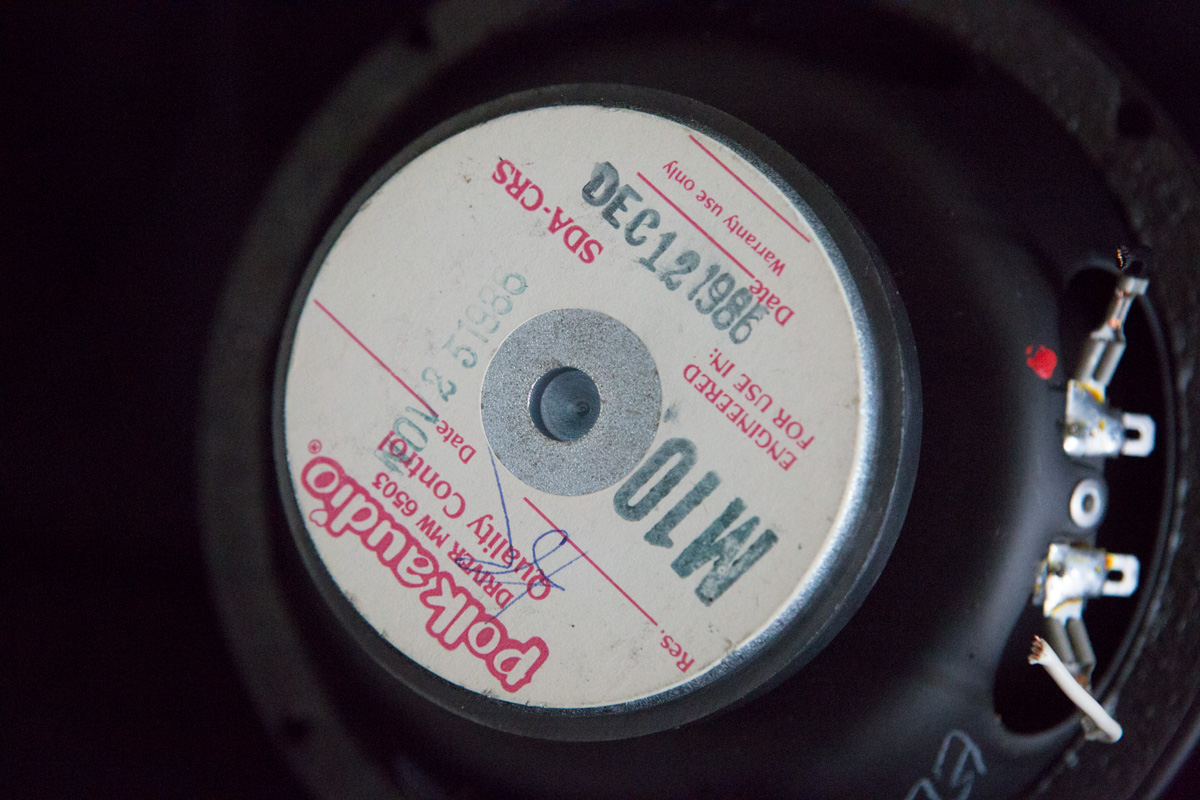

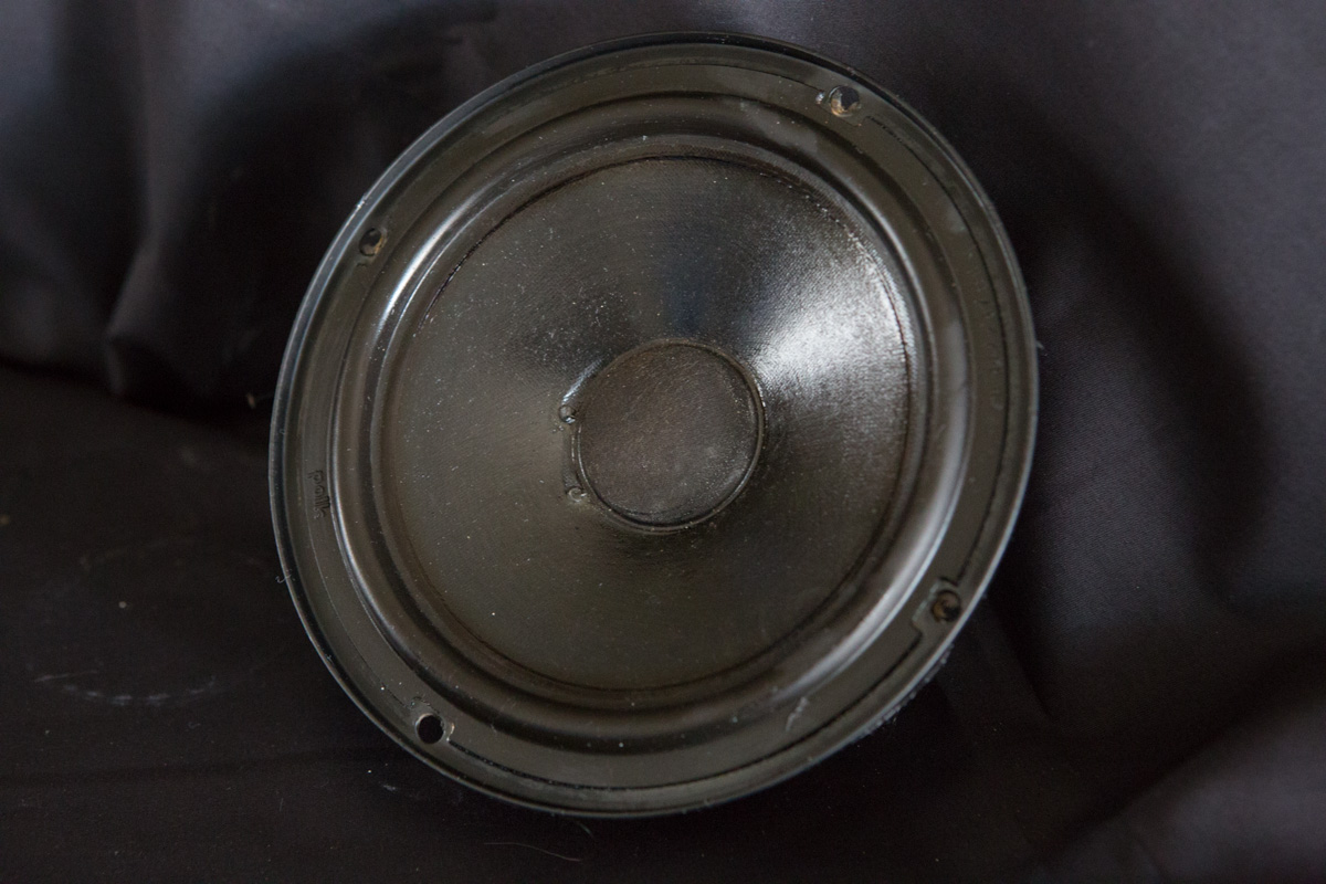

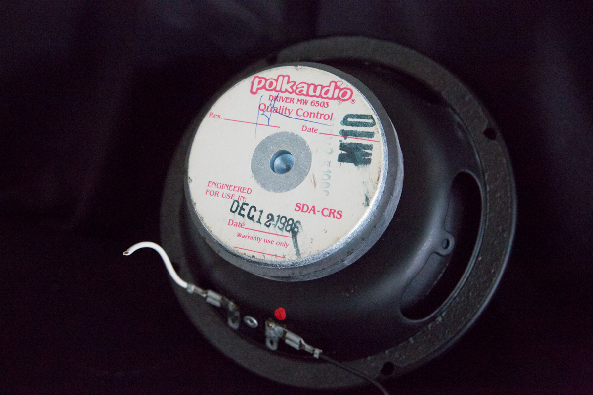

    Thanks for the offer stretchl, I could use a good MW6503. If you look closely on the left driver in the left speaker, you will see that its not perfect. The magnet had shifted and I made a jig and did a repair. The repair went well, but as you can see after cutting the dust-cap and gluing it back, it doesn't look too good..lol. I will send you a pm. Thanks again.
