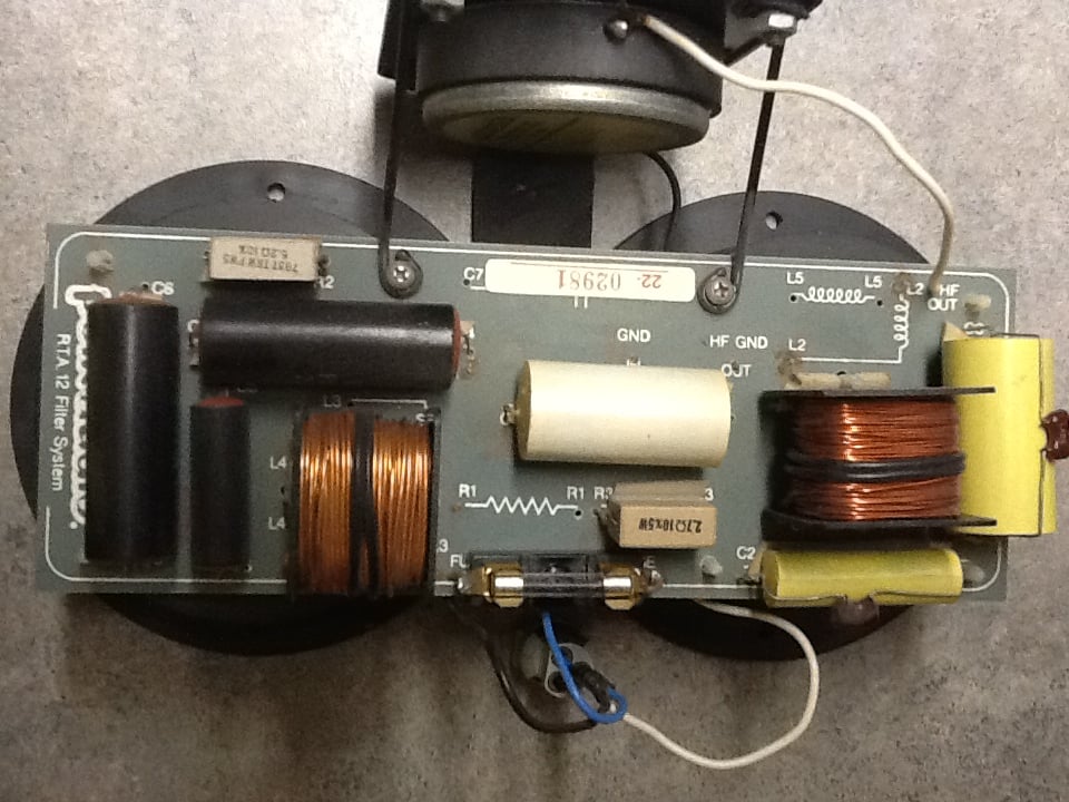

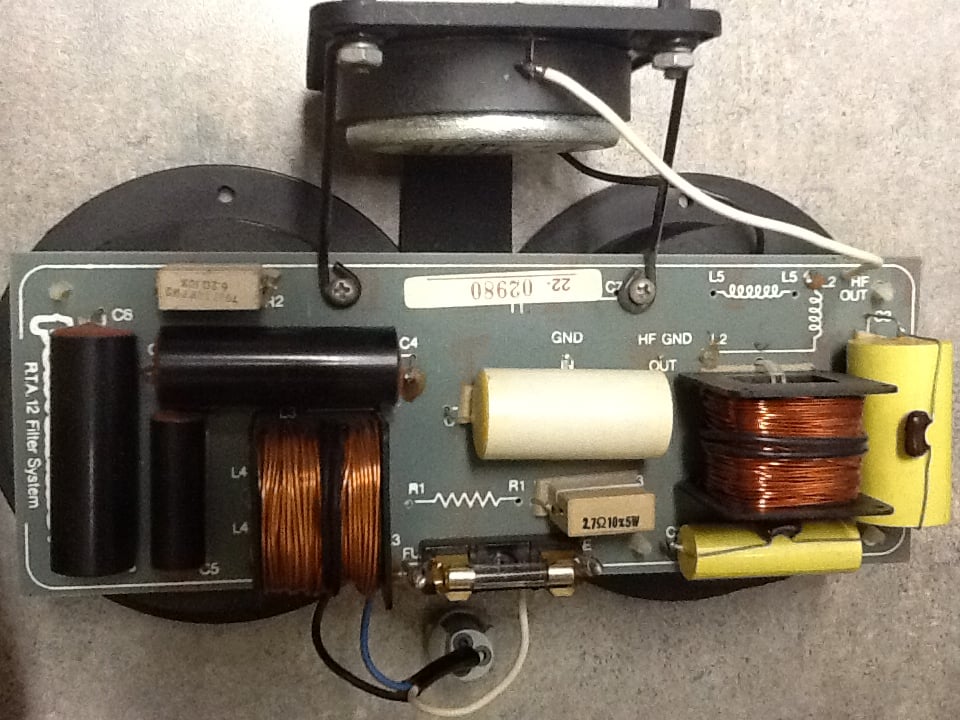

Here are some pictures. I would like to have someone rebuild them because it looks to be a big job for me. The one speaker when the crossover went out, the tweeter is making a little sound but the rest of the speakers are dead. The other speaker is working, but want them to be the same so i want to redo the other crossover as well. Dose any one know what it cost to go though the crossovers??
Thanks for all of the input best place so far for info -
I will fix your crossovers for free, you just cover parts and shipping

For what it is worth I do -all- Polk Audio crossover repairs for just the cost of shipping and parts. They have to be "standard or slightly better parts."
I take care of the Polkies! :]- Not Tom ::::::: Any system can play Diana Krall. Only the best can play Limp Bizkit. -
That is great!! Just tell me the parts i need!!!! Thanks alot VR3, What a stand up guy!!!
And where to get the parts

We are a dealer for 90% of the parts out there!
Best thing to do would be to send the crossovers and see what parts need to be replaced and we can quote from there!
