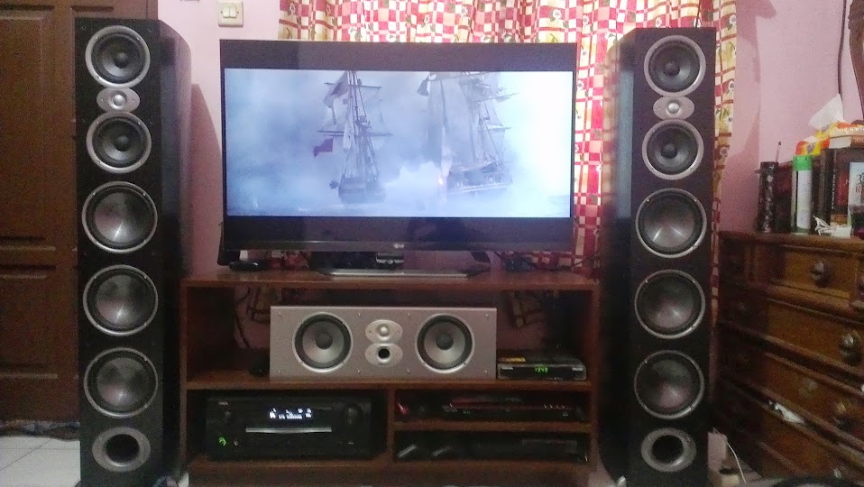

    thanks for the welcome :).. the speaker cable for the surround has just arrived yesterday.. really enjoying the system now...
    GFOviedo wrote: »
    Pictures would be nice. :mrgreen:
    rtia9s featuring master n commander..
    more reading is nice.. too bad many of the brands is not available in here... the store where i purchase the 9s doesn't even know emotiva
    HT.jpg 111.7K

    Those speakers are really close together. They would shine quite a bit if you spread them out and got them away from the walls. That room is probably limiting their performance heavily. Not that it probably sounds good, but rather you can yield quite the improvement with placement.
    yes thanks for the advice, i thought about it as well but i can't move the table next to right speaker since it's the wife territory.. i also couldn't move it forward to stay away from the wall for now.. so have to live with what i got.. will wait until we can enlarge the room maybe sometime next year...

    Frankly I'm flabbergasted to see your AVR operating with so little breathing room. Mine would shut down within a few minutes if it were squeezed into such a confined area. Congrats regardless.
    Class D amps run super cool. My SC-1522-k get look-warm whenever I play music really loud for hours. My Onkyo would get so hot I could fry eggs on it.
    Your Onkyo probably had a few inches of breathing room above it. He's got his in a cubby hole. That's his choice, but I merely wanted to express my shock over the arrangement.

    Anyone else think those A9s are a too close together?
    Indeed they are.
    From experience i can tell you that your goal is for the center of the subs on the speakers to be at minimum 2 feet from the rear wall. More is desirable. The recommended starting position is to have the separation between fronts form a equilateral triangle with the sweet spot of your listening position. The sweet spot being at apex of the triangle. THX specs (if this matters to you) is figured out at i think 10 - 12 feet distance to the front speakers as i recall.
    I have my A9 fronts about 10 feet apart at the moment. So 10 feet from the sweet spot as well.
    Just a heads up, A9's really do dig very deep. A9's set at 40hz on cross overs, and UNPLUGGED, my powered sub on stereo MUSIC, hardly even kicks in. Most of the work is done by the A9's. And they sound killer :) Oh and there are some very notable exceptions to this.
    I already mentioned that, and they are too close to the back wall. His room doesn't facilitate moving them around so that's pretty much it.

    GFOviedo wrote: »
    i think so too :D.. room enlargement is on the upgrade route ;) (not because of the A9s though, but surely the A9s will take nice advantage from it)
    CinderLyon wrote: »
    nice suggestions.. that's why i think that an amp would be a better upgrade since it will increase the overall performance compare to if i get a sub (debatable i know, well i'll get the sub also eventually.. just to make priorities on which to go first)
    all in all.. thanks for the suggestions... surely valuable for getting a better system..
