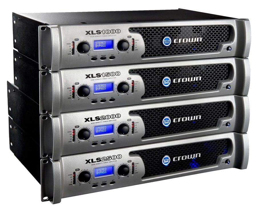

  • emionence1963
    emionence1963 Posts: 32
    edited July 2013
    These will set those SDA's on fire.
    I'm using the 1500 with my SDA2's. Lower noise floor, that the 1000. Phenomenal amp IMO.
    nooshinjohn Posts: 25,928
    edited July 2013
    You will get better performance from an amp intended for home use over one meant for commercial venues.
    F1nut Posts: 51,783
    edited July 2013
    He's pulling our legs John, at least I hope he is.
