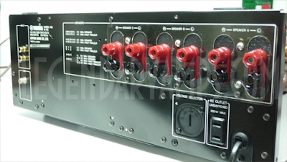

I am looking to replace the old binding posts on my M-65 with some new 5-ways. Could someone point me in the right direction for a good replacement?
Any tips or things I should consider before doing this?

    The problem is, on that amp the plastic binding posts are attached directly to the output board are secured to the back panel via plastic housing that was incorporated into the binding posts itself. So to replace them you must remove the output board completely with the binding posts. Then you have to fabricate a panel preferably out of metal, to accommodate the 6 new pairs of binding post. and attach it just inside the pack panel. Now to wire in the new posts you will have splice into the output leads that originally were soldered to the output board that you can no longer use, unless you fabricate a bracket for it because it too was held in place by the binding posts. But if you pay attention and take notes or mark which leads are what before removal of the output board you can do away with it all together. Good luck

    Or has I suggested before check out www.legendaryamps.com as they specialize in repairing/restoring that line of yamaha amplifiers. There is some pics on that website of the amps with new binding posts that might help shed some light.

    hope this helps
    But why do they use crappy Rat shack connectors?
