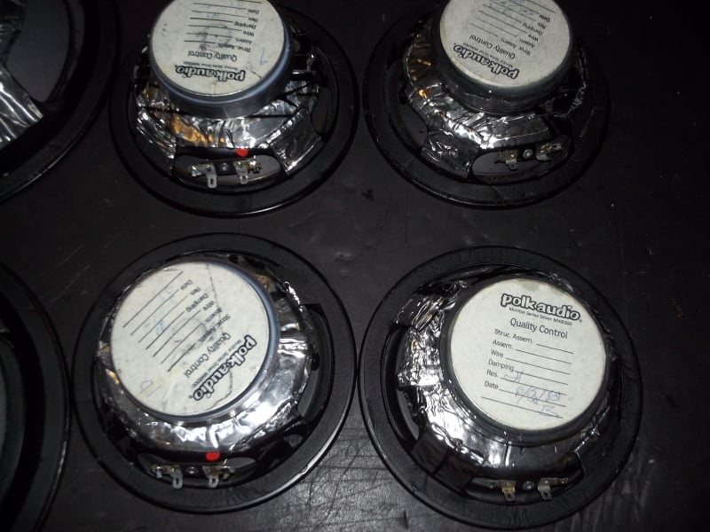

I finally got around the Dynamatting the drivers on my RTA 11ts, turned out pretty good.
Should I do the passive radiators as well? I should have more than enough Dynamat left.
Also, I did not do the magnets. I read that some people suggest it, and others frown upon it. Any insight on why or why not?
Thanks,
Ian

    Yes, do the PR's. The magnets do not ring, so no need to do them.

    No need to Dynamat the magnets, as F1 said above. It is, however, a good idea to secure the magnets with some JB Weld, Loctite, or any other good ceramic/metal adhesive while you have the drivers out of the cabinets. This simple task should make the possibility of any of the magnets shifting - pretty much trashing* the driver - much less likely. There are several threads on this, with pics, available.
    * - the driver can often be repaired after a magnet shift, but the process of doing so is, IMO, a delicate, tedious task that's not worth the time/effort required.

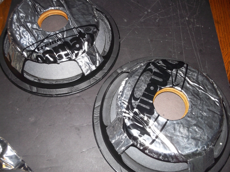

    This is how you dynamat PR's:
    Once you do that and tap the basket, you become a believer in this mod. It applies across the board with the MW's as well.
    F1nut Posts: 51,862
    edited June 2013
    Complete overkill.
