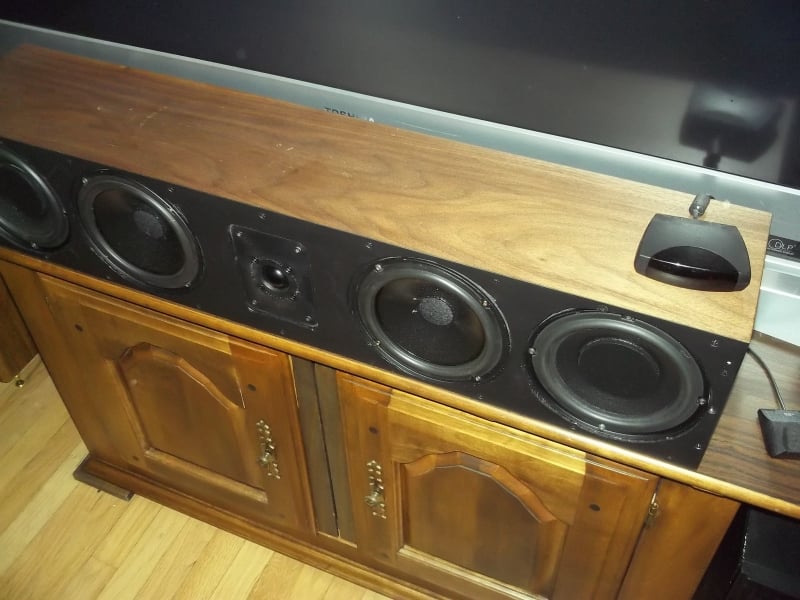

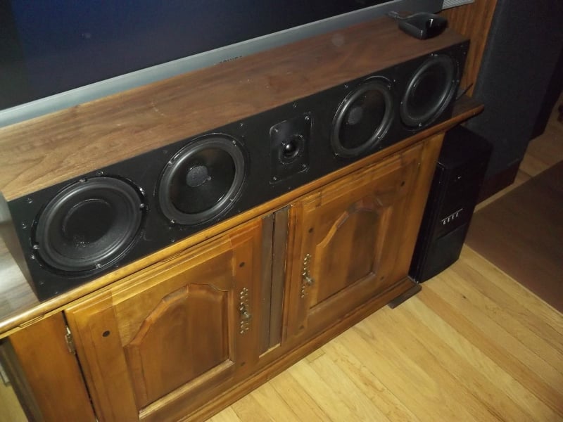

How about a Monitor 10 repurposed in a different enclosure with the MWs on either side of the tweeter, similar to the CsiA6 design?
How about a Monitor 10 repurposed in a different enclosure with the MWs on either side of the tweeter, similar to the CsiA6 design?Home Theater/2 Channel:

I use a Monitor 4 as a center channel for my Monitor 10's (guess you'd love to have my peerless 4's).Yamaha RX-A2050 AVR (5.0.2); LG OLED77C2 4K TV(4) Polk Monitor 10B's w/SoniCaps, Mills, and RDO-194 tweets (R/L F/R)(2) Polk RC80i (Top Middle)Polk CS300 center channelAnalog: B&O TX2 Turntable, Nakamichi Cassette Deck 1Digital: Pioneer CLD-99 Elite LD, Panasonic DMP-UB900 UHD Blu-RayBedroom: Arylic Up2Stream AMPv3 driving Polk Monitor 4's w/peerless tweets
westmassguy wrote: »Exactly what I did
Did you keep the passive radiator or lose it? Any pictures of this anywhere? -
Did you keep the passive radiator or lose it? Any pictures of this anywhere?Home Theater/2 Channel:
dhsspeakerservice.com/ -
I've got a new cabinet in the shop right now, this one's temporary.
so i just picked up a pair of vintage monitor 10a's with the peerless tweeters. And of course they are putting my monitor 50's to shame! But i'm actually seriously thinking of taking the cs1 center channel out of the mix cause frankly i can't hear the need once the 10a's are doing there thing!!! Amazing sound!!! Any thought, is there center channel alive that can compliment these beauties!?..
westmassguy wrote: »I've got a new cabinet in the shop right now, this one's temporary.
Very interesting and impressive looking!
Very cool. Have you thought about locating the passive radiators somewhere other than the front to make the baffle smaller?

westmassguy wrote: »Thanks Mytery, far from finished yet. Matches the timbre of my 2ATLs, which is the main reason for building it.
Looks like all the drivers from two M5's except the tweeter. Since you only use one tweeter do you have a frequency imbalance - more mid-range, less highs? Or did you increase the output of the tweeter with Xover mods?
Sorry to the OP, but had to ask. WMG, this is worthy of a new thread :cool:"Science is suppose to explain observations not dismiss them as impossible" - Norm on AA; 2.3TL's w/sonicaps/mills/jantzen inductors, Gimpod's boards, Lg Solen SDA inductors, RD-0198's, MW's dynamatted, Armaflex speaker gaskets, H-nuts, brass spikes, Cardas CCGR BP's, upgraded IC Cable, Black Hole Damping Sheet strips, interior of cabinets sealed with Loctite Power Grab, AI-1 interface with 1000VA A-L transformer -
drumminman wrote: »Looks like all the drivers from two M5's except the tweeter. Since you only use one tweeter do you have a frequency imbalance - more mid-range, less highs? Or did you increase the output of the tweeter with Xover mods?
Sorry to the OP, but had to ask. WMG, this is worthy of a new thread :cool:Home Theater/2 Channel:
